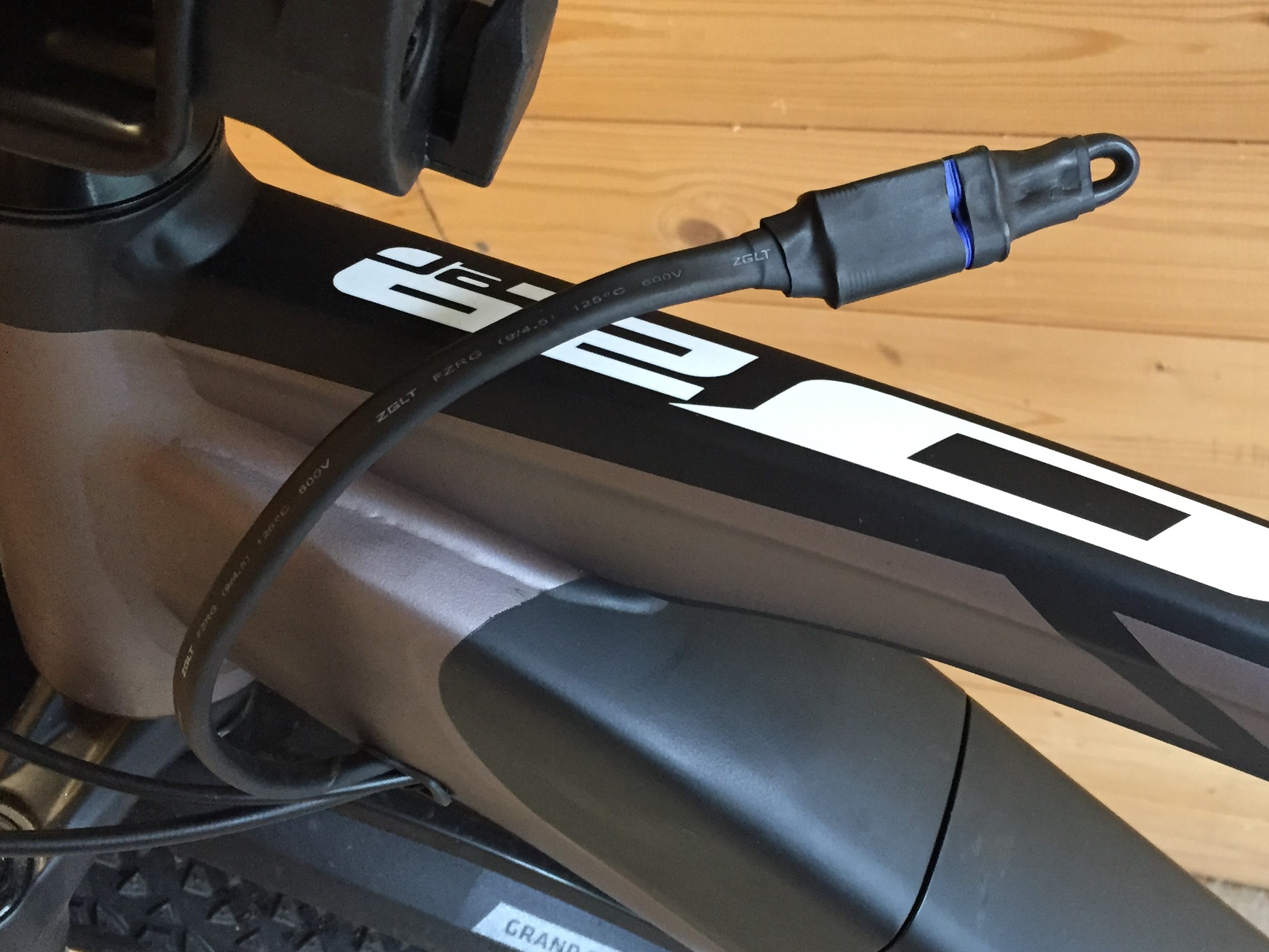

BH Evo 29er owner here. I ended up going the other route, a booster battery connected in serial.
From testing:

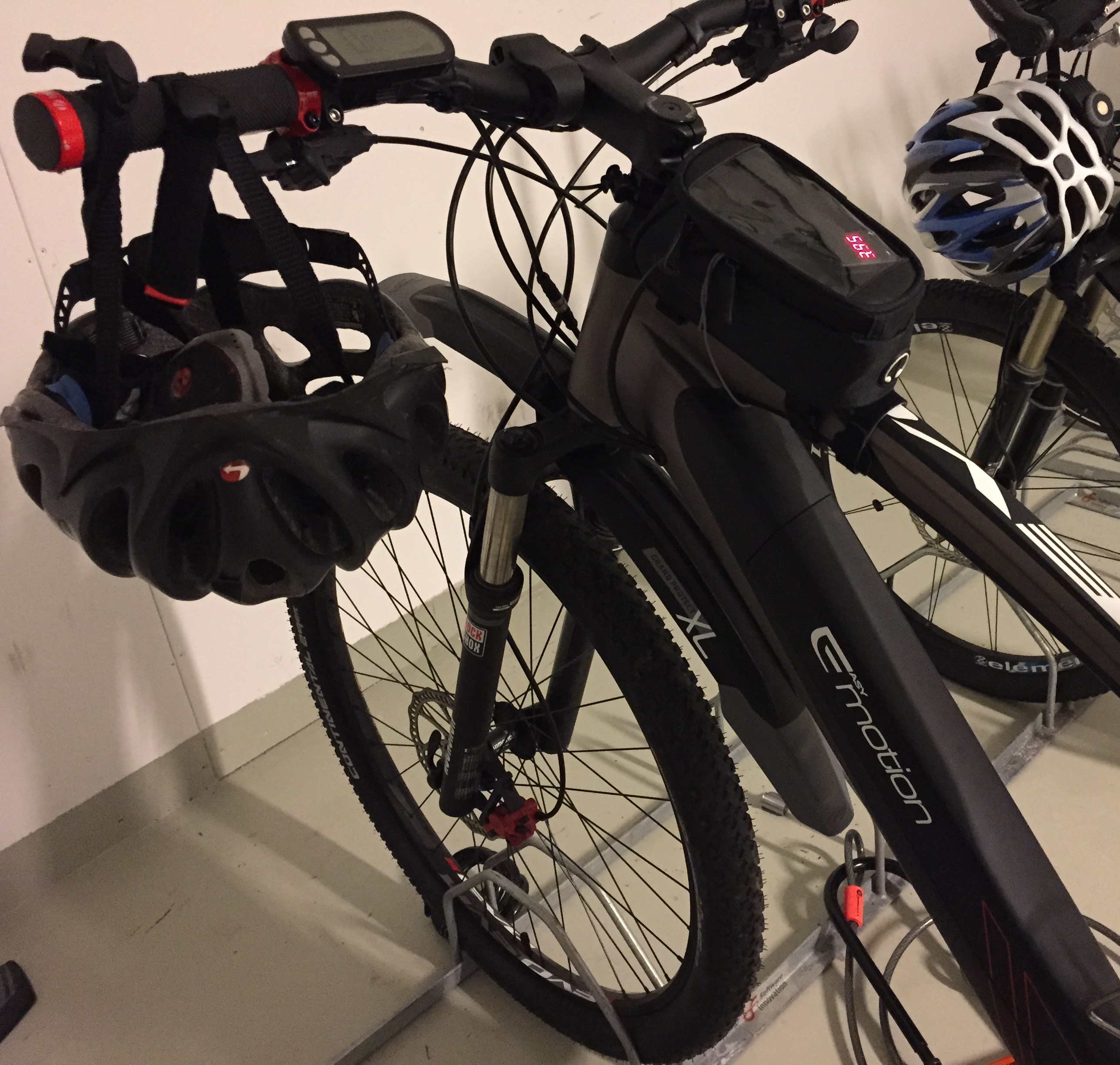

I put it in a frame bag when I use it now:
I am using one of these batteries (2S / 7.4V 12.8Ah):
I've used it for about a year now, no problems so far. Assist works to slightly above 35km/h (22mph).

Hi there, I am in NZ and have a BH Evo Cross. How easy would it be for me to do what you have done to get that bit of extra speed?
I did my mods based on this video:

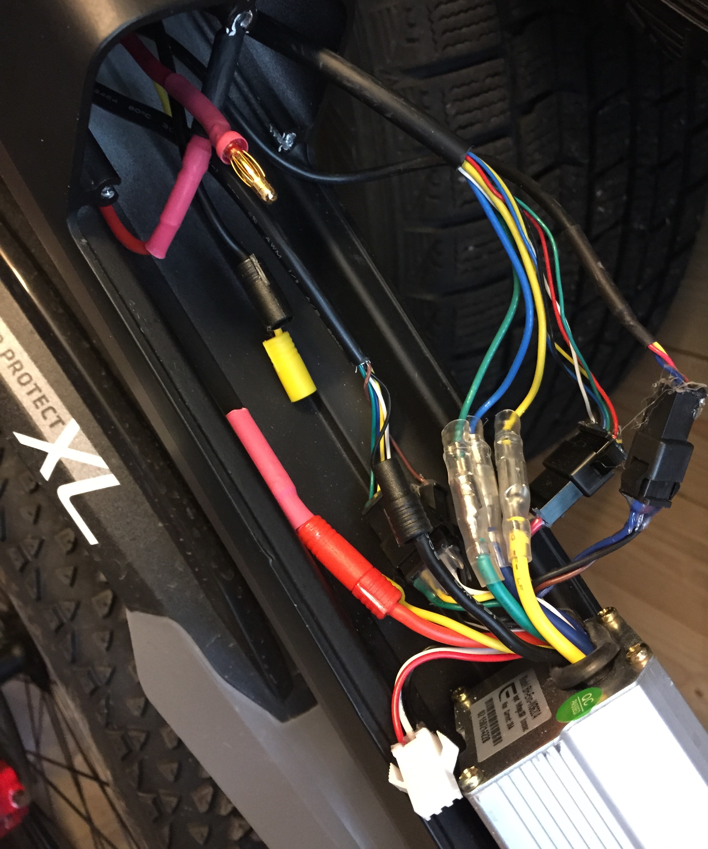

Some images from my bike:

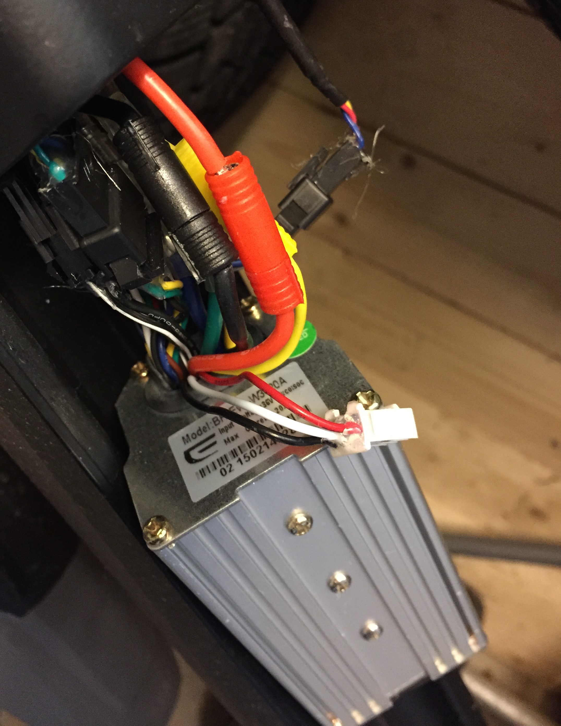

Speed controller, red, black and yellow from the battery:
I cut the red (+), and soldered on connectors to connect my battery in series:

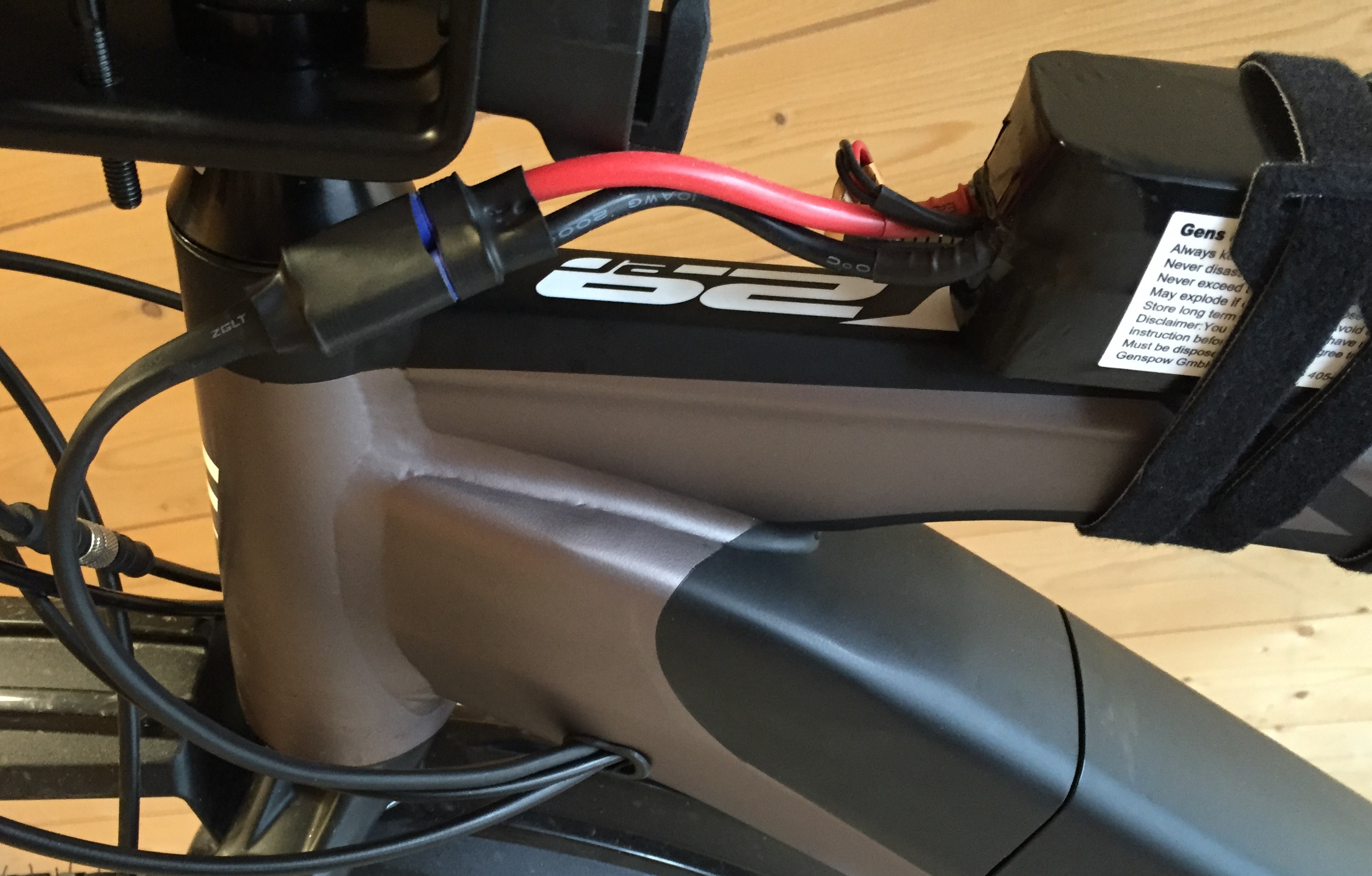

Battery connected:

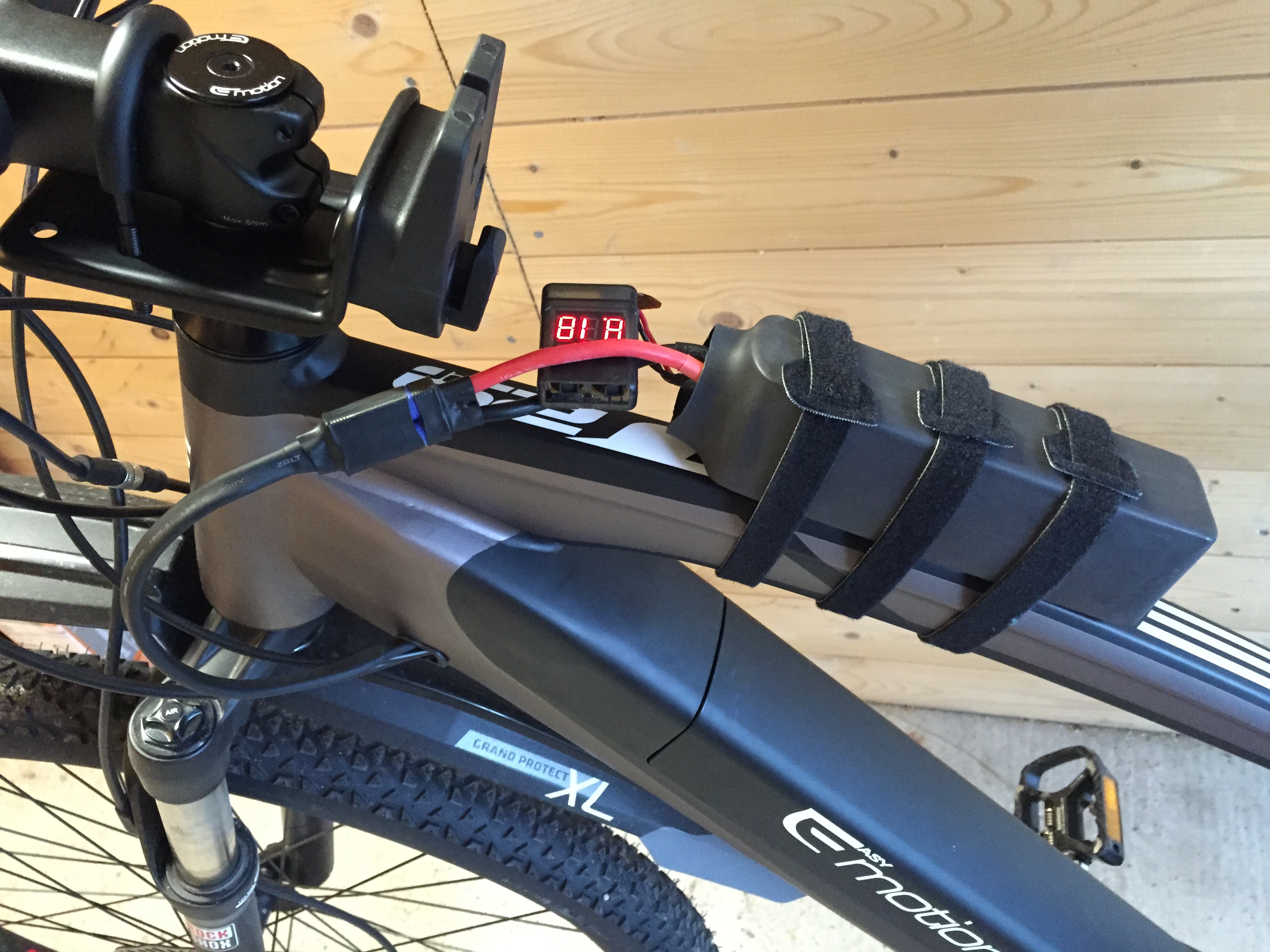

When running without extra battery:

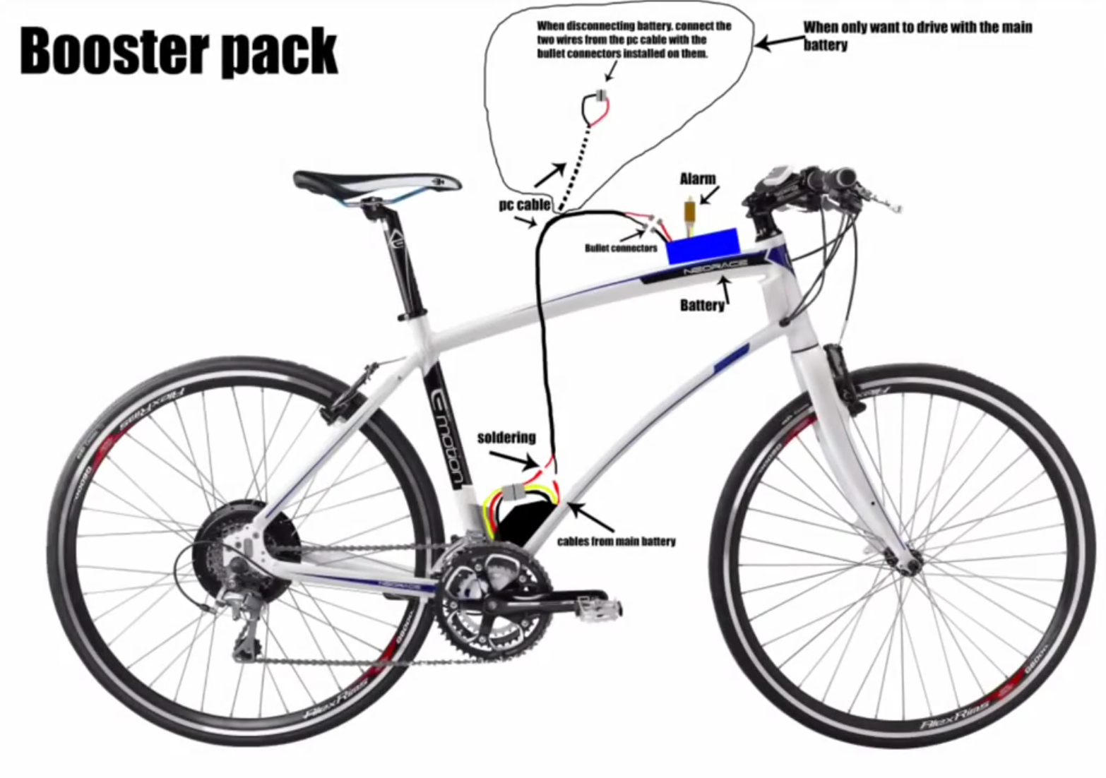

About 6:15 in the video above you can also find this diagram that shows how things are connected:
Source:
http://forums.whirlpool.net.au/archive/2192653#r47152735
Battery connected:
That video was done by @Peter He's posted a lot of really good, detailed information here on EBR, including that same video and some great ride videos as well. If you're interested in some of Peter's other videos, you can see some of those posts here: (Link Removed - No Longer Exists)
