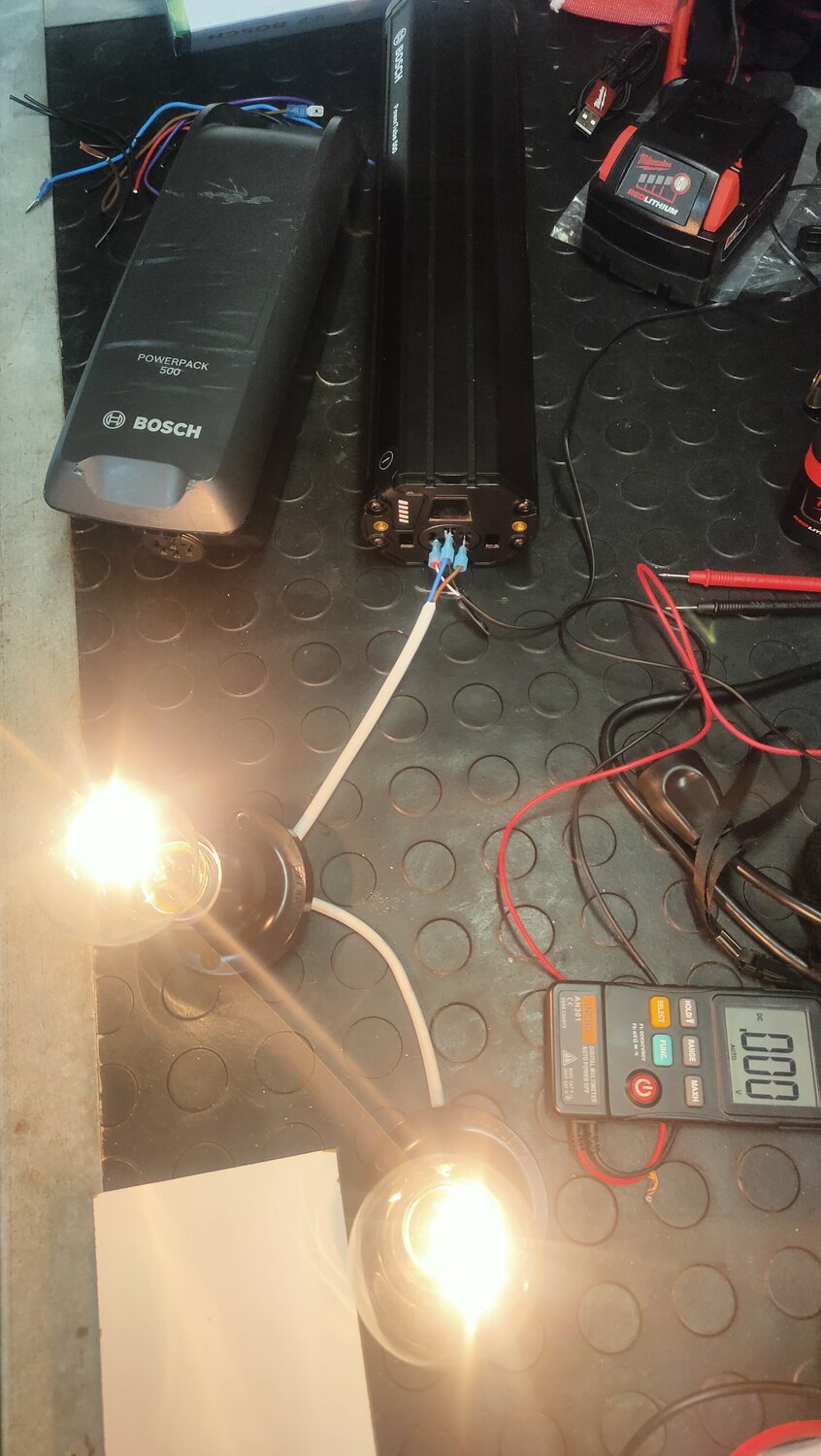

Thanks for info. Currently I have connected 5.04vdc from an old cellphone micro USB charger.
As per now I have connected two 220V bulbs, in parallels, they are probably 100W each (not sure because no label anymore, that's only the incandescent bulbs that I have found at my house)
The battery is discharging with 0.48A on multimeter, so I need to add at least two more bulbs to reach ~1A.
So the experiment is confirmed to be working. Need to make it on a rail and to buy more E27 sockets.

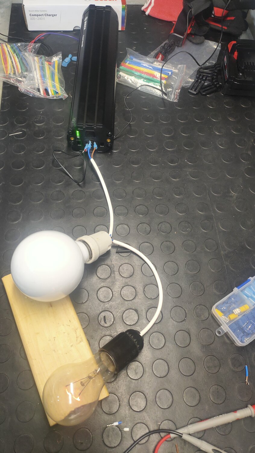

That is my battery discharger prototype:
The white bulb filament is not visible, but another bulb is lightning with very low brightness.

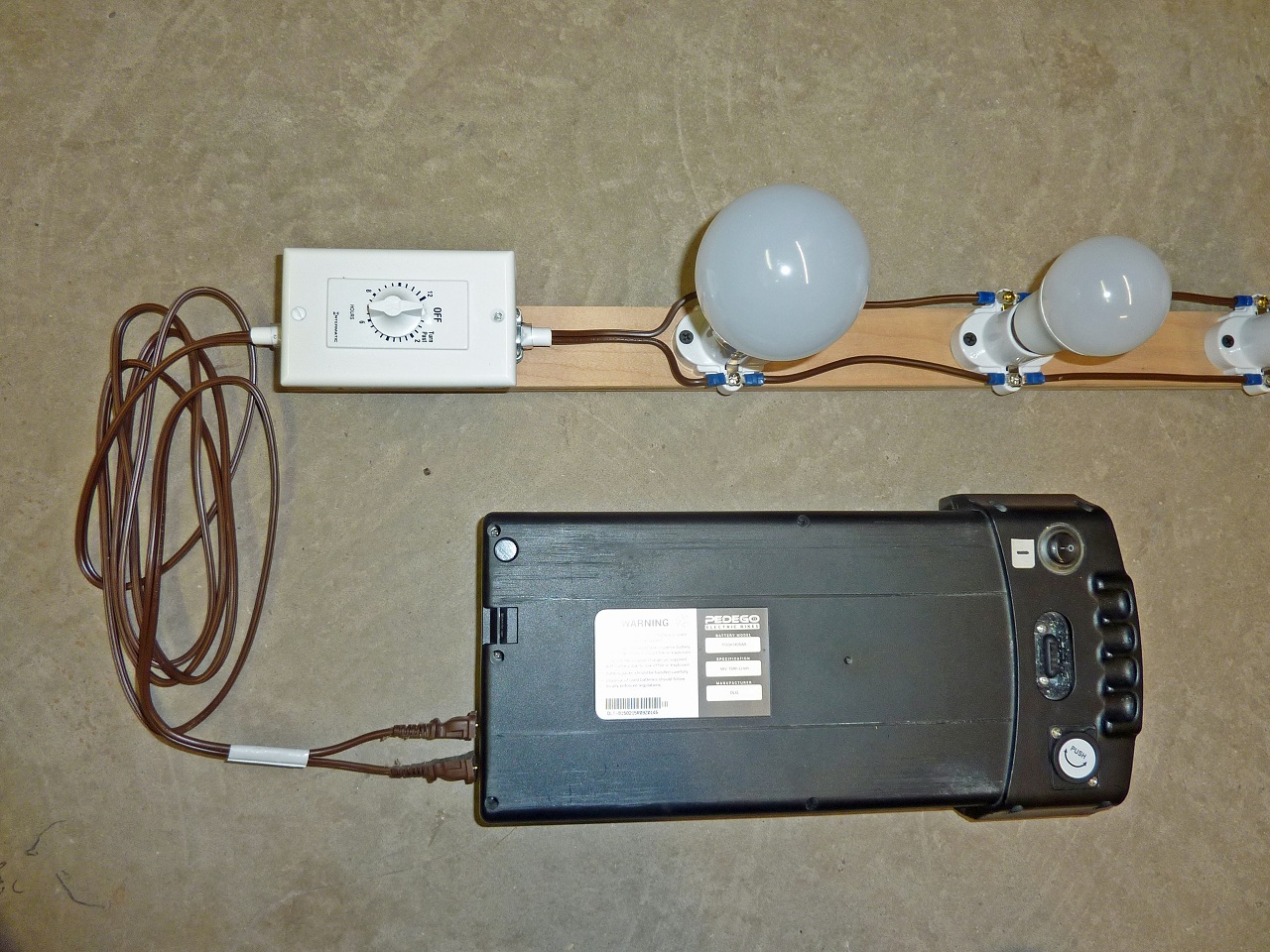

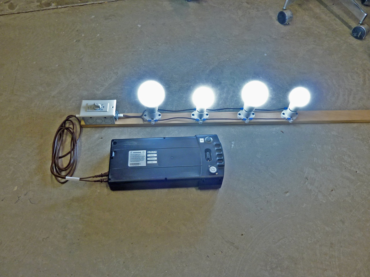

Why not use several bulbs in parallel and add a timer? It may take several hours to get the voltage down to storage level. Is there a reason you need to discharge the battery quickly?
View attachment 114290 View attachment 114291
With 6 bulbs, the total draw is 2A which sometimes takes a few hours to get the charge level I want. More bulbs could be added if necessary but I have no need for a faster discharge rate. Simple math tells me how long to activate the timer so I can set and forget it. I have the bulbs mounted on a wood strip which hangs on a wall for use as a portable light source during our frequent power outages.
For convenience, I added this voltmeter to easily check the charge level:

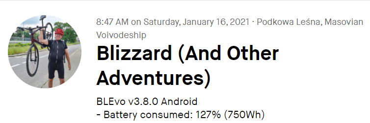

If you think it was not any representation of winter riding, I can remember my "Polish Blizzard Ride" on Vado 5.0 very well.
127% means I had to swap batteries on the ride.
Ride metrics...
Winter? I do think so.
It only
started snowing when I took that video.
