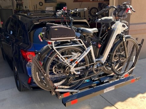

I just ordered two trays for the Quik Rack Mach 2 from QuikrStuff.com based out of Colorado. The rack was invented from the same person that made the 1Up rack. It is a no tools needed to install or remove, just a barrel lock key. My SUV has a 500lbs tongue weight limit for my Radrover and Radcity ebikes. The rack (30lbs) and each tray (22lbs) take a few minutes to install each. The over the tires trays are set to handle up to 5" fat tires and wheelbases up to 56". Each tray can hold a lot for a 2" receiver:
- one tray installed: 120lbs
- two trays installed: 240lbs
- three trays installed: 300lbs
- four trays installed: 180lbs
The made in America rack is expensive and there is a very long waiting period for this rack. It is replacing my +70lbs steel Saris SuperClamp 4 with fat tire trays.

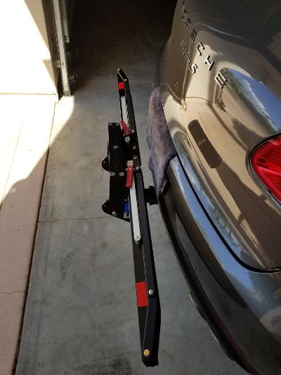

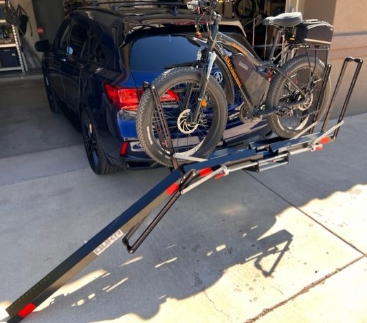

It took exactly 2 months for my Quikrack to arrive. Did a test fit and it was very easy and light enough for my 4'11" wife to attach each platform, use the bike rack, and secure her ebike. I think it is around 28lbs for the folding hitch rack and 22 lbs for the additional folding tray for the 2nd ebike. I put both racks folded up back in the boxes they came in when not in use in the corner of the garage (both takes up the same space as a large storage container).
2016 Radrover +75lbs with all gear, 2023 Radcity Step-Thru +70lbs, and Quick ramp attached on the end of 2nd tray.
Shweet!!
This is the ONLY rack other than my 1UPUSA that I would recommend. Quickr appears to be VERY similar. Enjoy your peace of mind!!
