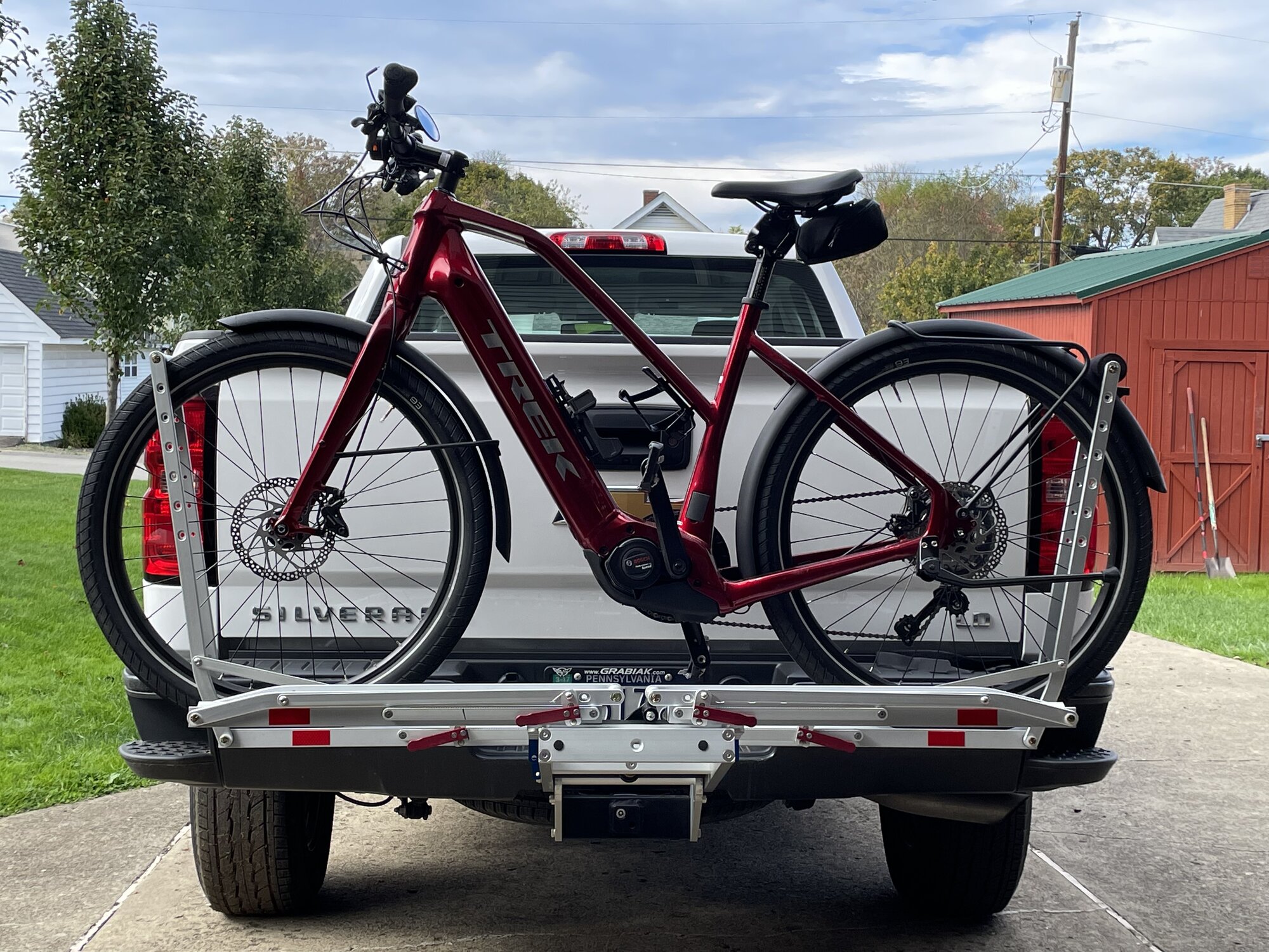

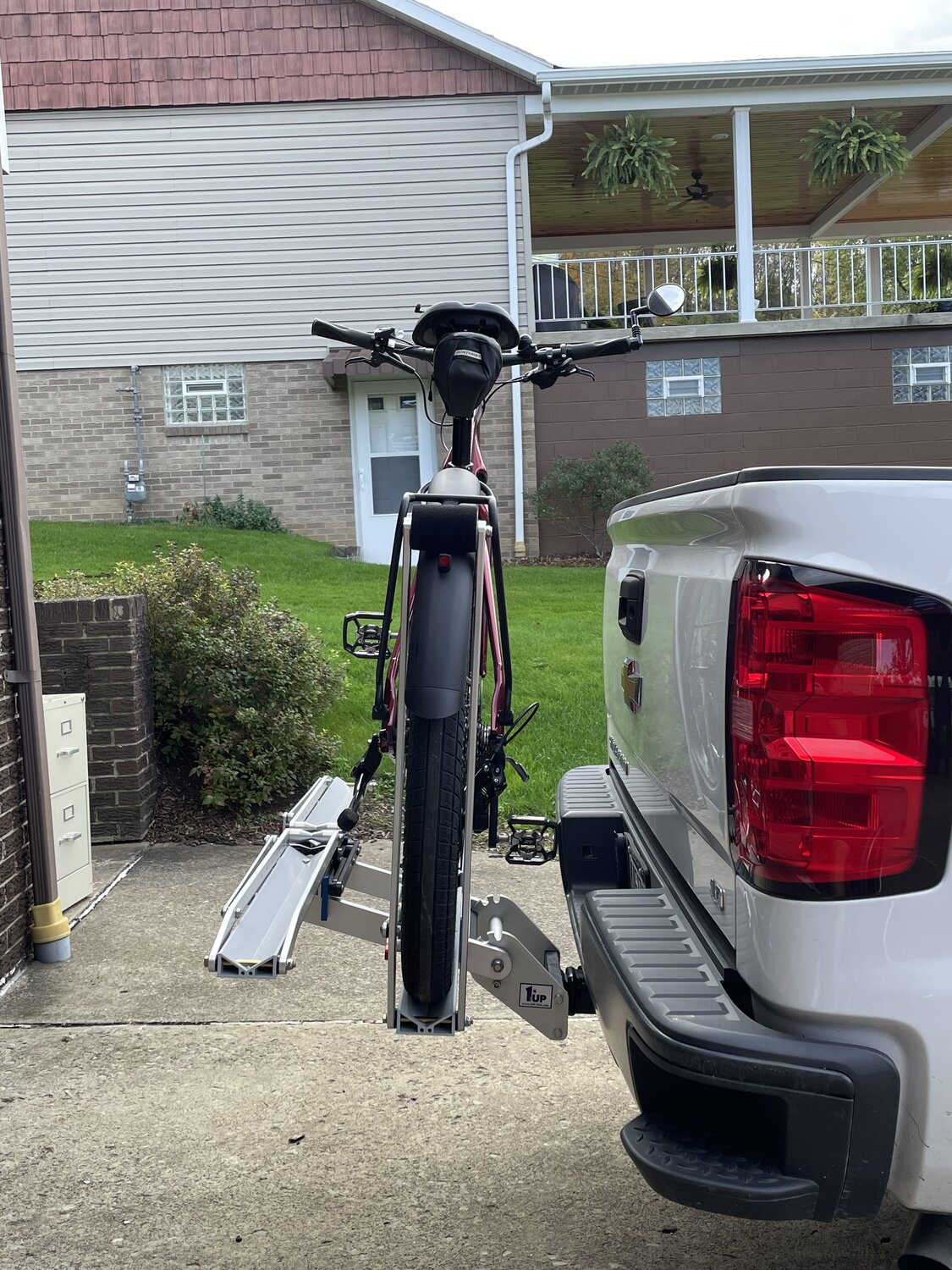

I struggled with finding a rack to transport our bikes with fenders.
Here is what I hope is the answer for me.
It’s a 1UP Super Duty Double.

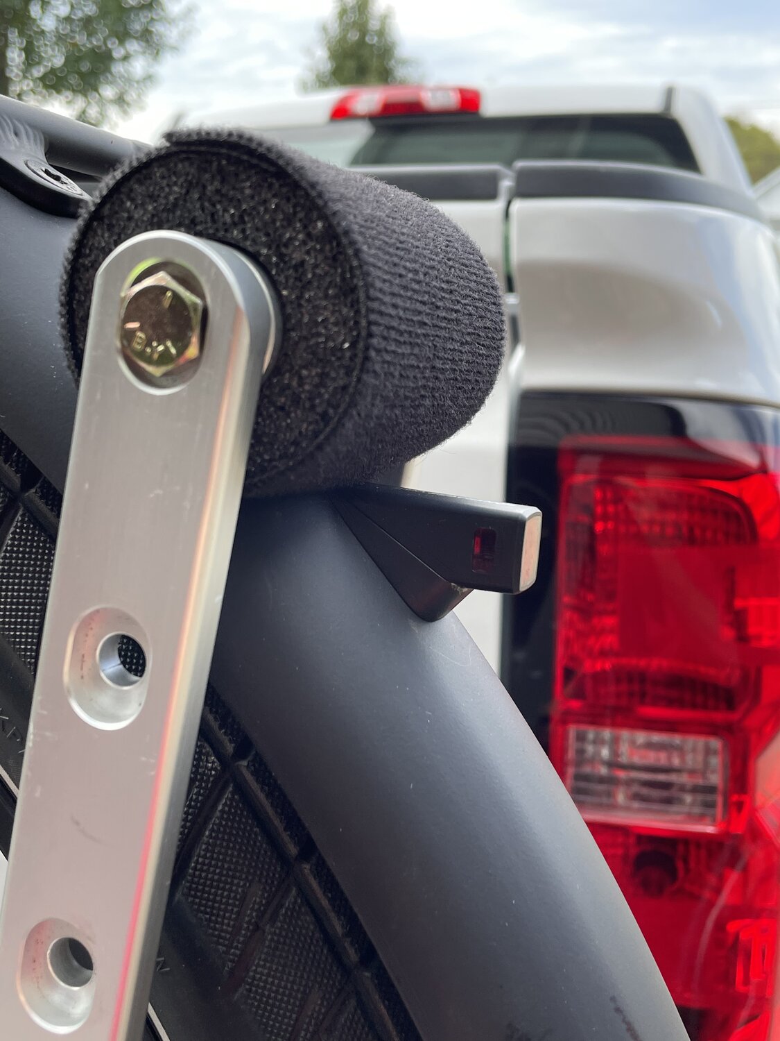

Although 1UP says I don’t need it, I may still Velcro the rear tire just so a bounce doesn’t impact the light on the fender.

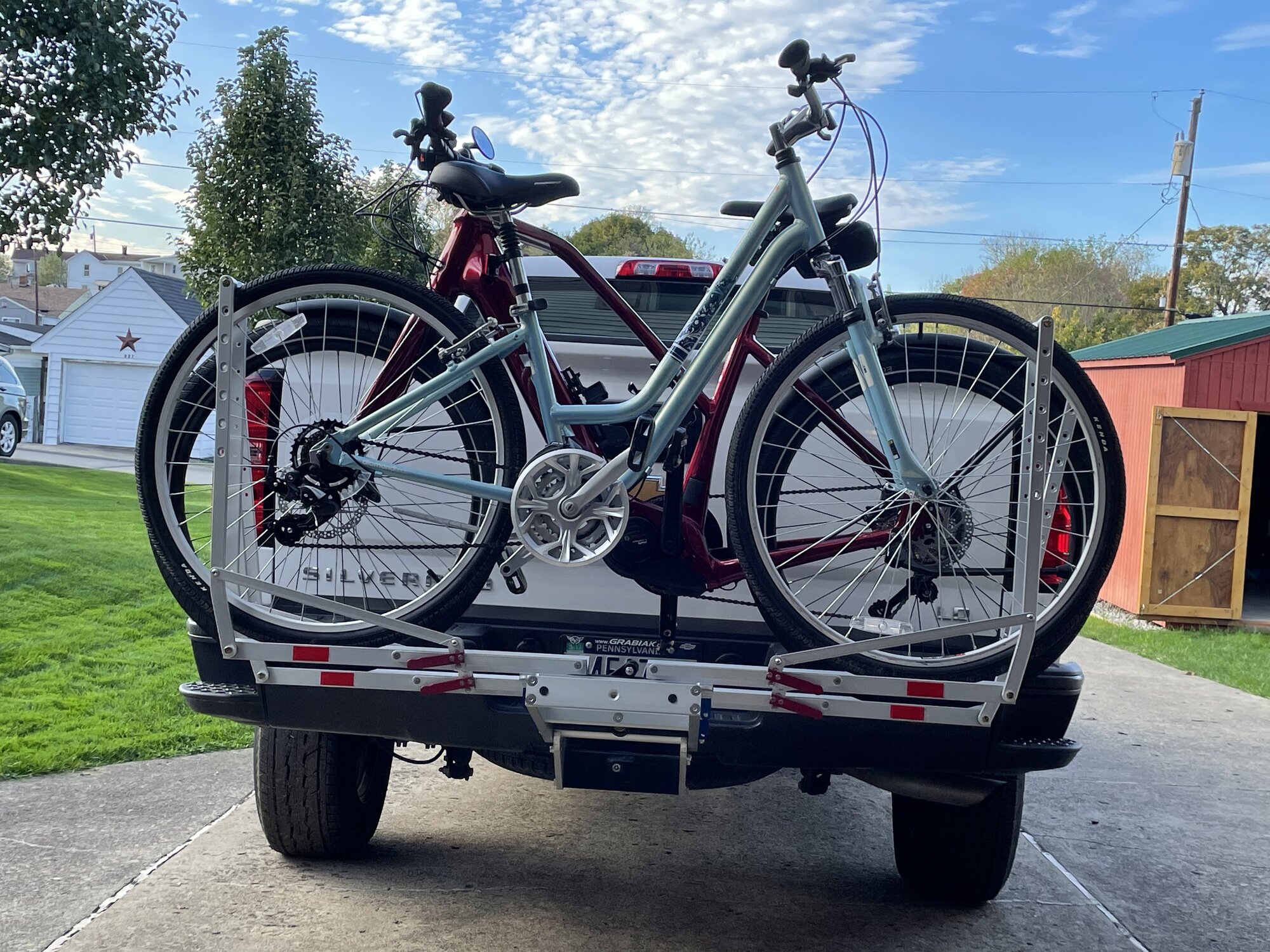

And here it is with my wife’s bike. Both are solid.

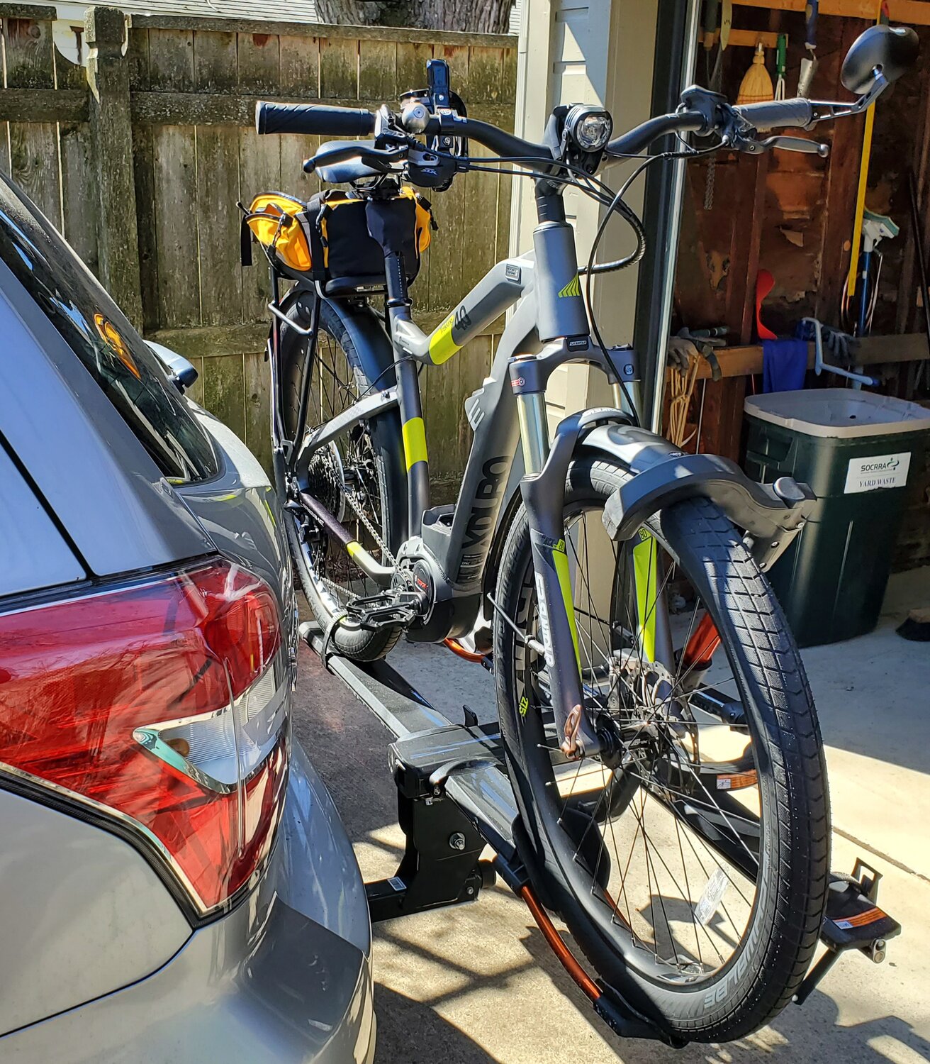

Kuat also works great with my Allant+ 7s. Clamp just in front of front fender. Very secure.
Also a tip for suspended front forks: lock the pistons to ensure a consistent clamp.
The clamps on Kuat racks don't need a lot of downward pressure. The weight of the bike itself holds the bike in the rack. The clamp adds stability, especially side to side. No need to take off the fender!

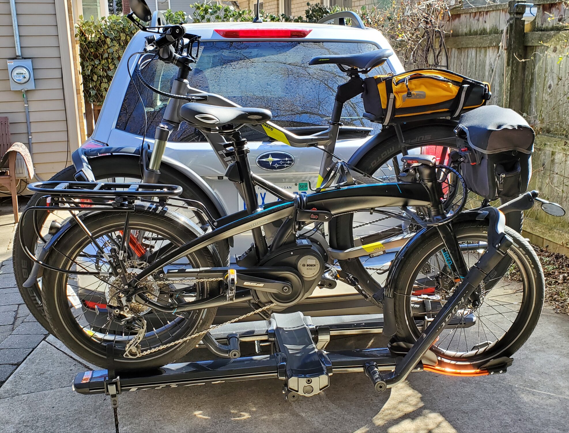

Yes, Kuat NV 2.0 works great for all of my bikes (well maybe exception is Tern GSD Gen 2) - and all of my bikes have fenders. The rear tire is secured with a ratcheting strap and not with clamp arms. The front tire is secured with a clamp arm but the front fenders are short enough on most bikes such that there is plenty of tire available for the clamp. And this includes my Allant 9.9s which I transport with great frequency on the Kuat. This spring, I'm upgrading to the Kuat Piston Pro for better salt & corrosion protection and the higher per bike weight limit. The primary reason my Tern GSD Gen 2 isn't a great fit on the Kuat is the long wheel base. Secondarily, it exceeds the per bike weight limit of the NV 2.0 by 10 lbs or so. Nevertheless, I transport it small distances using a racheting strap secured inside my Subaru to take some of the weight off of the rack tray. I'm looking forward to upgrading to the Piston Pro. Anyone want to buy a 3 year old NV 2.0 (have it on a 2" hitch presently)? If I recall correctly, the Piston Pro will have the option of a clamp arm made specifically for bikes with fenders. Fenders are addressed at about the 1 minute mark of this video for the new Piston Pro:

My uat rack works fine with our two Trek Allants, fenders and all. There's a mistaken impression that the front wheel hook on the Kuat can damage fenders. I suppose it could if the fender is very flimsy, but consider that the downward force of the hook is minimal. It's purpose is to control side to side sway. If you're concerned about bouncing the front wheel out of the tray, use a second strap on the wheel, like you already do for the rear wheel.

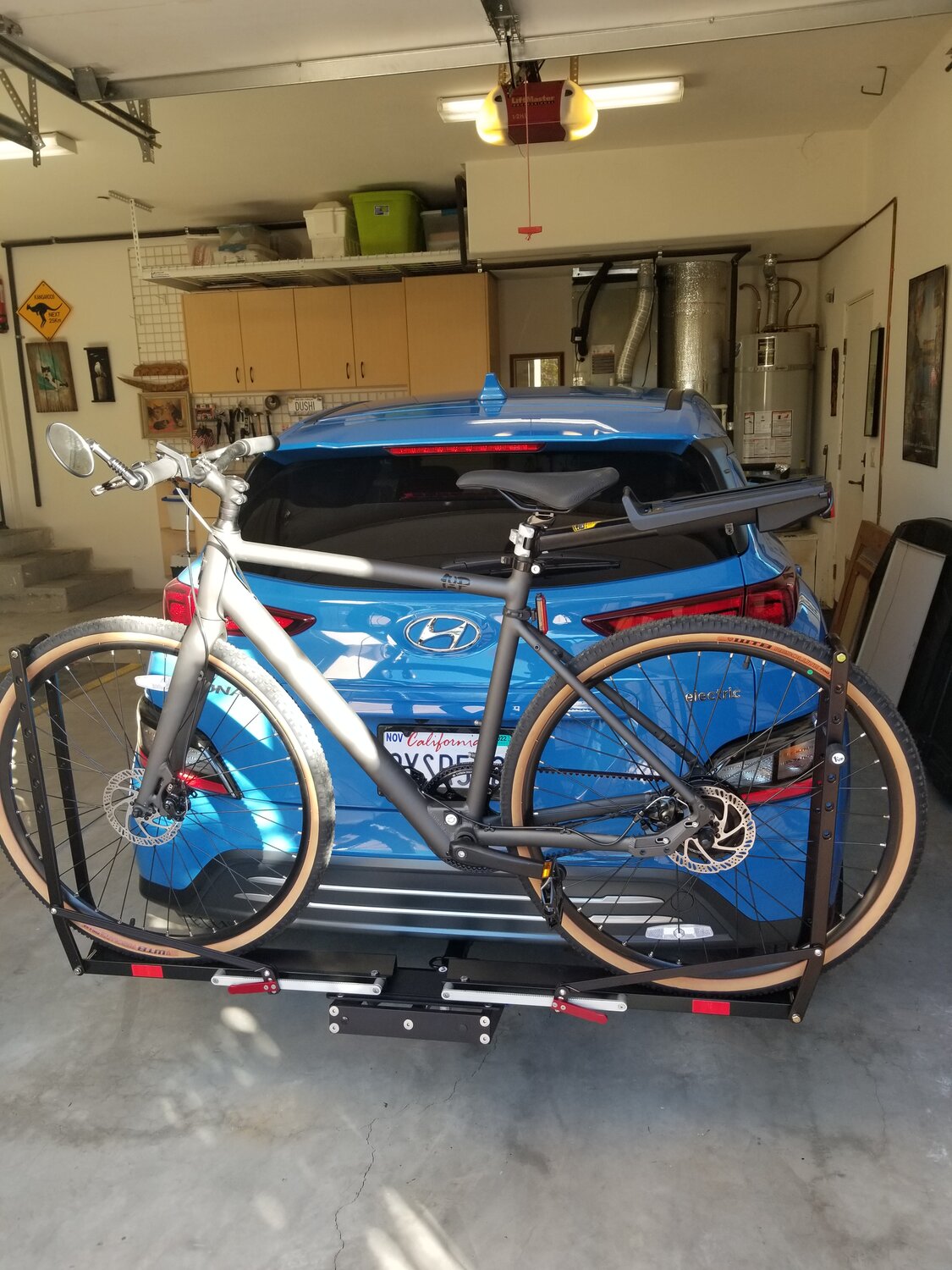

The new Hyundai Kona EV met the 1.25 1 Up rack this morning for a trip to the LBS for my Ride 1 Up Gravelster! The guys at Uhaul did a nice job installing the hitch and the rack went on smooth as silk. Now lets let the LBS get me back together. Seems my front wheel is out of true and the front brakes rub. Might even have them add some Slime.
