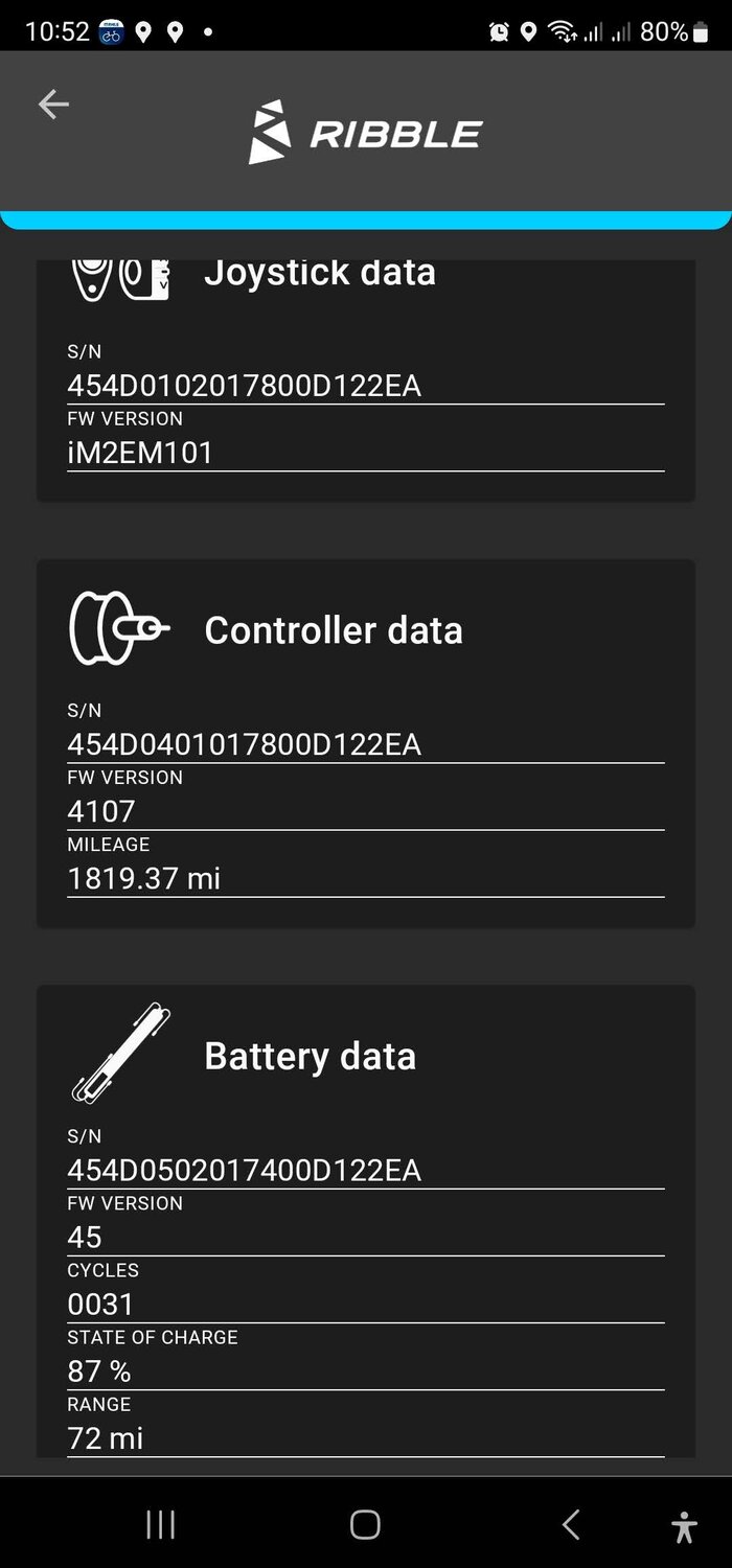

Can anyone here make head or tail of the Mahle firmware numbering? On the website the latest version is Q3.2 (19.9.22) but this number seems to have little relationship to the firmware versions listed on the app. Mine is as in the attached photo. Can anyone having the Q3.2 version installed please post what the details look like in the app.

I ran the update on my Ribble CGR-ALe and in a couple minutes the firmwares had been updated, from the My Smartbike app the Joystick controller is now iM2EM126 (was iM2EM101), the battery controller is now 51 (was 45) and the iWOC controller stayed the same at 4701 (that's supposed to happen according to Mahle). The Pulsar One now seems to work correctly. Success!
