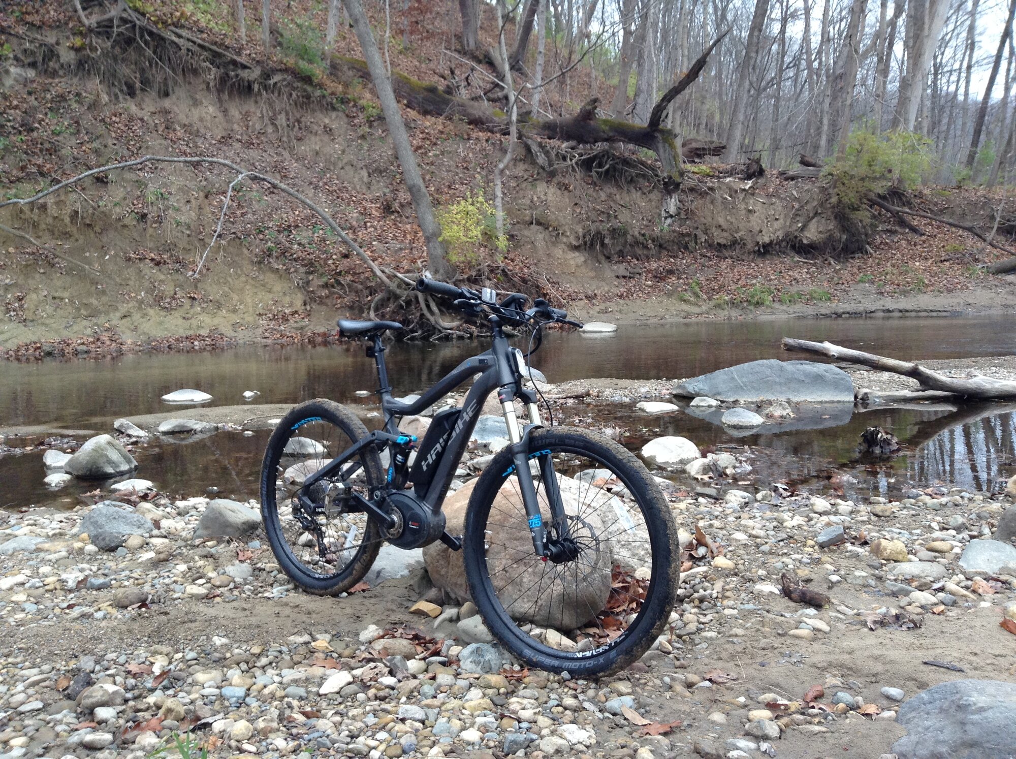

Freesky Alaska has never even stood near an e-MTB 😊

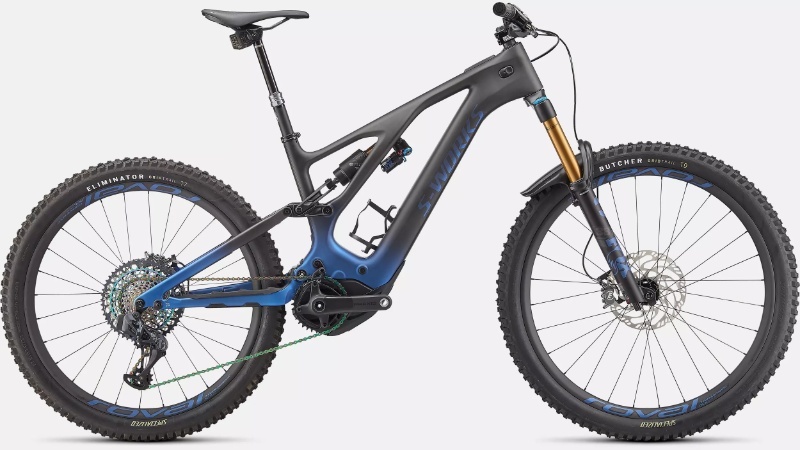

Can anyone see the difference? An E-MTB is in the 50 lb range, has a mid-drive motor from a respected brand, mountain gearing and certainly does not cost $1,300 😊
Hey, Stefan! Go easy on the new guy, huh? I know you don't mean it, but just suggesting he didn't pay enough money and doesn't have a name brand bike may not be the best way to help him out just at this particular moment! Note that Bama did not claim his bike was an eMTB, only that it was listed as one.
Having said that? Stefan does kind of have a point-- not so much about the money or the name brand, but about taking a 90-pound bike up steep hills. It probably is prudent to sound a note of caution here. If he's got experience with motorcycles, and is younger, maybe it makes sense for him to keep trying with the bike he has, learn what trails he's likely to be riding and what his approach to the sport is going to be, and then decide whether he wants to get a second bike.

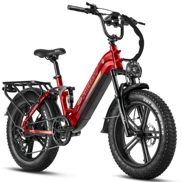

Stefan, if you are going to bust on me, at least use the right picture. That is not the Alaska, that is their commuter bike. 😀😀😀.
