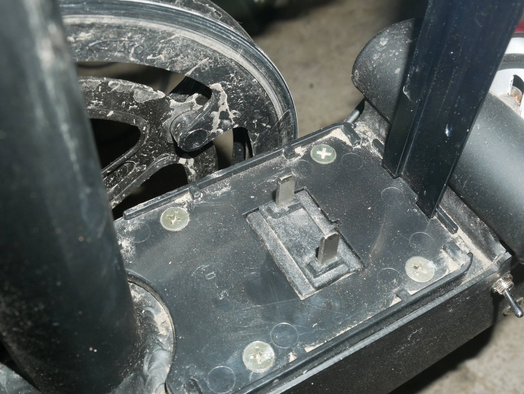

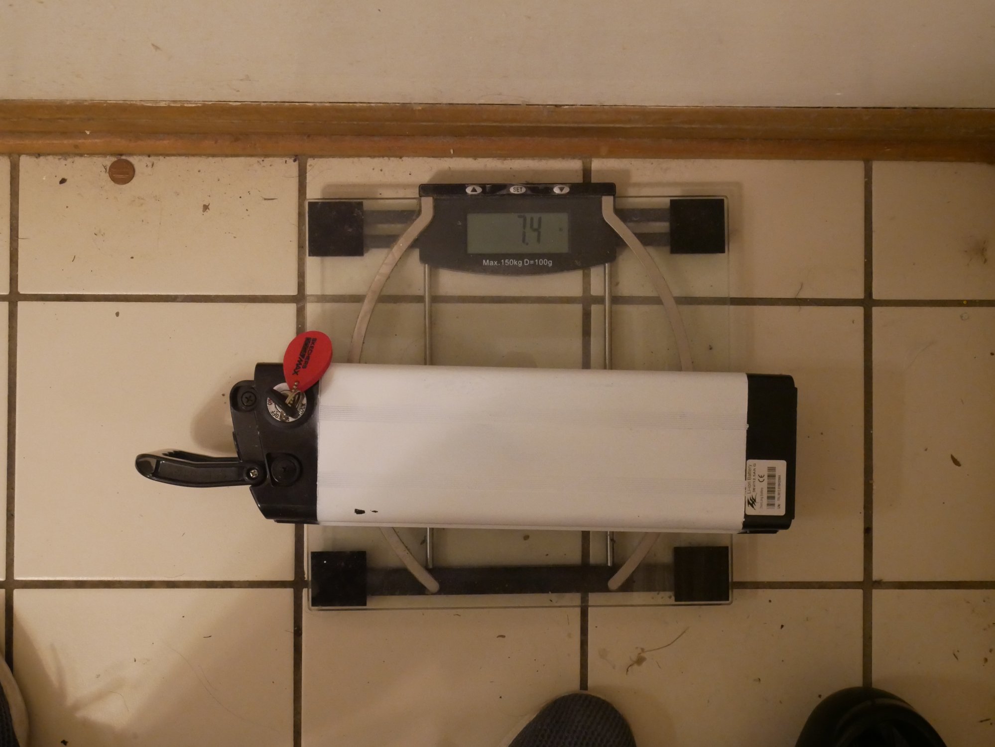

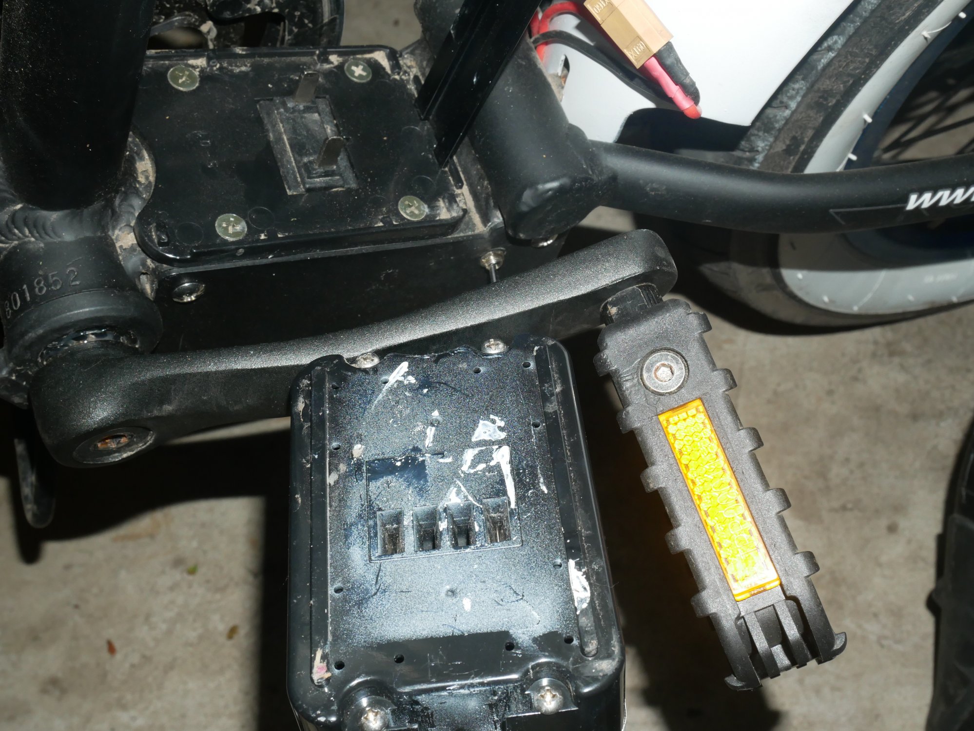

You have the the silverfish pack with bottom contacts? I own one with four slots but only two contacts.
42592 42593 42594
There's a version with side discharge contacts that has three terminal, but only two are used.I will assume you have the first type. Cannot tell from the little oics on the web of your ebike.
42595
Anyway, you said the battery from the second bike works on both bikes? The battery where you bent the prongs doesn't work in either bike.
You verified with a meter that you're getting 36 volts on the same two prongs on both batteries? Can you look on the other side of the connector? On my bike, with the bottom discharge, they put the controller in a compartment under the two pronged connector. Can you look on your bike to see where the prongs go, and which one correspond to the red/black power leads going to the controller?
Is it possible you flipped the connector around when you took it off the battery? I hope not.

Hi I can't thank you enough,I checked it weeks ago but I must of had one upside down on the table
I can't believe I done something so stupid,yes they were around the wrong way.I'm going to say I work all day and I'm old and everything seems
