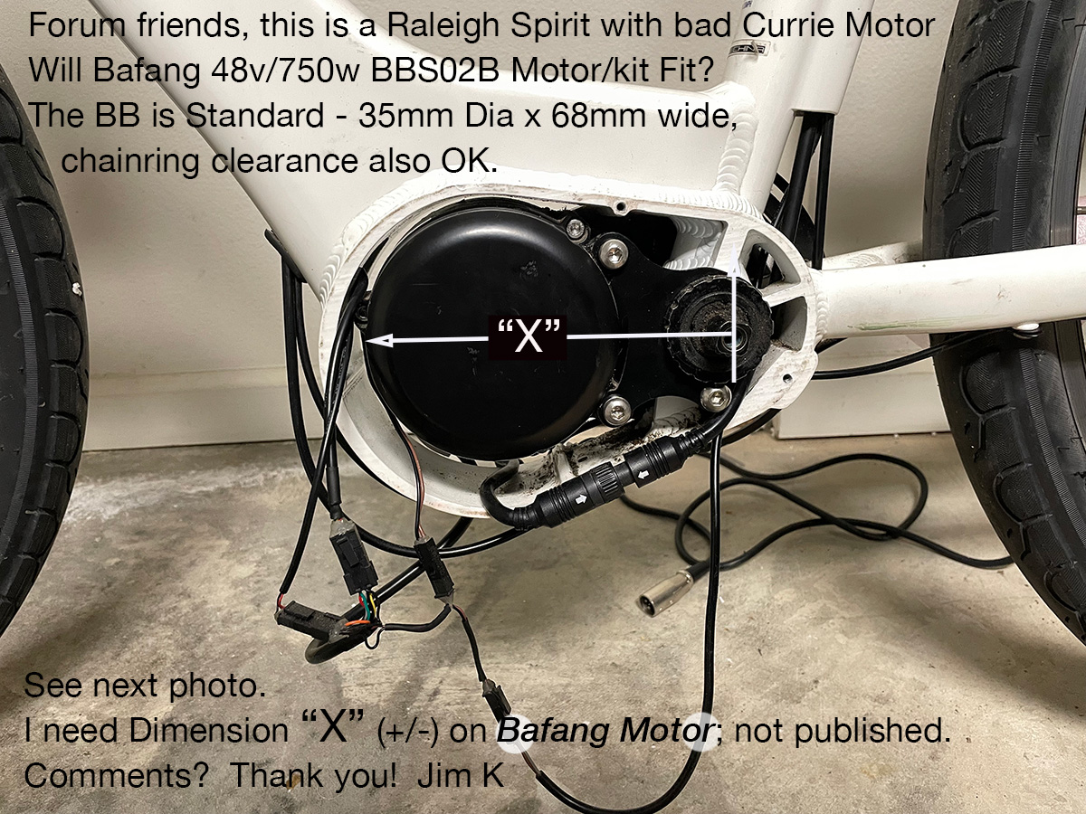

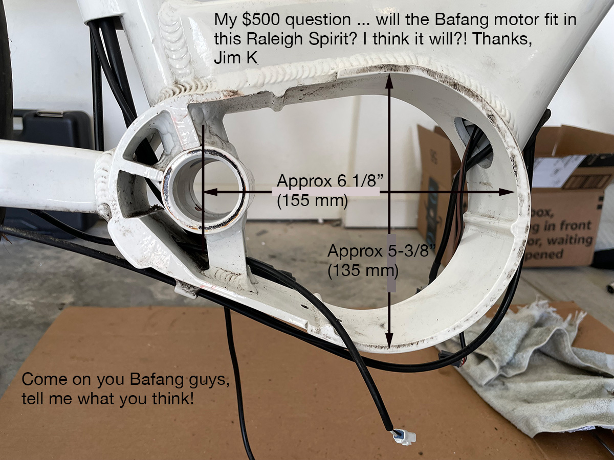

Bafang people ... please look at my drawings. Will Bafang motor fit in this Raleigh with bad Currie motor? Need at least one measurement ... or maybe a smart person just knows! Thanks much! JimK

This is a BBS01 that has the same shell. taking into account the extra length you need to accommodate the bolts that connect the controller to the motor shell, X should be roughly 145mm

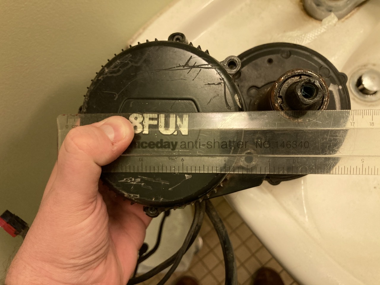

Hard to be accurate with the motor installed... But my BBS02B circa 2020
X = 150mm
Motor, top to bottom = 126mm
If I were you, I would try contacting a few sellers who can measure a current motor in hand.
