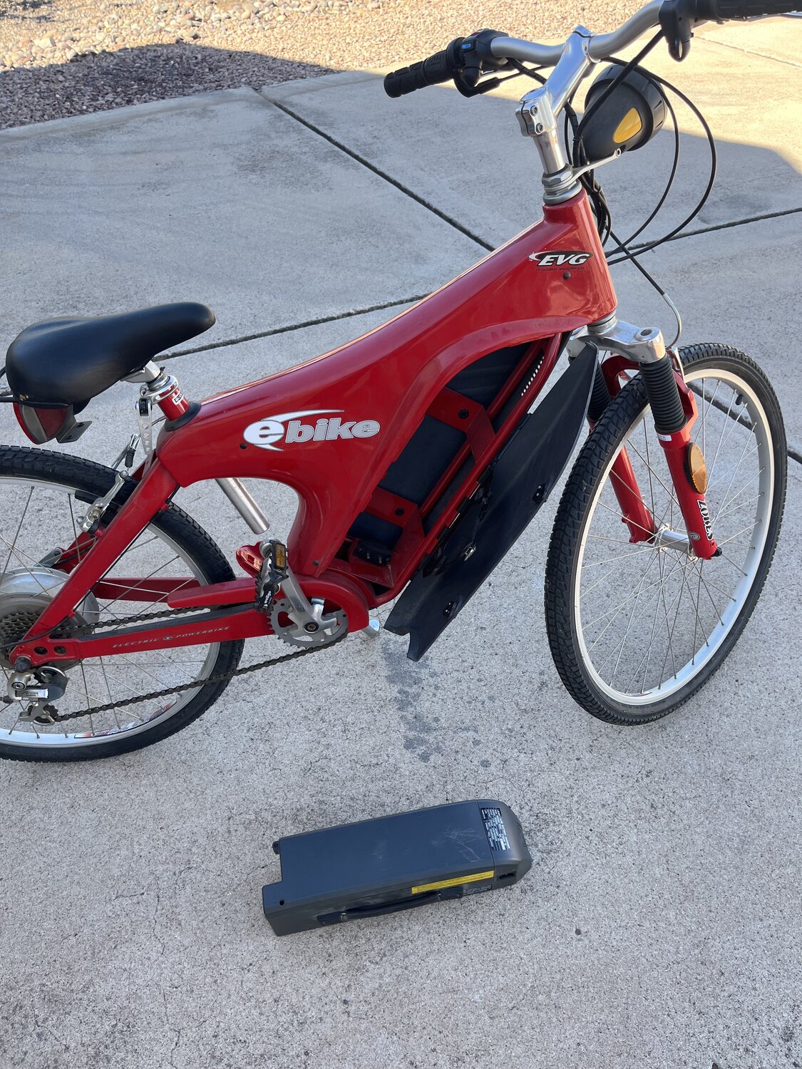

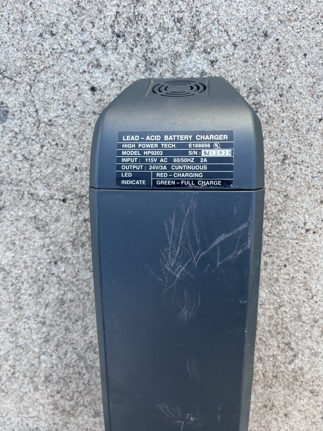

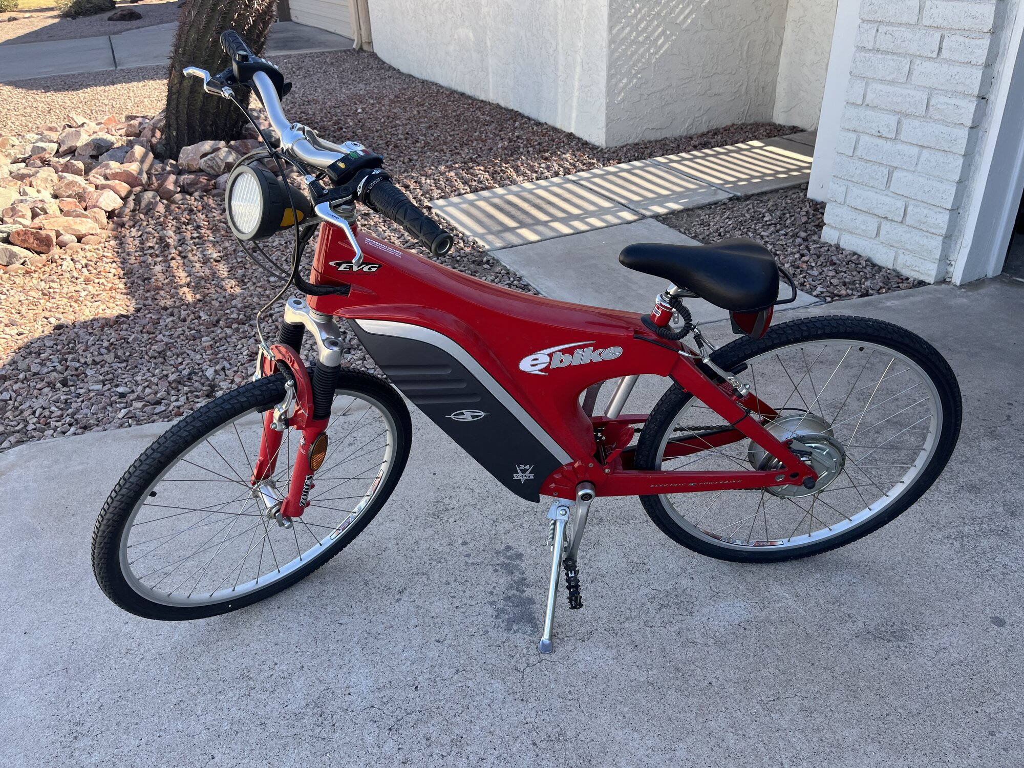

pics attached. don’t see a model # on it anywhere. think it’s just a ’EVG 24v ebike’. the battery pack does have a model# and serial#.

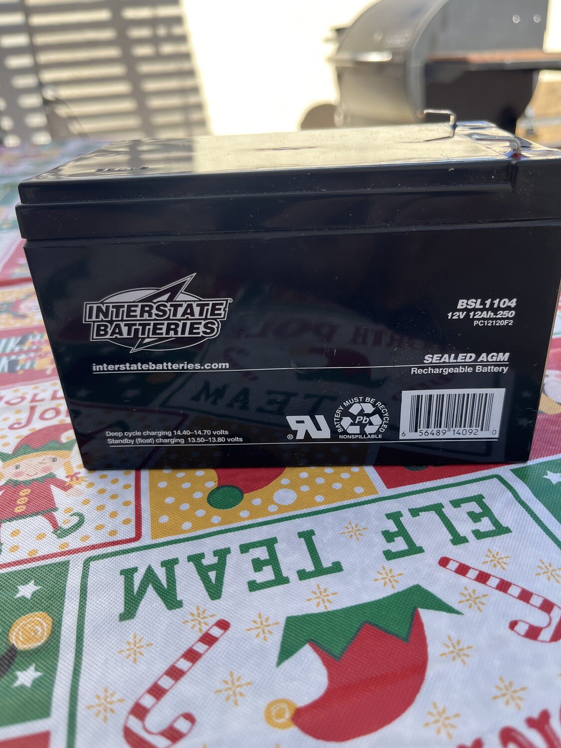

don’t have any batteries in mind. any recommendations? would like to find something that fits within the existing battery pack case. (currently houses 2 BSL1104 12v 12Ah SLA’s approximately 6”x4”x4”.)

I have the black version of this bike. I was actually looking at maybe a hailong battery, or shark type battery may fit in that same spot.
Just above the bottom bracket, there are old springy posts that the old battery connects to. You can remove the whole plastic “plate”. There will be eye type terminals that you can unscrew and attach another battery source, like a drill battery. You can even get a 24v lithium battery with XT60 connectors and wire up a similar end to the terminals on the “plate”.
PS, You don’t need to have the original battery and case. You’ll actually have more room for a lithium battery without it.

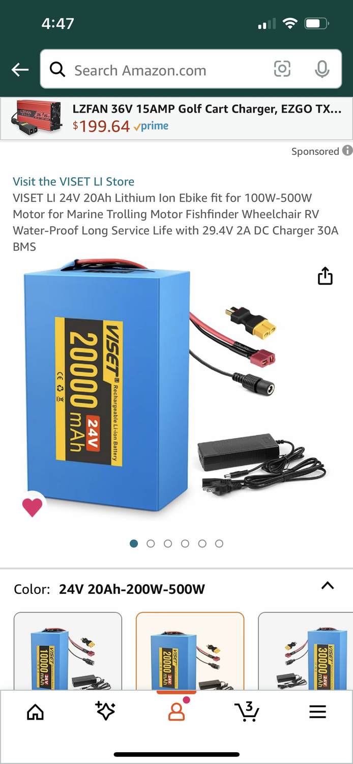

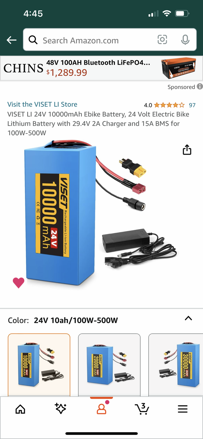

24V ‘tool batteries’ i’ve found are only 4Ah. bike came with 2 12V 12Ah SLA batteries i found these 2 batteries on amazon. the 10Ah would fit in the existing case. the 20Ah won’t.
i can certainly make the larger one work by not using the existing case, removing the connector plate and wiring as you mention. my wife won’t be riding very far on any trip - maybe 4-5 miles tops. and the terrain is virtually flat. so i’m hoping the 10Ah will meet her needs. but if the 20Ah will work with no problems of probably opt for it just so i don’t have to upgrade again if she wants longer rides. both are rated for 100-500 watt motor and the EVG is 400 so good there. if she loves riding an ebike and wants to z really extend her range i’ll get her a newer bike. just didn’t want to dump a couple $k to learn she doesn’t like it. so when she was offered the EVG for free i jumped on it.
electronics not my strong suit so i’m wondering if the 29.4 spec of battery will be a problem. or the 20.3 cut out voltage. don’t want to burn out the motor in use! planning to use the charger that comes with the battery external to the bike for recharging it.
