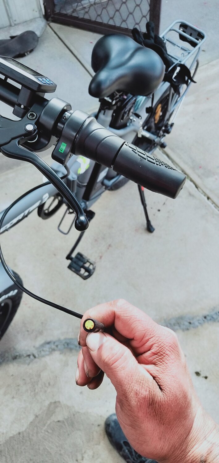

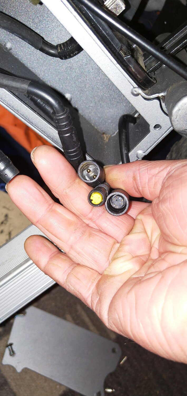

Few months ago I bought myself an ebike off of Kogan, it's the 2021 model Fortis 36v 10ah fat tyre foldable electric bike. It is currently PAS. Now I have not a clue about modifying ebikes or its wiring ect, but I went ahead anyways and bought a half twist throttle thinking it would be simple enough to install....I learnt very quickly that is not the case, for me anyways...could anyone help me out with the correct method of doing this installation or if it can even be done with my ebike. 😓😅

I have a 2020 edition Fortis that has old school multi coloured wires instead of audio like interconnects, I was able to wire in a thumb throttle with 3 wire harness with 3 flat male pins, the controller has the female white plug to support the 3 wires, no problems getting it to work, the only downside the throttle is inactive on 0 assist
