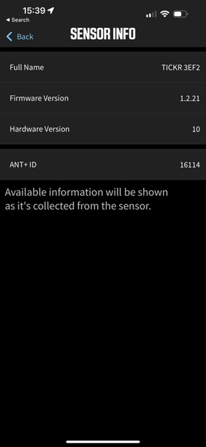

Hello, I have a new Turbo Como. I am trying to pair a Wahoo Tickr heart rate monitor (older version see pic) with my TCD and MC app. It will either pair with one or the other but not both so I am guessing the version of Tickr I own only pairs with one device at a time. Do I need a Heart Monitor that will pair with at least two bluetooth connections simultaneously? Thanks

Thanks everyone for the help. I have a 2022 Turbo Como. I believe I do have the 2014 Tickr (HRM). I tried multiple times/methods to pair it. First with MC on the Bluetooth/iPhone, then with TCD/ANT+ in that order and then I reversed the order. The HRM will show up paired in MC under preferences/Devices but when I go to TUNE/CUSTOM DISPLAY/ in MC to find the "heart rate" metric, it never shows up. The issue with the bike/TCD is the following: I can pair via bluetooth and the actual name of the HRM is seen on the TCD screen, but when I use ANT+ the name of the HRM does NOT come up on the TCD screen even though the TCD still states it was paired. The bottomline is that even when I think both are paired simultaneously, I have yet to be able to select a "heart rate" metic in MC so I can see HR on the TCD.
I think you are correct in that I need a newer version of the HRM. I don't like chest straps and rather get an optical HRM. I may try the Polar Verity Sense which has 2 simultaneous bluetooth connections along with ANT+. I would also like to try the Polar OH-1 or the Tickr Fit but they only have ONE bluetooth connection with ANT+. I guess the bottomline do I need a HRM with more than one Bluetooth simultaneous connections or is it enough to have one BT an one ANT+? I don't know.
