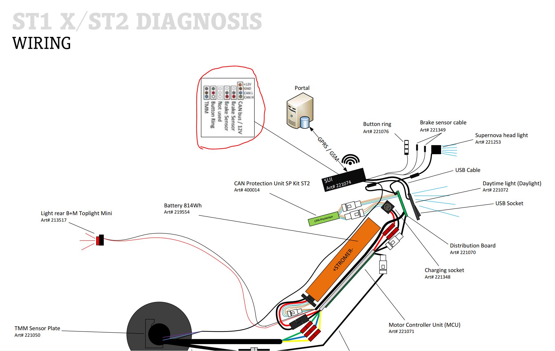

Thanks so much for this diagram. I wish the whole schematic was available but I suspect they keep that under tight wraps. When I replaced the motor control cable on my ST2 I was so focussed on making sure I was doing it properly that I didn't spend any time poking around "under the hood" when it was taken apart. This winter I'll probably rip the whole thing open just to look around. I can measure the voltage an current available from the port connected to the E3 light. It would be awesome if there was sufficient current to replace the E3 with something more like the m99pro. When I spoke with Stromer I was told that the M99Pro required more current than was available, but no one could tell me exactly how much current it could provide. A single sufficiently bright hardwired headlight would make things so much simpler for me.@Chuck E. Cheese , @Stromer2work ,
The ST2 uses sophisticated CANBUS system.
I got hold of the tech experts and they sent me this drawing. The CANBUS port shows 12V outlet but the exact amperage is not available.
My hunch is that it should be able to power ~1A or slightly more. I highly recommend some of the advanced Supernova or Light & Motion lights.
Check this drawing.

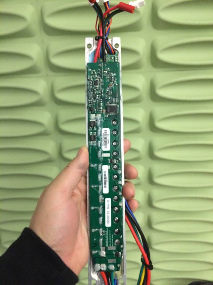

I heard from Stromer that the ST2 has a PCB (power distribution board) below the battery with really specific design specs. They say some dealers have tried to upgrade the light and fried the PCB, and it's $580 to replace not covered by warranty. I was asking about upgrading ST2 to m99 mini pro 25.
Ravi, does this info conflict with the CANBUS diagram they sent you?
Thanks Ravi! Much appreciated! Might you happen to know if the NIP 800 has a beam pattern with a cuttoff to avoid blinding oncoming traffic? It's something on my mind even more than the lumen output.The dealer may not have known certain details. It's not possible to fry the "PCB". The PCB they are talking about is the controller.
If you want to see how the controller looks like, I have attached a picture.
This goes beneath the downtube under the battery compartment. This has powerful MOSFETS to regulate the 48V motor. The light is connected to another board that is close to the OMNI display and it is also where certain signals are separated in the CANBUS channel.
The requirements for M99 Pro is that the voltage should be 24V+ and with large currents. Except the St2-S, most bikes don't use it because of how much power hungry it is. If they use it, they connect directly to the battery at 36V.
If you end up connecting a high-current draw light to the ST2, it may not put the kind of lumens it is designed to. Try this instead of the M99 mini Pro , you will be pleased and save few hundred $$.
Hope this helps.
