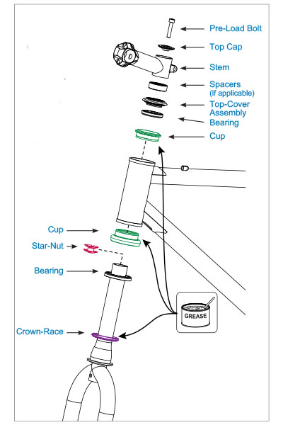

In this picture, is the star nut just pressed into the tube? Probably why a specific torque is advised? Looks like an overtighten could pull the nut up and out of position?
More like pounded in. There is a tool that the star fangled nut screws onto then you whack it in there and the tool stops it at the proper depth.
It sets the load on the bearing. Once you clamp them stem down, the bolt and cap are essentially decorative. You can take off the cap without effects to steering etc. There is a safety element in the redundancy so keeping it all there is a positive.

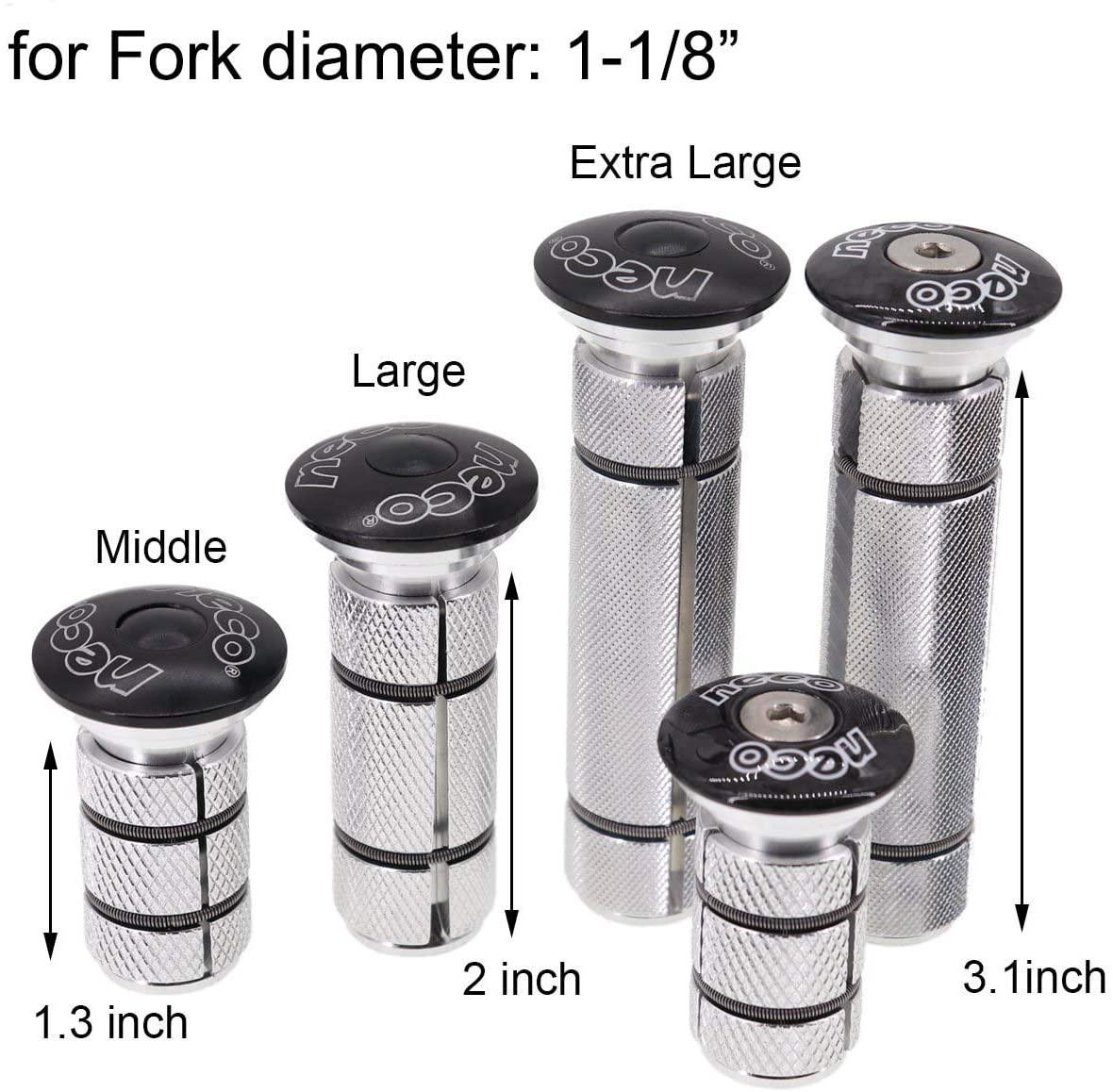

To remove the Star nut, just take a deep socket and hammer to tap out the nut through the bottom of the fork.
I recommend that you replace the star nut with a high quality expanding nut that is adjustable to fit your fork.

To remove the Star nut, just take a deep socket and tap out the nut through the bottom of the fork.
