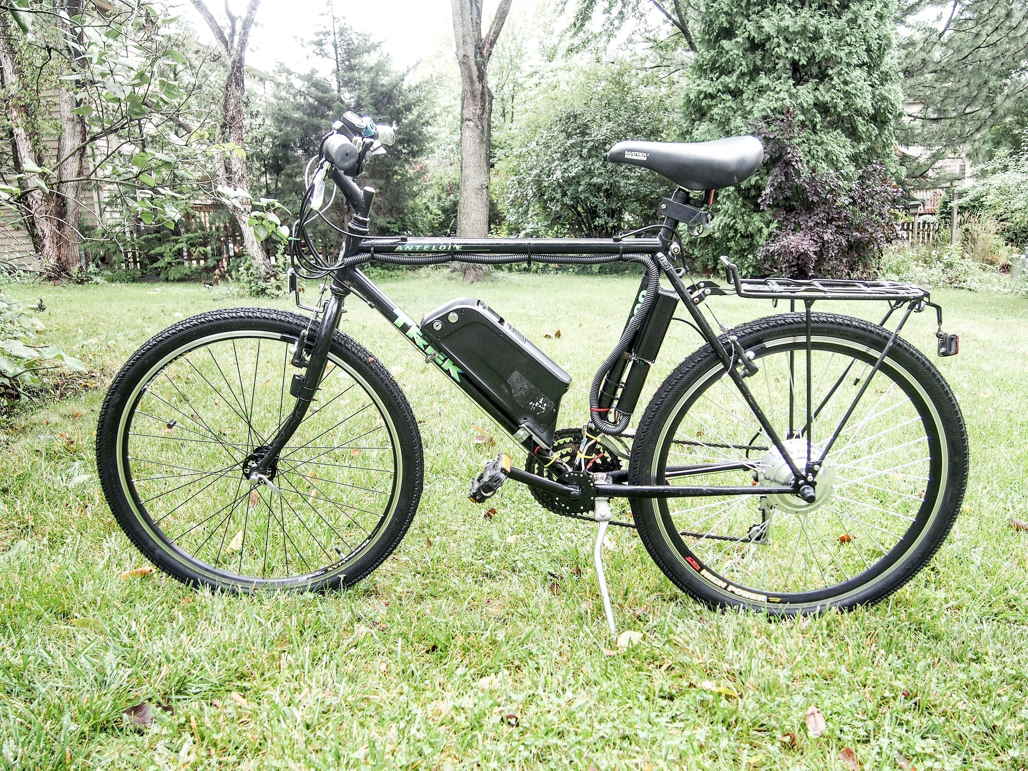

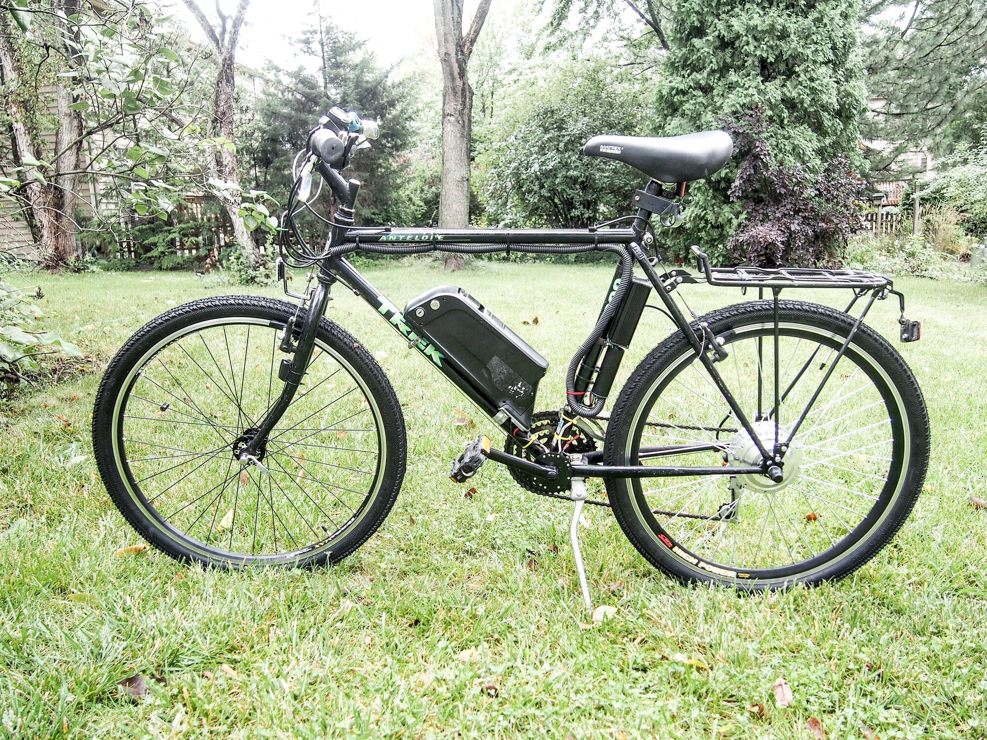

I put a ebikeling kit on a Trek 830 in 2015. It was 500W 36V rear geared hub for $200. Added a $280 36V dolphin battery and it's been a reliable ebike. Always there if I want it. Just a simple three speed PAS with throttle. 20 mph. No display. No frills. The natural upgrade would have been to upgrade to a 5 level PAS controller with LCD, but I never did,

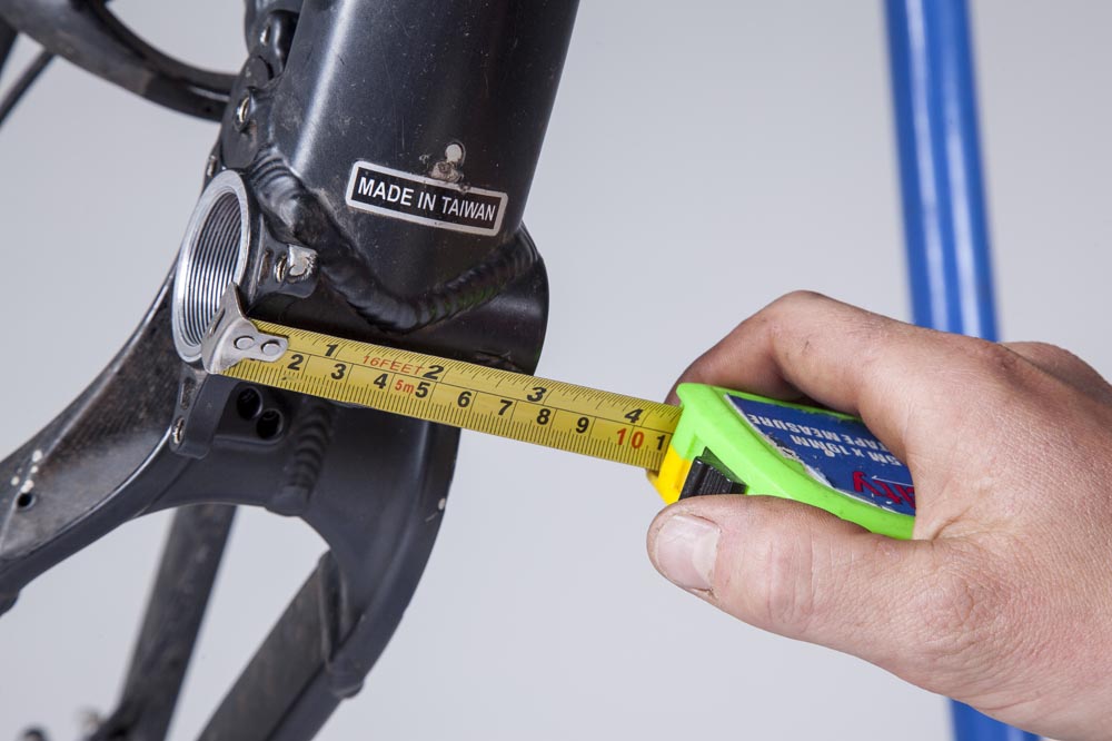

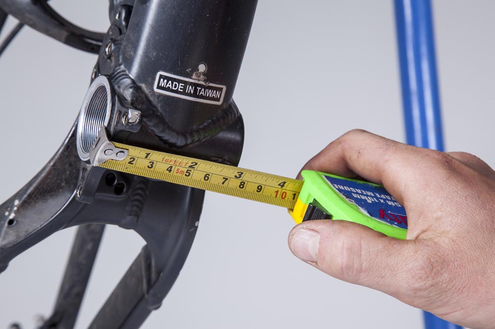

Or you could consider a mid drive. The Bafang BBS02 is about 450? I paid $550 in 2016. The standard kits fit bottom bracket widths of 68-72mm. There are higher cost kits for wider bikes. Better for hills, but you still have to be a bicyclist at heart because you still need to use the gears. Personally, I think the mid drive is easier to install. The cabling is easier and there is no controller to mount on the frame. A hub motor is tricky when you have rim brakes. You may have to dish the wheel to center it between the calipers.
