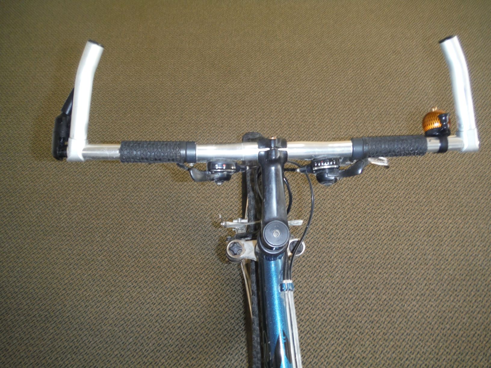

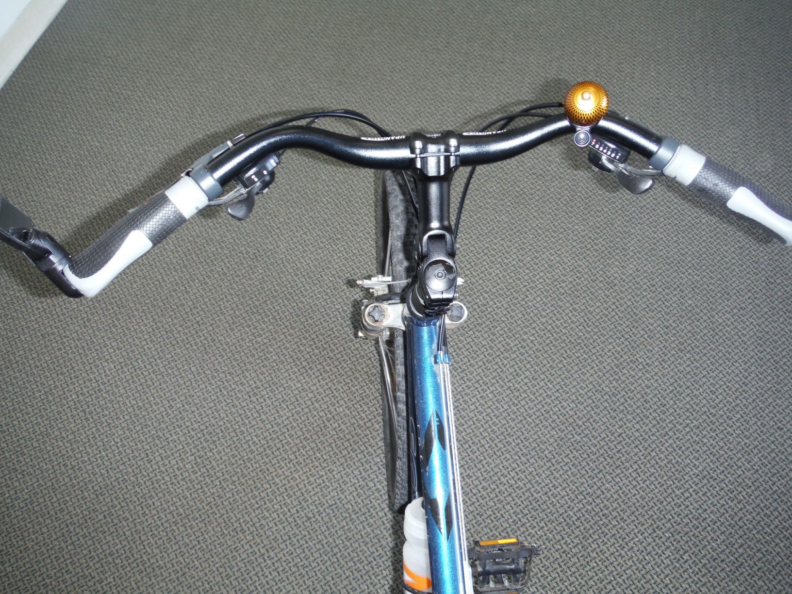

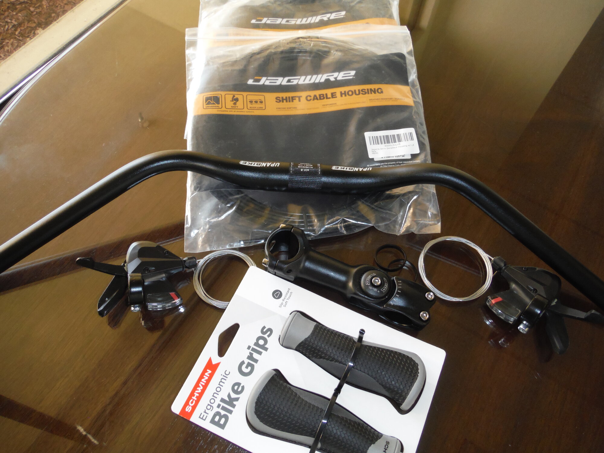

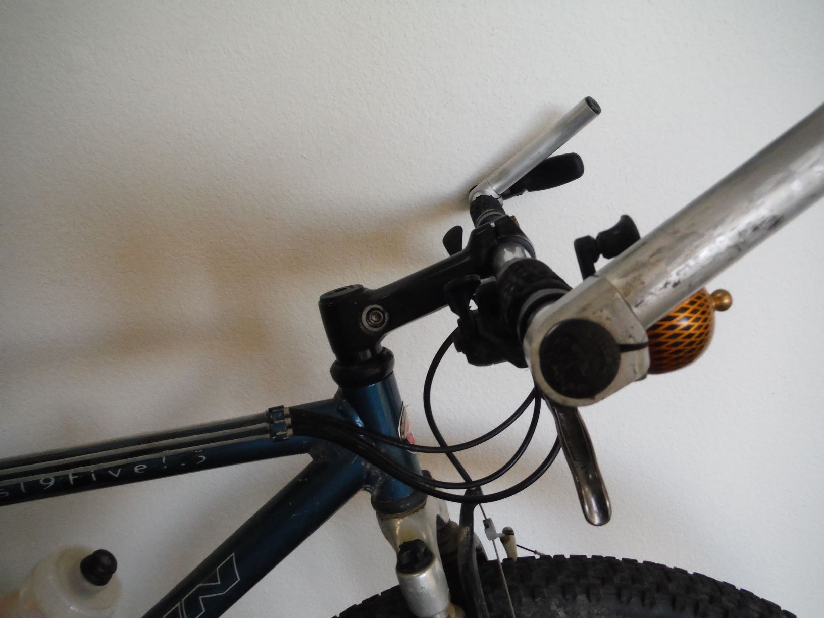

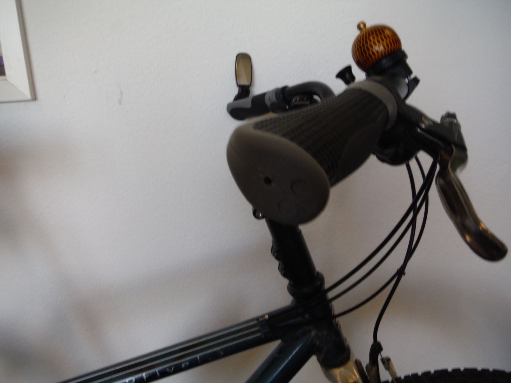

@kenleerevalee, I do this sort of thing regularly. Measure the HB diameter at the stem of the bar before you order. Take a look at the Bikesmart Poshterior saddle. Everyone loves it. It is open at the middle, is filled with gel and has springs. @Buzzardmeat, do you see any throttles that are two-part, that could work. Or use a Topeak versamout to a 7/8 section of pipe.

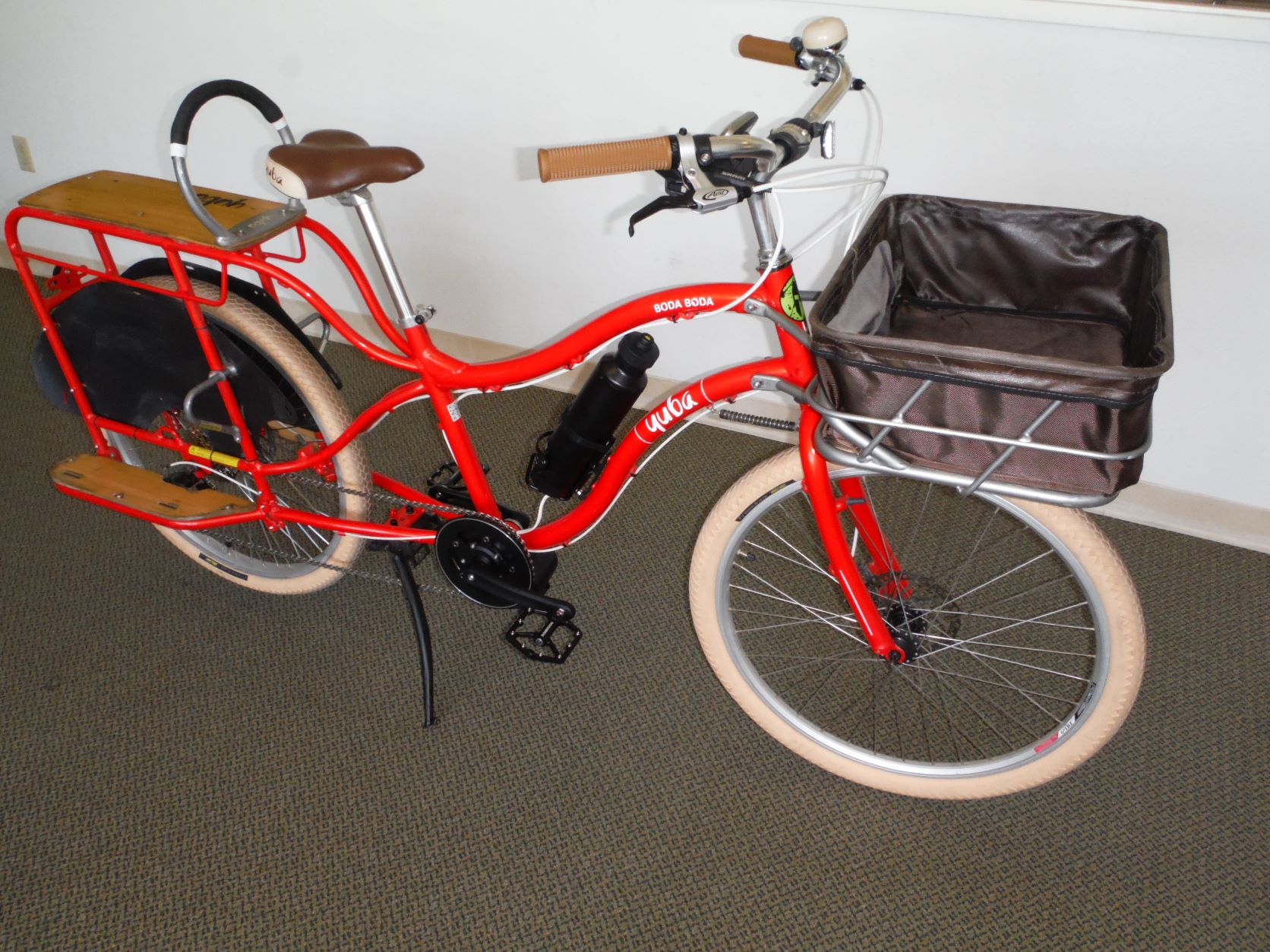

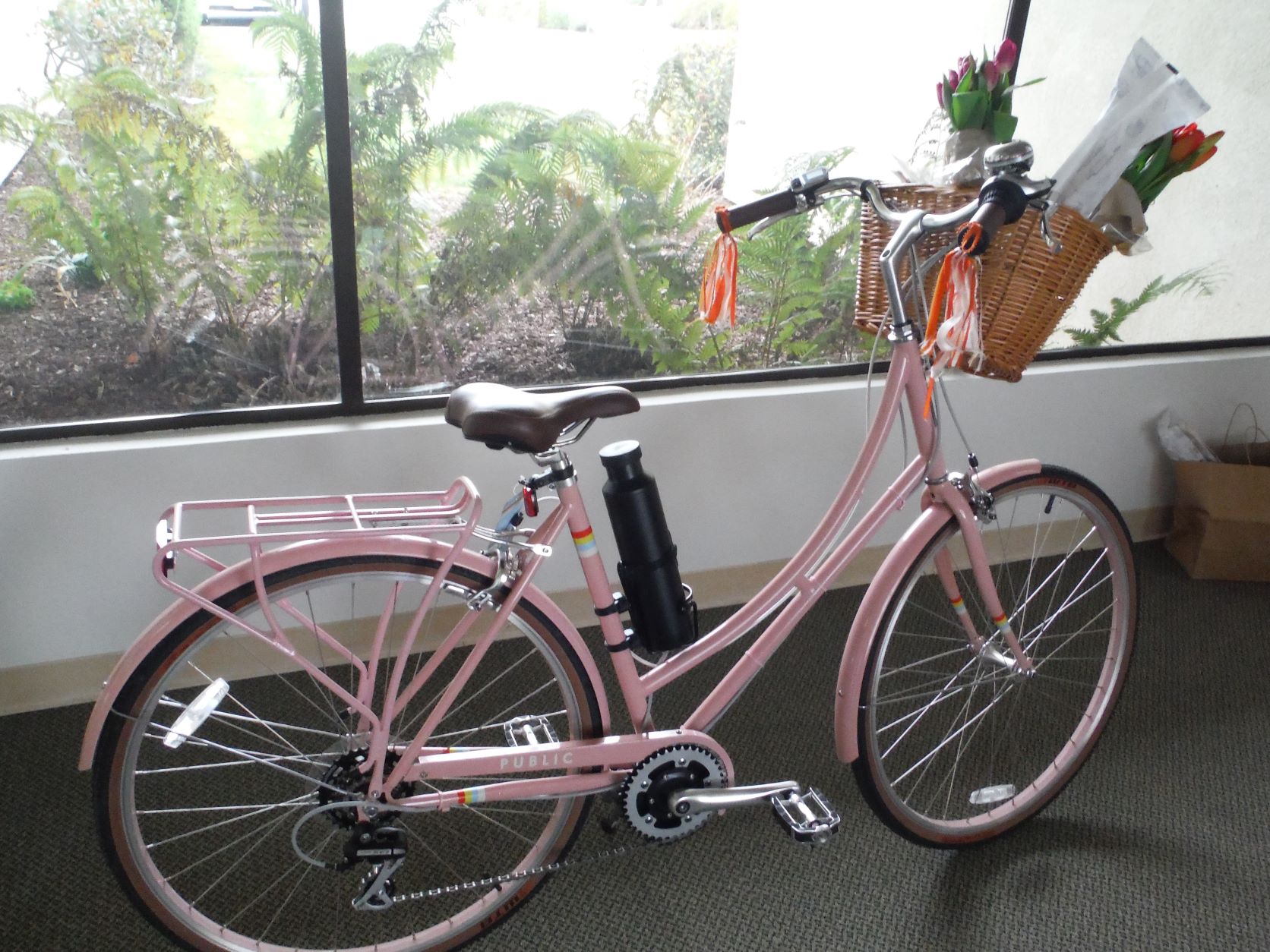

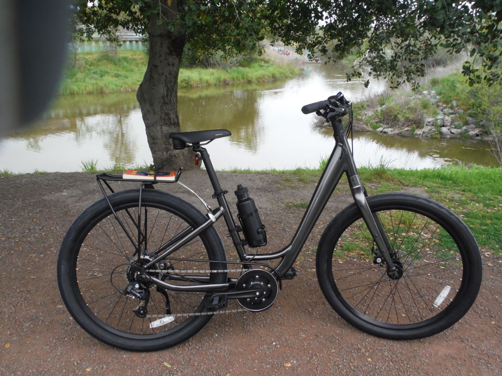

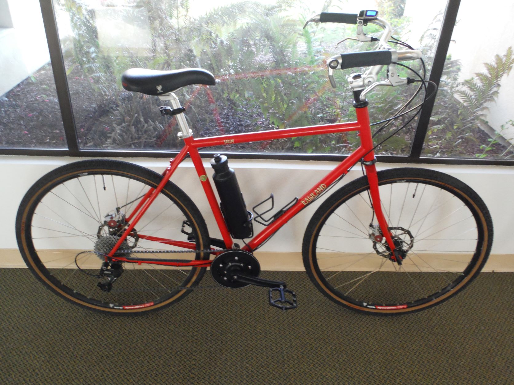

That sounds like a pain. I would rather mill the throttle and keep the balance of the HB. You do know that you can ghost pedal these bikes. A throttle is not really necessary. They have a cadence sensor. If you move the pedals about 1/4 turn then you can pedal super slowly and without any pedal effort and the bike will go full speed ahead. I make bikes like this. The second one is all through frame. On the red you can see the white wire to the motor from the battery. I chop off all connectors. Click zoom on the red cargo at the HB.

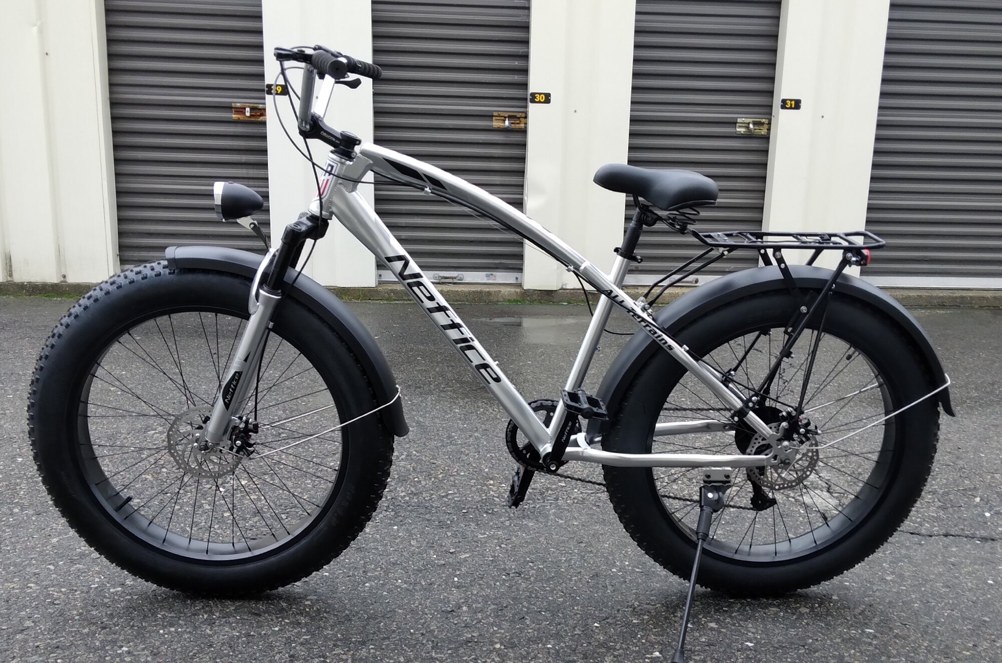

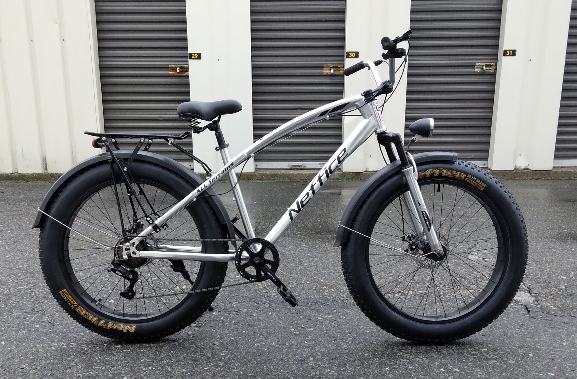

Oh, by the way, here's my bike so far. I've got the triangular battery and the rear wheel is still in transit.
Those handlebars are being replaced with 10" pullback apes.
