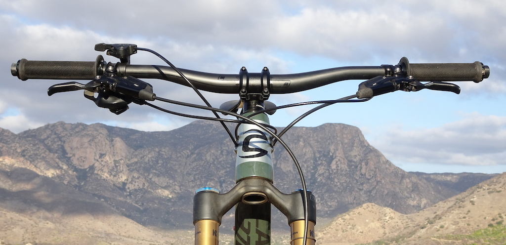

I just cut my 800 mm bars down to 700. That's pretty much a 4 inch reduction and I like them a lot more. I've had the bike for nearly a month now and just did not like the look or the ergonomics of the super wide bars. When I put the GP5 grips on I liked em even less. To me they look and feel so much better now. 👍
I cut down the bars on two of my bikes, a Scott Metrix and most recently the CF bar on my Trek 970. Both are around 660 mm and sport end grips. I’ve never been accustomed to the longer bars that are so common now and seeing that I currently have my eye on a Trance which comes with a 780 mm bar, I would certainly contemplate doing the same albeit perhaps not so drastic. Good to hear that you're happy with the outcome.
I cannot understand all of this quandary 🤔 Two of my e-bikes are equipped with 680mm handlebars, the third one has the 780 mm bars. All are equipped with Ergon grips. And al thesel e-bikes feel so comfy to me. Randall, reconsider shortening your bars: these are so wide because you can manoeuvre (what a difficult word to memorise!) your e-MTB easier...
I need to narrow the bars a bit as I've really aggravated my hands and wrists riding on the packed snow. That, plus the shoulder issue, has me using the extreme inside of the grips and negating the ergonomic wings.
I really think the GP2 horns are too far apart to be comfortable and by taking 20mm off each side, i will achieve a better hand position. I hve no intention of going as narrow as some people hve done, but I'm definitely too wide now. I tend to be pretty conservative and try different things before I get the saw out. This shoulder isn't helping on the comfort either.

As I mentioned on another thread, I had my handlebars cut down 1.5" /3.8cm on each side. Still wider than 10speed drop handlebars of old, but a lot easier to get through the door. Most importantly, much better for my shoulders. Feels a lot better. If you think your handlebars may be too wide, they probably are. More in-line with your shoulders is better.
I spose not many have a plumber's tube/pipe cutter in their tool box but these things make cutting bars child's play. Makes a perfect neat cut as well. A little reaming of the left over internal burr is necessary. 👍
I would feel okay cutting an alloy bar with a pipe cutter but it isn't as easy with a carbon fiber bar due to the strands. I've used one as a guide to score CF bars in the past and then completed the cut with my Dremel and a diamond cutting wheel. BTW, I always wear a mask when cutting CF.
Well, it's been almost a month since I trimmed the Trance’s bars and I have absolutely no regrets in doing so. In fact, it’s made a huge difference in my ability to negotiate tight spaces and turns on single- track runs. Steering precision has greatly improved. I don’t feel any less stable in any given situation even on long downhill runs. I’ve also stuck with traditional lock on MTB grips ( Ergon GA2s) for this bike rather than going with bar ends as I felt they might get hung up on obstacles during my rides.
I did manage to ride with the stock lock on grips inboard for a week until I felt comfortable trimming the bars to 700 mm total width which was down from the stock 780mm. I used a pipe cutter as @reed scott suggested and it worked out perfectly on the alloy bars.
If you’re sitting on the fence with respect to cutting the bars on your ride, I would suggest using the inboard grip technique first before you take a hacksaw to it. It confirmed my decision without hesitation.
