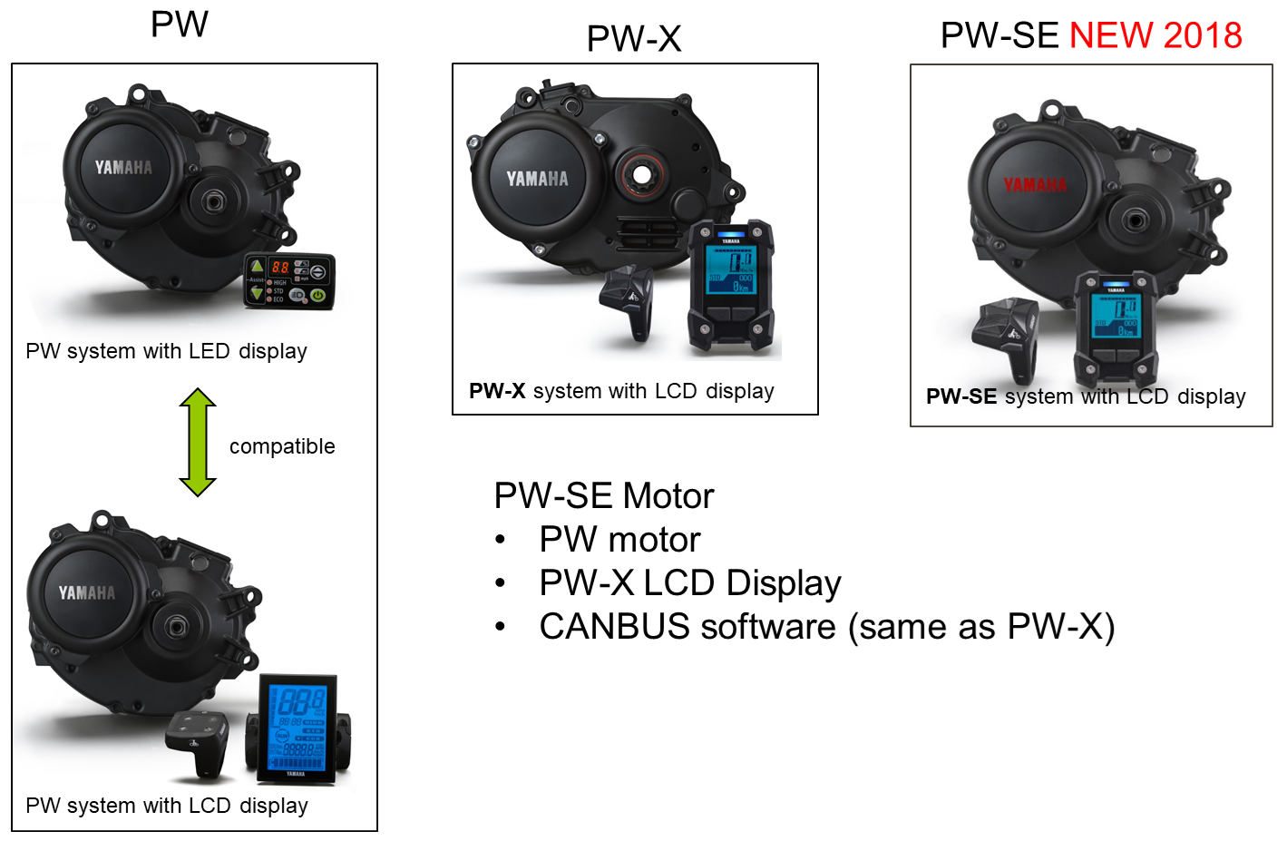

Well done. Did you replace the display with the same LCD type or upgrade to the Type X?
Ah, so you replaced the 2016 LCD display/mount with the LED version shown in the left hand picture? If so does it have compatible electrical connector next to the motor?
ps can you share a link to that information as I can't find it
Thanks
I have a similar question to "mcgrit" that I'm hoping you can answer. I have a 2018 Haibike Sduro Hardnine 1.0 and would like to know if it’s possible to change/convert my LED display to an LCD display or maybe even to the Sideswitch display?
Thanks
Just to clarify... I have 2 EBikes outfitted with the new Yamaha motor/display/battery systems.
One PW-SE and one PW-X: both have the upgraded CANBUS LCD display on the right diagram.
If you have the original PW motor, then only the LED or original LCD display are compatible... left diagram.
Hope this helps. ;)
