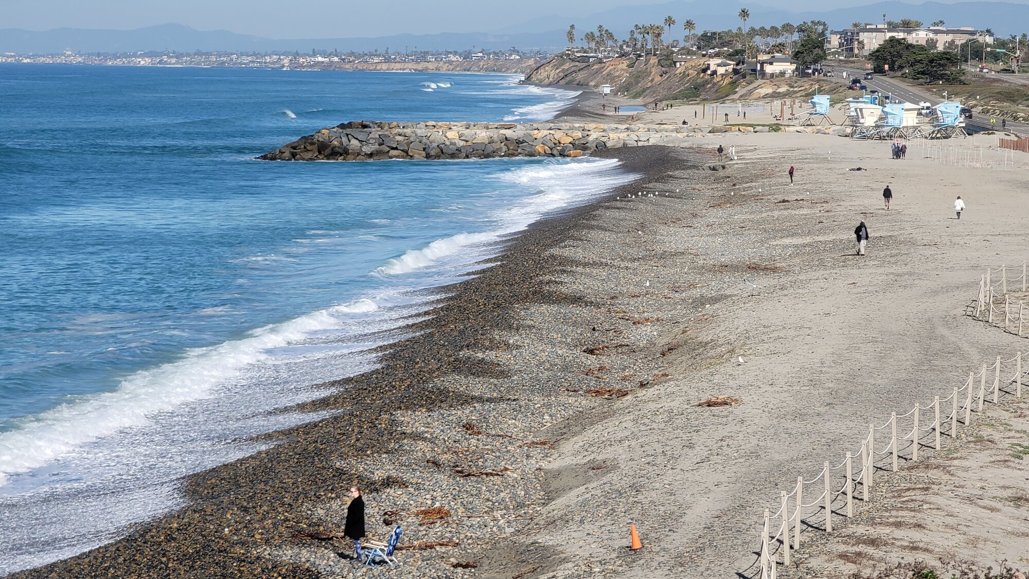

I watch your beach rides in total envy! The longest one-way run I've ever gotten here is 3.5 miles, but it takes a rare confluence of events to set it up.
Sand here moves back and forth between the beach and nearshore bars on a partly seasonal, partly seemingly random schedule. When it's largely offshore, a given beach can be mostly or entirely unrideable cobble at any tide — like this.

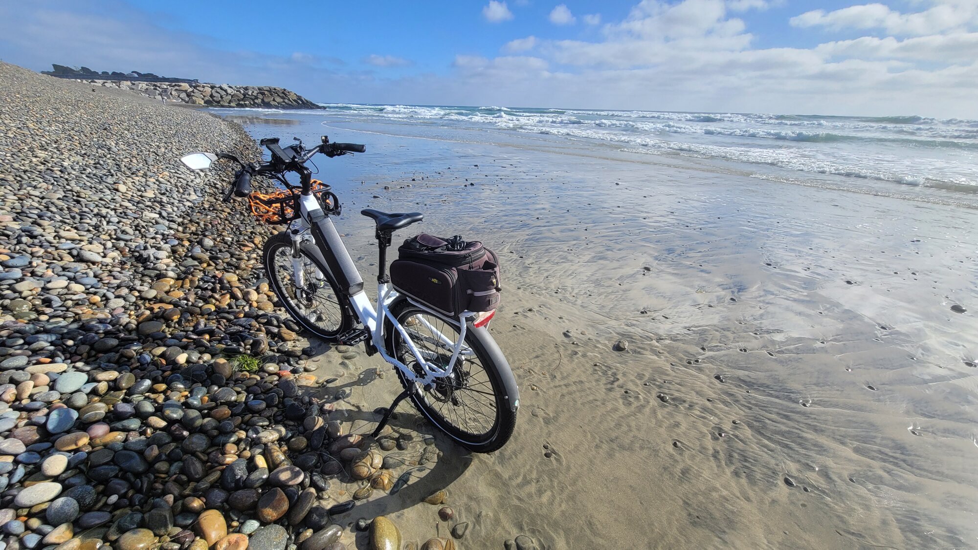

But when it's mostly onshore at an exceptionally low tide, you can get an almost 4-mile sand run between 2 Carlsbad jetties — which of course are totally impassable at any tide and don't go anywhere by design.
No way to predict this happenstance. You just have to luck into it, as I did this last August. Otherwise, you're lucky to get 2 miles. Couldn't quite make it to the south jetty in the distance here, as the tide was starting to come back in by then.
