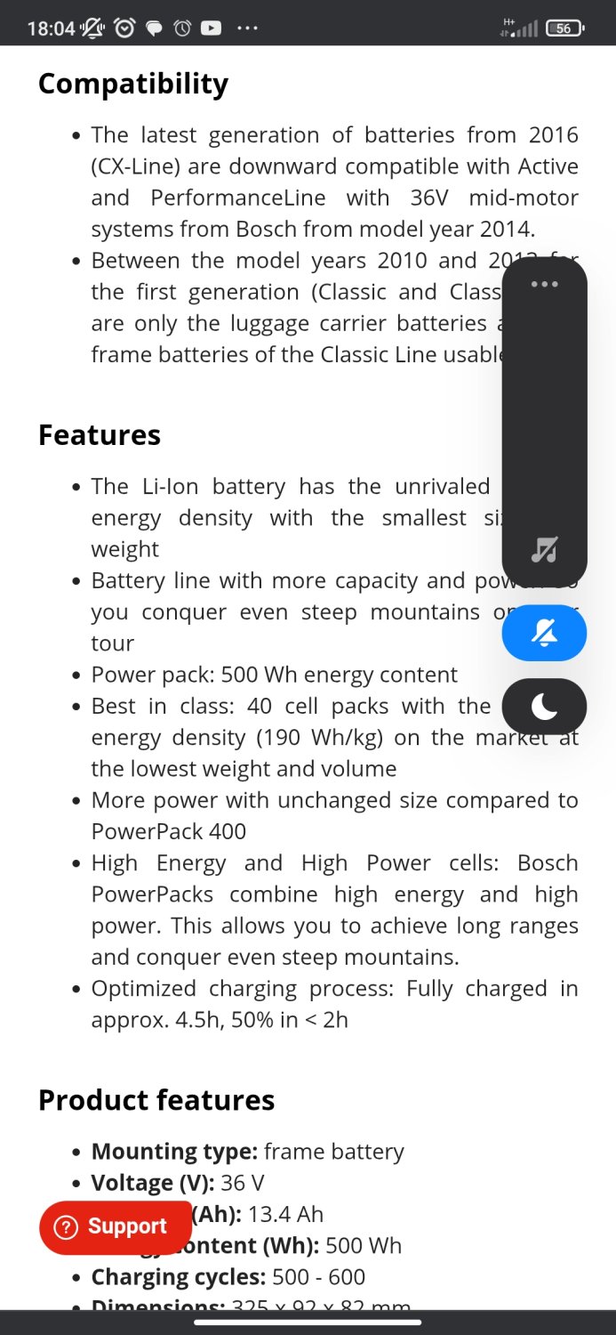

Sorry for been a pain in the butt guys but this is really annoying it states for 2016 models and down its compatible but for classic and classic+ it is only good for cargobikes and Frame bikes?? (Can someone define FRAME BIKES )TO me that would be bikes that u mount your battery to the frame! which im guessing thats what mine is as its a 2014 bike but made in 2013 so i take it this was the last of the classics probably a + but heres something i found which might help me and honestly i think firmware and getting motor battery and display on the same level should see this old dinosaur run again its a really nice bike for a hardtail it will run maybe not as original as first taut but ive a backup plan if not ✌️ Screenshot_2025-01-22-18-04-05-761_com.android.chrome.jpg
