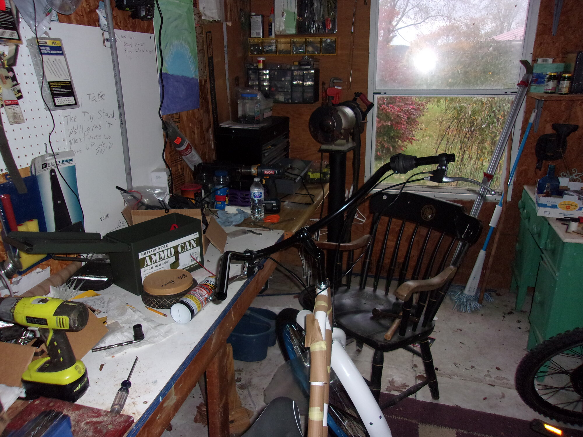

You can get one from Canada, Justin of "Grin" converts DD motors to "freewheel style( pricey though) Weight isn't that much problem on the"flat or a RR grade"( just do not get ""Pukin' exhausted, if you convert an "Acoustic' bike make sure the rear dropout is wide enough to accept whatever drive unit you choose, After owning some 350 watt bikes with decent controllers,I was impressed( the bikes I refer too would give you almost that much torque to"stall"" Once you commit to "EBikery' its hard to go back- your knees will thank you and you will be looking for any excuse to ride.
On the regular DD motors you can accommodate" regen", which is a good speed control downhill and brake saver, wouldn't look for extra range though. Shown happy clutter and a "Future victim.

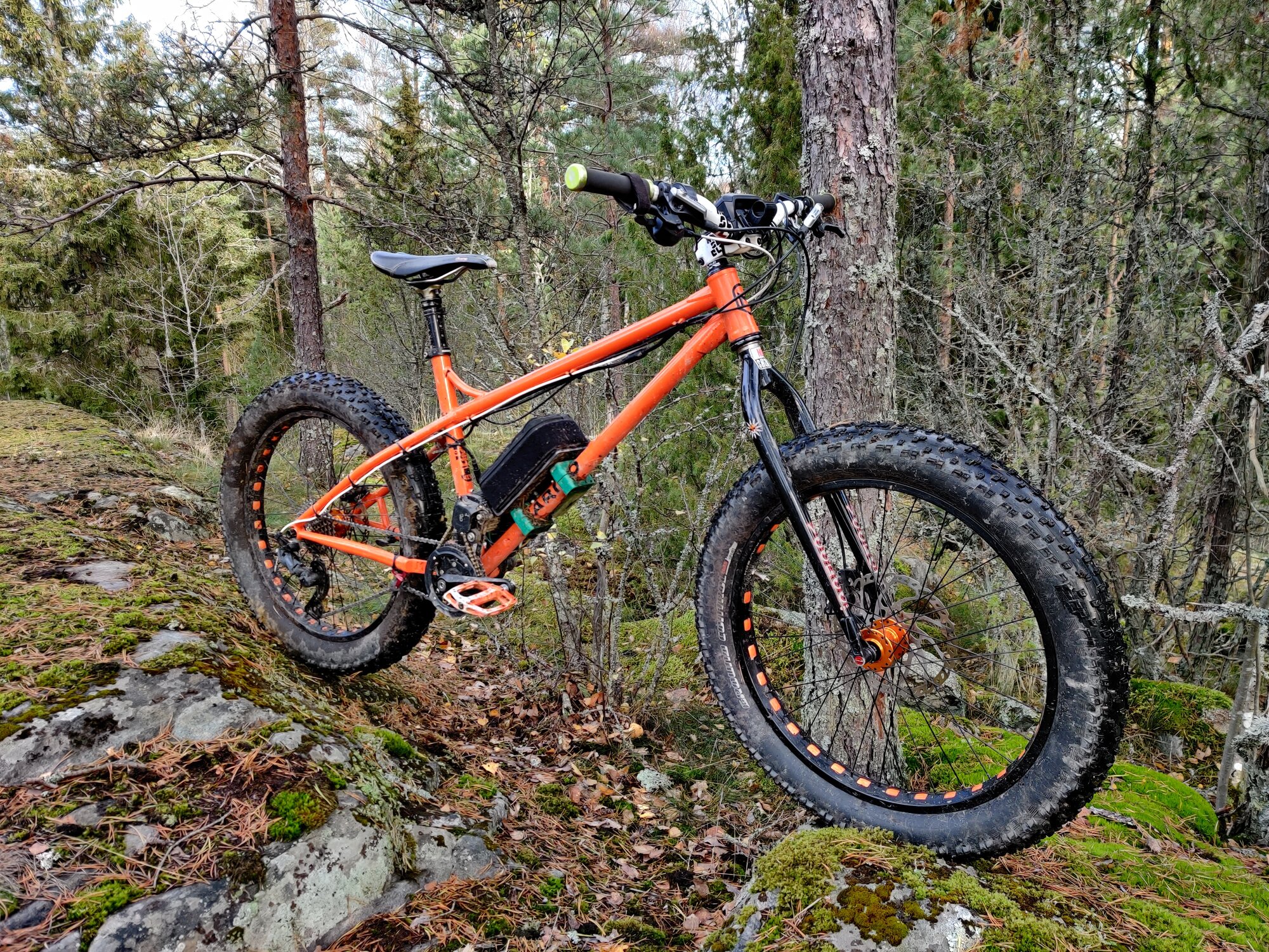

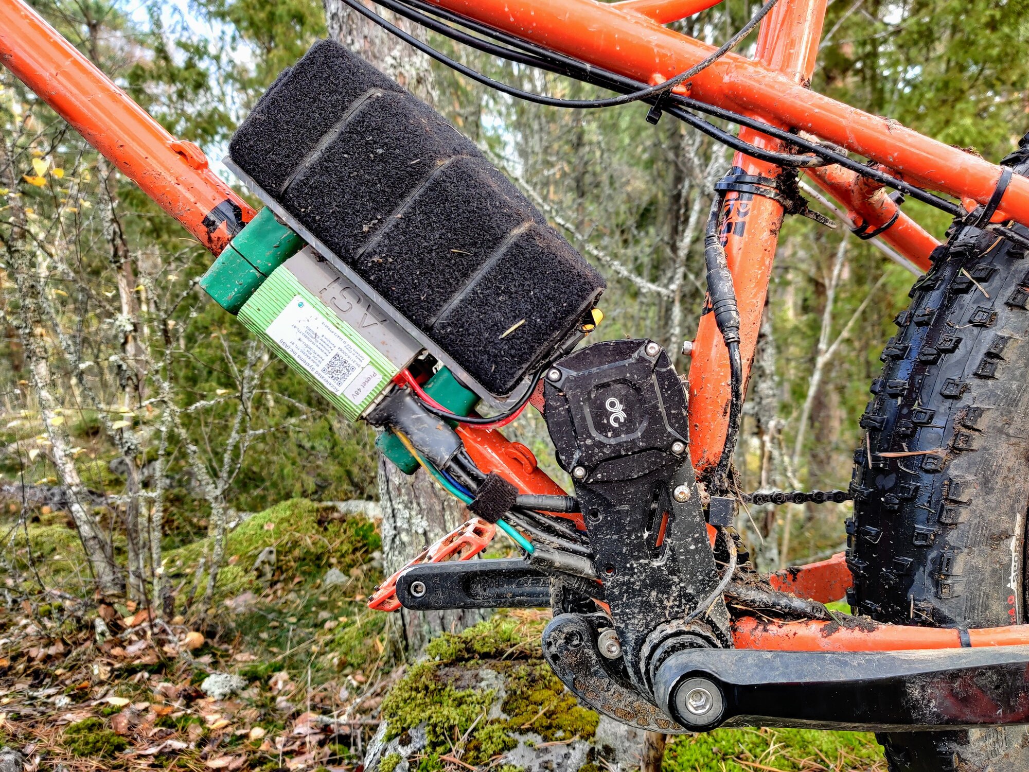

I do like the look of that Mike, it's not yours though? - would love to read more about that as it looks like simplicity itself as far as the mechanical drive goes.
Not mine ( BBBS02 )
That Marino is a CYC X 1 stealth drive with hobby king battery pacs
