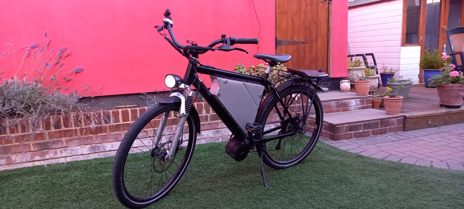

I used a BBSHD (mid drive) on an old MTB frame and built the bike up around that to work well. 200mm brake disc rotors with Avid BB7 calipers. Designed and built the battery box myself. 46T Lekkie Bling Ring up front and a 12-36 9-speed Shimano steel cassette takes care of all road hills near me (fairly steep) and can get up to just over 60kmh on the flat. 31.5Ah battery gives a range of 80km on full power (average speed around 37kph) with no range anxiety. 1.75" e-bike road specific tyres. I weigh 170lbs. Front shocks on the forks and a parellelogram suspension seat post (not shown on this image) make for a comfortable ride (which could be made more plush with a larger tyre and tube on the back). I use it to commute to work every day. I made another for a friend of mine.

I do apologise Alton, it looks as though I didn't read your earlier reply judging by my last question, but I did - it's just a combination of age and painkillers with me. Your bike looks excellent, and more mental enjoyment when riding knowing you did it all yourself unlike me.
No problem. at all. I am very careful maintaining, monitoring it and built it to be secure, reliable and safe.
Mind you, downhill I still go faster on my leg powered road bike on skinny tyres, no suspension and wearing far less clothing protection!
The risks are relative.
