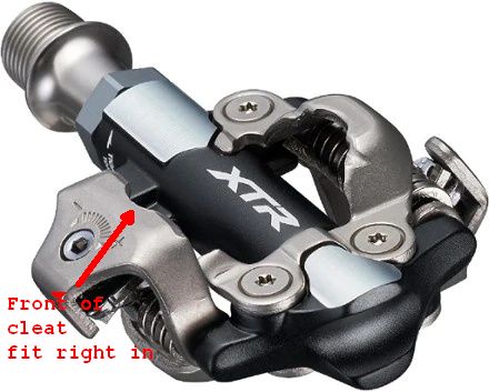

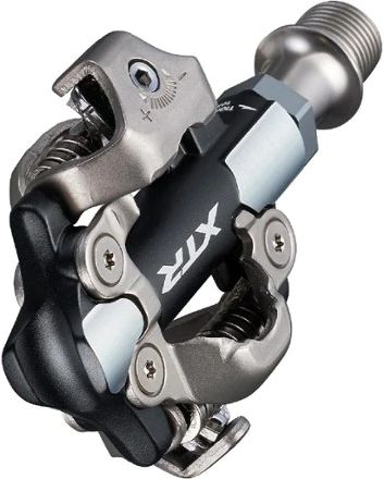

No. I did not take any offense at all. Backwards pedals/cleats was just not anything I would have imagined so did not give any thought to their orientation. As @bellandbottle indicated, they could not even get in. I really did not have issues getting in. Just getting OUT. Looking at them, they did not show any evidence of being wrong, in and off themselves. They were SPD pedals. And as soon as I wheeled it into the shop the first mechanic was "sure, those pedals are backwards" but he was concerned about cross-threading. Even he did not think about someone reversing the cranks.
I rotated the first attached image and not expecting anything odd, I did not even consider that as an issue. The sculpted curve is similar on the spring and non-spring side.

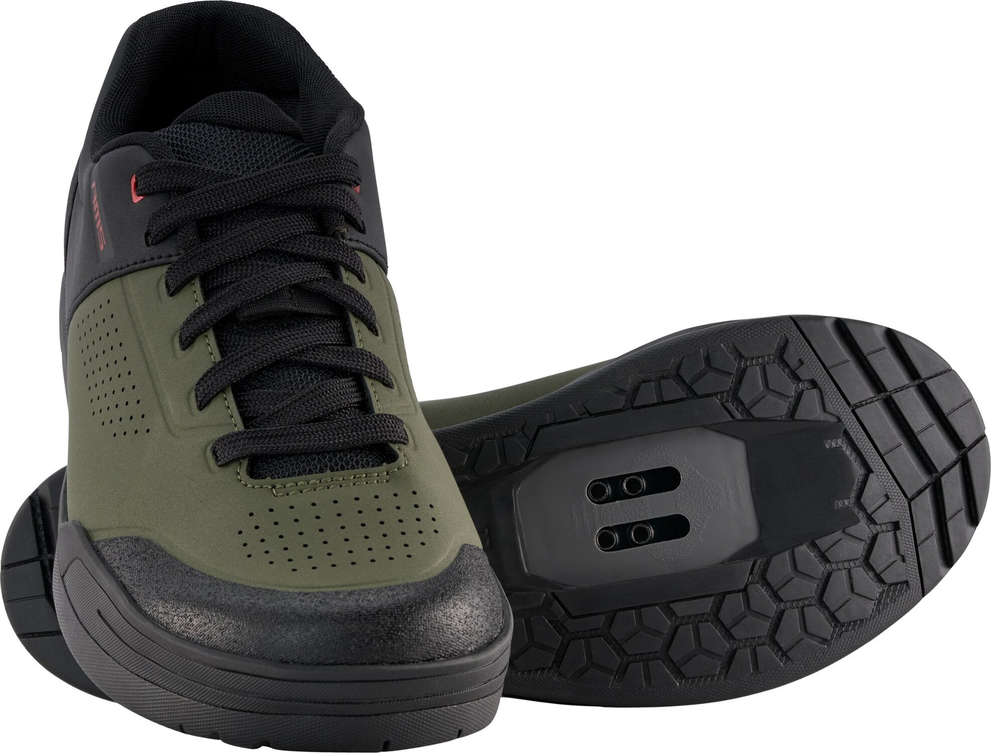

Can you show pics of shoes clip. You guys will want special shoes for the pedals.
When you twist toes? On your right foot do you kick your heel to outward?

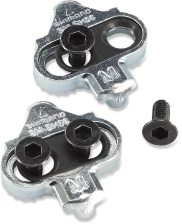

Shimano (and copy cats) make a variety of cleats and pedals and other makes lots of shoes. I prefer "multi-release" cleats that can disengage at various angles including to some extent tilting the foot. Shoes are generally designed with a plate or inset that can be removed/replaced or actually permanently ripped out. The created recessed area will accommodate the cleats so you can walk flat footed. The cleats and shoes generally have slots so there's some forward/back or side to side adjustment so you can angle them to accommodate your foot, ankle, knees positioning. But then you tighten the cleats. There is still some play/movement as you rotate your foot. Some folks don't like being attached to the pedal and you do have to get use to them. They also make pedals with the cleats on one side and a flat platform pedal on the other for different riding needs.

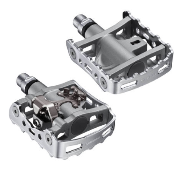

These are the pedals I have, and you can see it is easier to spot the front from the back :)
