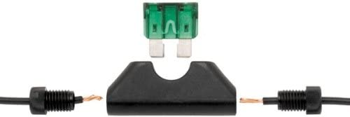

This is a Maxi style fuse so it will require a slightly larger holder than the one I originally sent you like this Fuse holder

You must have a short somewhere and will keep blowing fuses until you locate the short, my ignorant guess is that it is a problem with the controller like you suspect. My wife had one of those side saddle Currie motors on an IZIP TRAILZ AL bike several years ago. I doubt that you could blow a fuse by how you ride it or due to chain condition unless it was jammed up tight somehow. I lugged that motor riding it up a mountain without blowing the fuse. Don't see how changing a fuse or fuse holder is going to help but for simple installation without soldering or using wire nuts this is a good blade type fuse holder that I have used once or twice.

So what ur saying on the fuel it thing in the orange box is I can use a plug in fuse instead of a glass fuse 40 amp of course
Yes... That's similar to what I suggested yesterday. It's the proper fuse as it is DC: Direct Current.. battery power.
The one that you are currently using is AC: Alternating Current as found in your home.
Though they work in principle the same... DC requires a larger gap when it blows. And the AC one is also fast acting... Not slow blow.
A final note.. the one suggested here only goes up to 30 amp. Which may be fine... But I do not think that you will find a slow blow in this ATC/ATO style.
That's why I suggested the Maxi style which goes up to 80 amp and also allows for the slow blow type fuse
