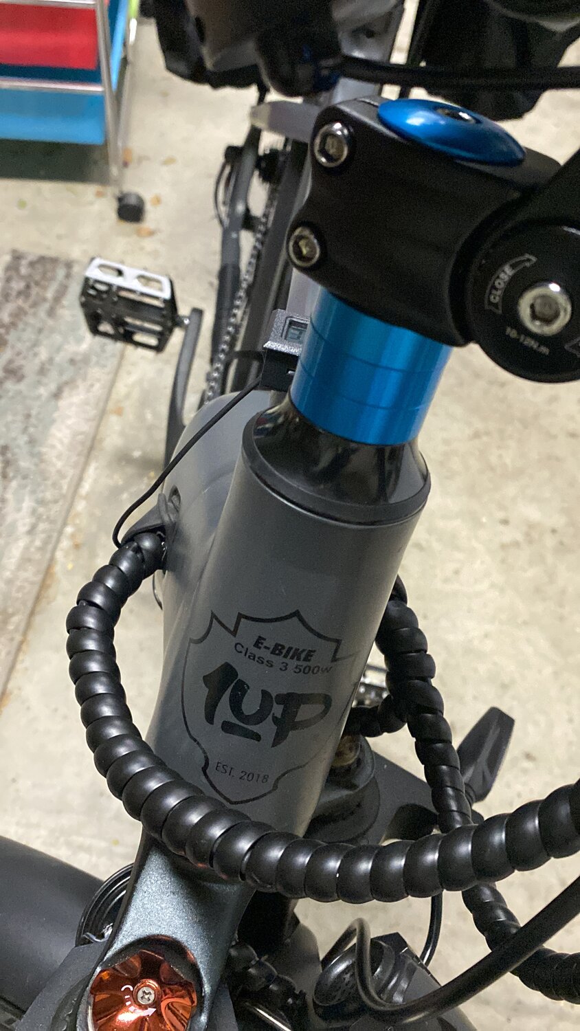

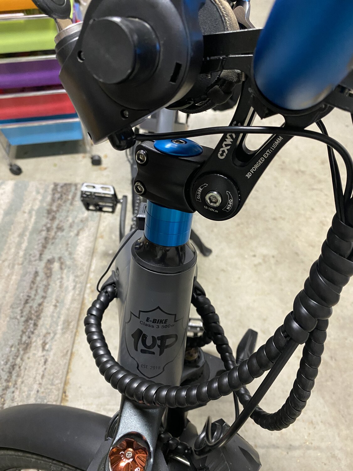

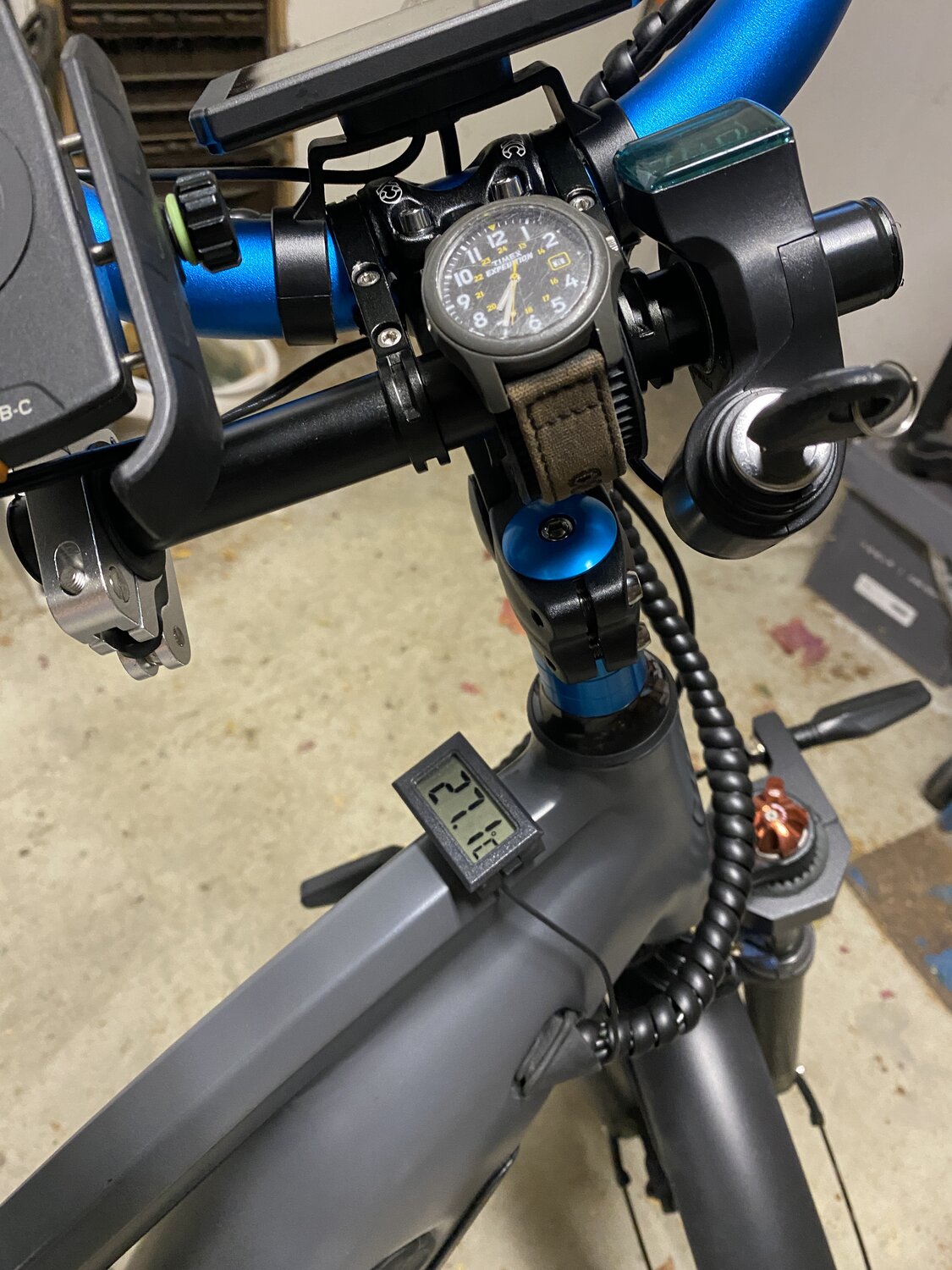

Got distracted from thinking about regressing the mixer when my spacers came. I had an extra 5mm play with my new riser stem. Needed another 5mm for it to fit right. Figured I’d get a matching blue. The reason I had to get a new riser stem was because, my existing one “knocks” I notice it each ride. I feel it. As much as I tighten the clamp bolt, at the elbow, it is still present. I checked and checked the fork, wheel, and handlebars too. Once I isolated the “knocking” sound/feel, I immediately searched for a new riser stem. This one is (not blue ha:) 20mm taller and feels nicer quality than my original.

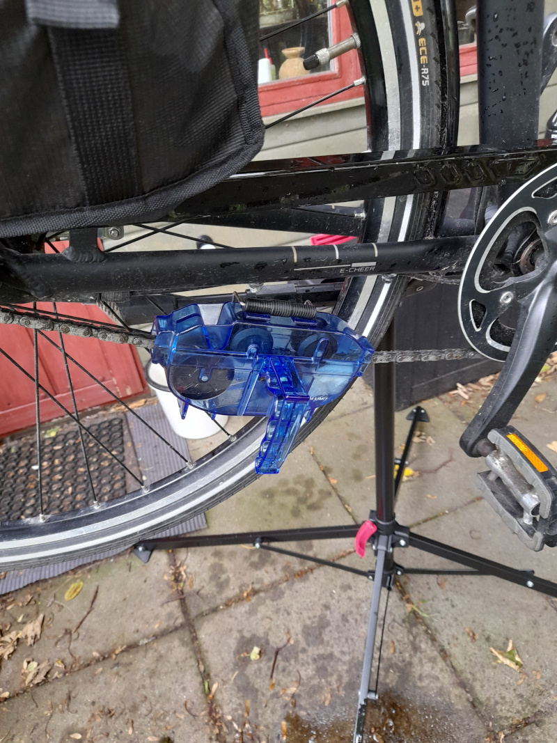

This device for easy cleaning of the chain.
Works fine on a hub- or no-gear bicycle.
First time using it, and was amazed how the cleaning liquid turned into fat black gunk and dust.
So repeated the process.
Encourages me to clean and oil the chain frequently.
