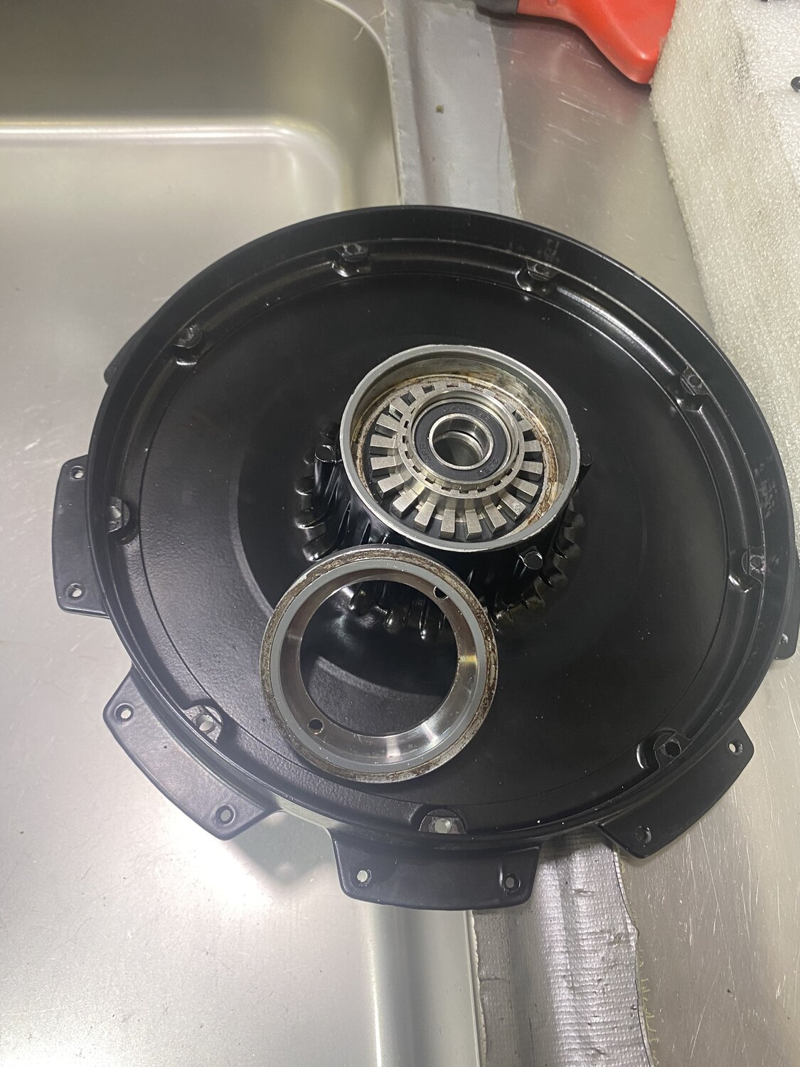

Could the stator being reworked to fit the threaded ring from dt swiss? https://www.dtswiss.com/en/technology/wheel-technology/pawl-technology/
That would be great fix for the issue actually, why not. Then you need to distroy the aluminum stator. If you are lucky, the new DT Swiss Threading diameter is smaller than the Stator diameter and you can still replace the Stator in the worst case... But I neither have tools for threading, nor the old parts to try...
Cengiz
Cengiz
I would need to have an old stator to try. I know some metal workshops that could easaly do the mechanical rework of the metal parts.
There are time to time broken GSD motors in Ricardo.ch, you have to watch regularly... Especially the ones from ET1.

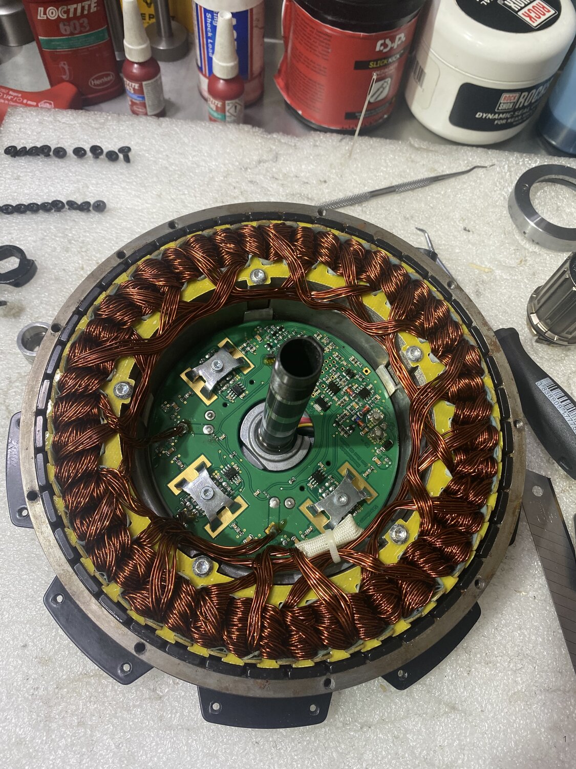

I measured the N-MOSFET power transistors (IRFB3607 P512D in TO220 heatsink packaging- there are 12x, 4x per phase), 2x of them which belongs to 2nd phase was broken.
(Here is the data sheet: https://www.infineon.com/cms/en/product/power/mosfet/12v-300v-n-channel-power-mosfet/irfb3607/)
If you connect a multi-meter in "Diode" measurement mode, you can see if the transistors still good or they were dead. In my case, 2x of them were showing "short" i.o. showing 0.5V forward-bias on voltage drop.
Assuming the remaining 10x working power transistors may also be worn out, coming to their end of service life, I decided to replace all 12x at the same time. Each costing about 2.5 CHF in (www.digikey.ch). Note that, opening/closing such a hub-motor is pain in the neck, it is better do a "preventive" maintanence/replacement before the other also die later ;-)
Have you measured the N-MOSFET power transistor IRFB3607 still soldered on the PCB or do you have removed them from the PCB and then tested them?
Can anyone provide me an answer please? Thanks
The problem with those MOSFET's is that there is no heat sink attached to the tab. Reason for a $25 remote controller instead of the dingbat controller inside the hub motor. May be reason goswiss went bankrupt. BTW the beautiful aluminum heatsink around all $25 controllers is not attached to the mosfets. BUT, you can take the case off & modify to make the heat actually flow to that beautiful case for $12 in insulator pads and some scrap aluminum

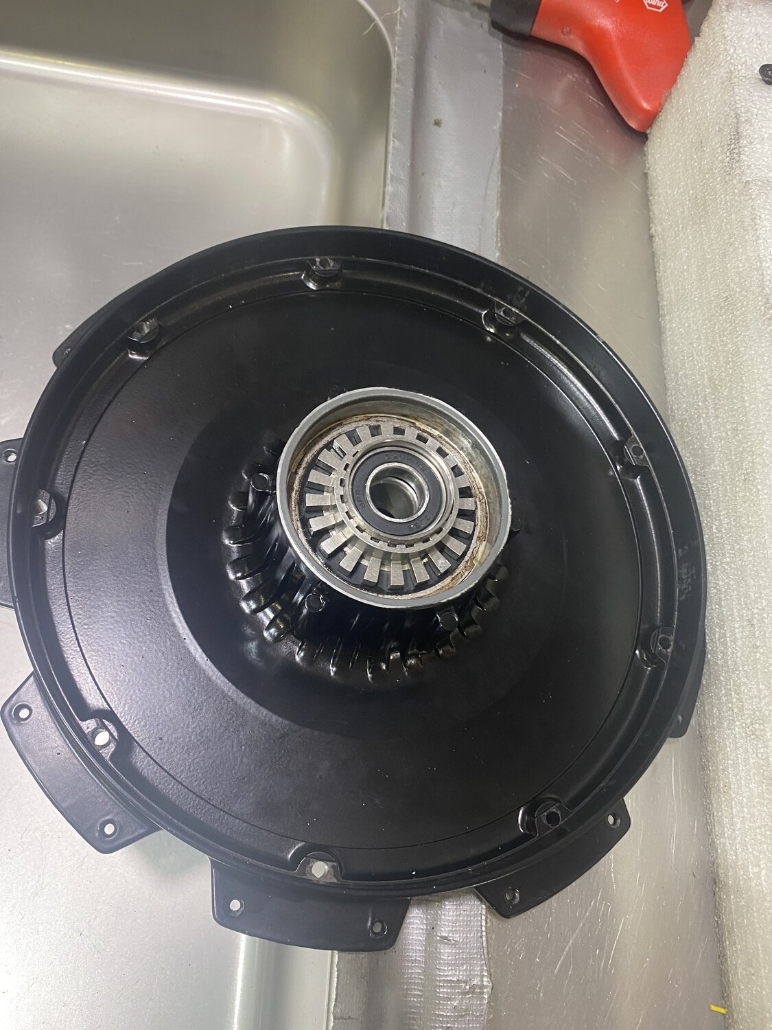

Hi, hope you’re doing well. I have a question about a 2016 “go Swissdrive”. We had to remove the left side cap to re-tap the disk brake rotor. When we closed it back up, it is giving me a strange problem; the motor starts engaging just by pushing the bike a bit forward and will not stop. Could it be the magnets on the side of the freehub? If you have any ideas i would really appreciate the help.
