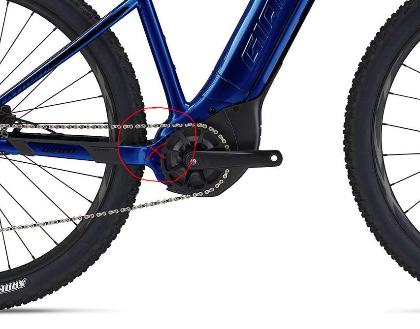

Hi, Newby here, had my first e bike for a month, love it....but I run out of gears (36t chainring) beyond motor assist, so I'm pedalling like a nutter beyond about 20mph, any idea if I can fit chainring off Giant quick e+ (42t). The motor is the synchro sport. Cheers Bob
Have a look at the chainstay - there may not be a lot of room for a bigger chainring.

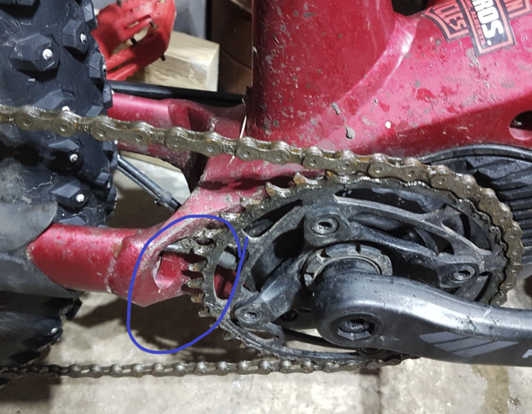

There sure isn't much room on my 2021 E+1 Pro with it's 38T chainring - not sure if you could go any larger.
Drivetrain is sure messy with the winter riding in sloppy, slushy conditions.
I went over to the UK site and took a screen shot (as that model not available here). There MAY be some room there, but not a lot.
I did some googling - and still think it would likely be tight with a 42T.

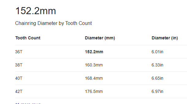

This is from https://www.wolftoothcomponents.com/pages/chainring-diameter-by-tooth-count

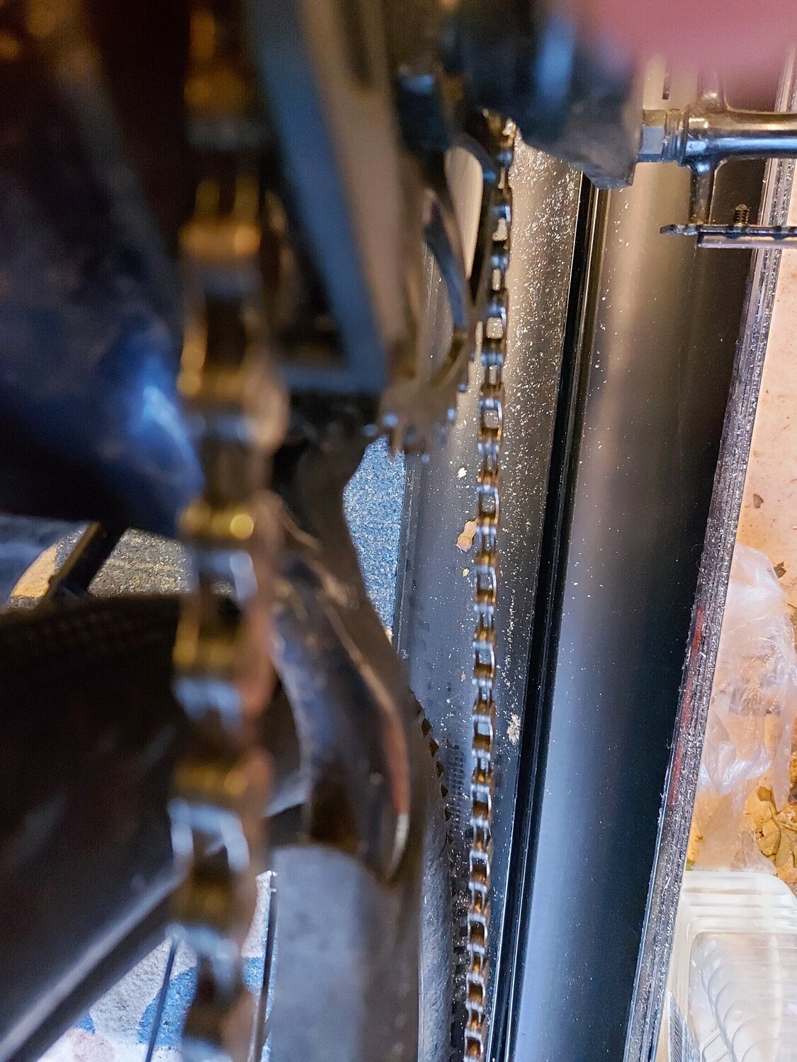

Thanks for feedback, I checked and pretty sure 42 would fit, with 1/4 inch or 6mm gap. Mine has the 36mm nut not the notched nut. I guess this was changed for regular hex. Noted point about not built for fast pavement, however I'm only needing to use top 4 gears, so I rev out. Does anyone know if splines are same on Giant quick e+?
Apologies for poor photo, it's to show distance from frame to chain wheel
