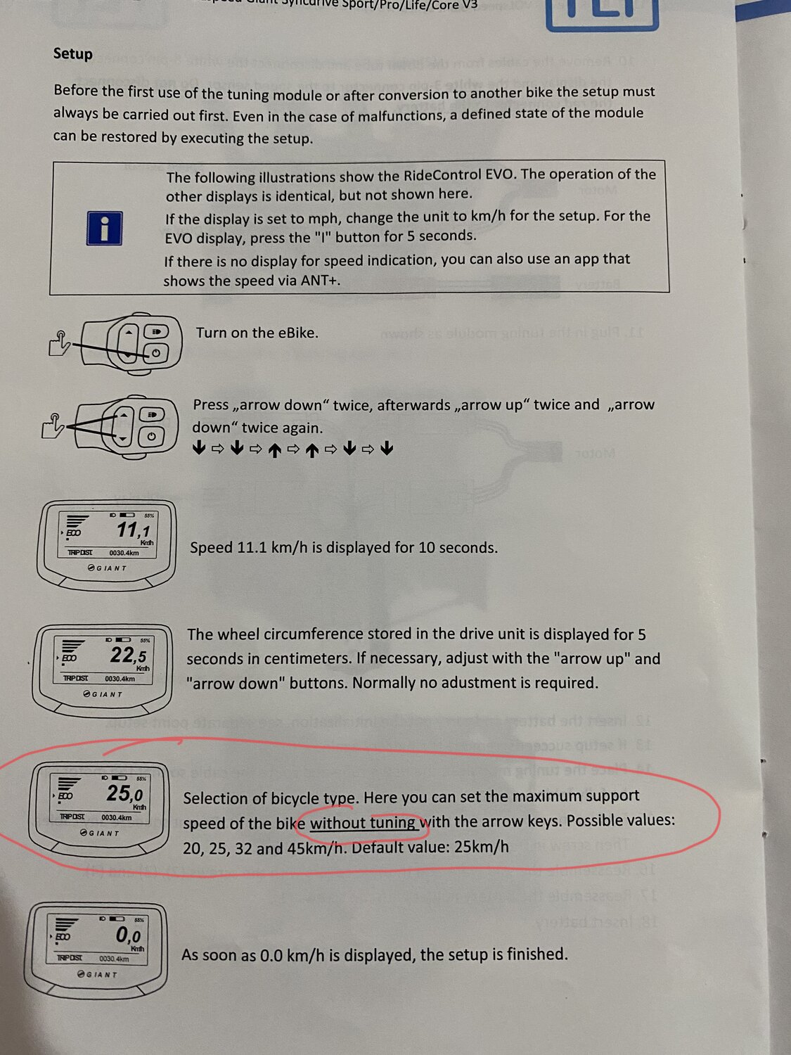

I finally received the Volspeed V3 and installed it this weekend. Unfortunately, I was unable to get it to work. It always cuts out at the 32 km/hr limit. Anyone experiencing any issues with the Explore E+ 4 GTS 2020? The video link supplied in the manual, references the old app which isn't available anymore. I managed to get to the areas in the app for activation similar to the old app, but it simply doesn't go past 32Km/hr.
@pjf93 . I don’t have a VOLspeed yet, but from post #4 and #7 and as per the picture below the setting circled in red is what the speed limit of the bike is from factory. In our case for Canada it must be set at 32km/h. This seems to be where many of the problems originate.
Hi what
Gbart said is correct, mine did this as I had not set it to what my bikes pre defined limit was, so if your bike comes from the factory limited to 32 you need to set the value to 32 . Basically this tells the chip what value to fake to the motor​
@Gbart That was it!! Thanks for the input. It's too bad that there isn't a way of keeping the max speed set at all times without activating it by pressing 'down, up, down, up'
