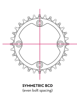

  • Proper Bolt Circle Diameter (BCD). I am almost ready to bet it is 104 mm BCD in your Explore+
  • Number of teeth (it will be 42T in your case I think)
  • Number of bolt holes (I am almost sure it is 4 holes for your Explore+)
The definition of BCD.

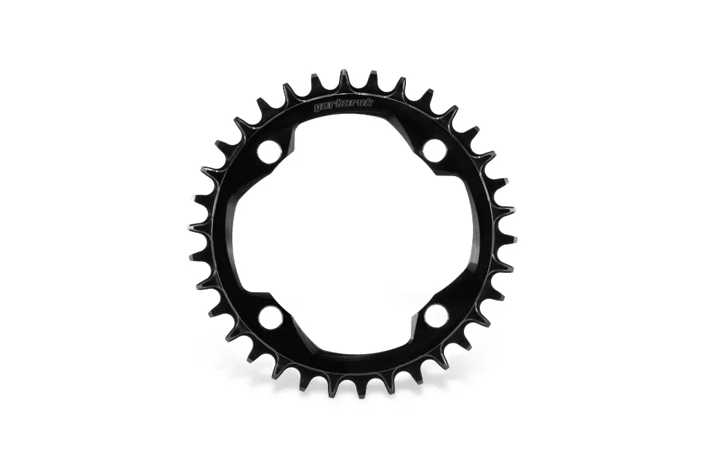

If you look for a good chainring of the parameters matching your old one, look to offerings from Praxis or perhaps Garbaruk.

Can you buy Garbaruk in the United States? I'm a great fan of their chainrings, which are lightweight, durable, and have exceptionally long teeth to keep the chain better. Note: This chainring comes in many tooth number sizes. I'm using a 104 BCD, 42T on my Vado. Note: That chainring is for all speeds from 9 to 12.
They even offer new bolts so you do not need to worry.

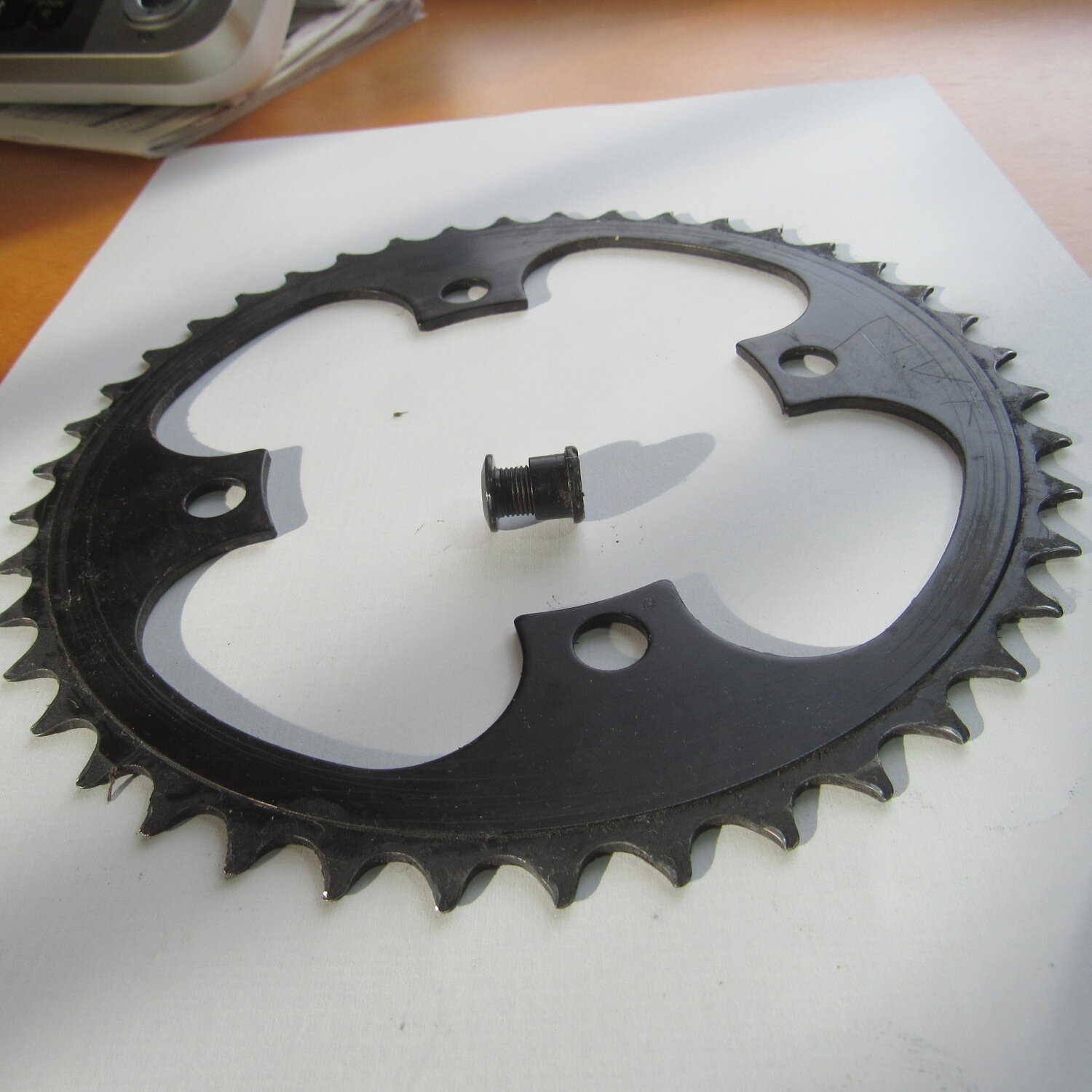

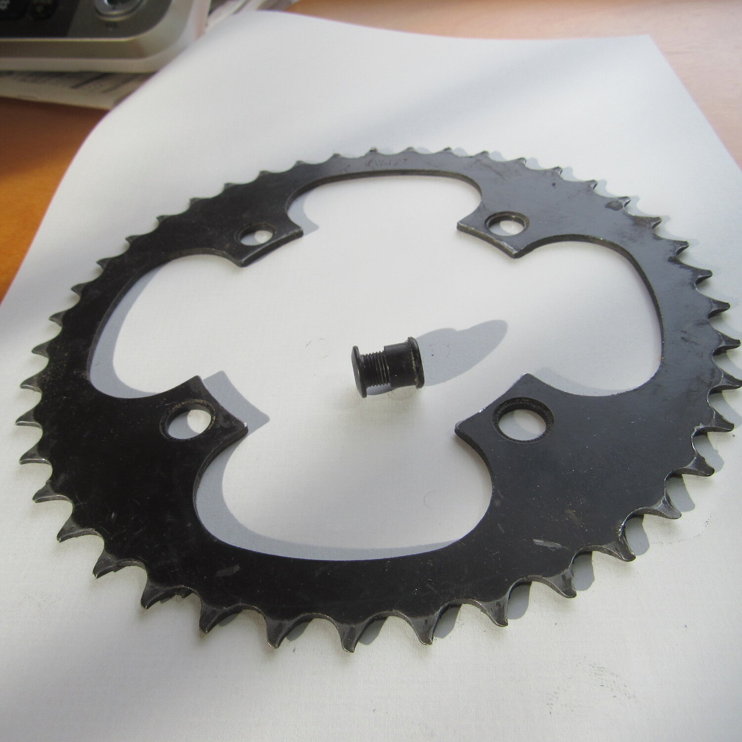

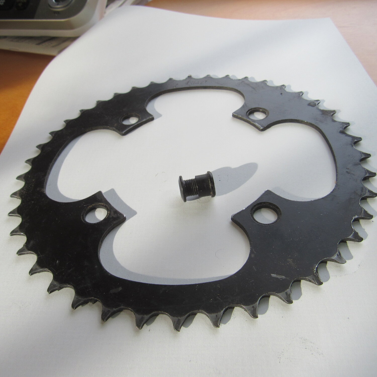

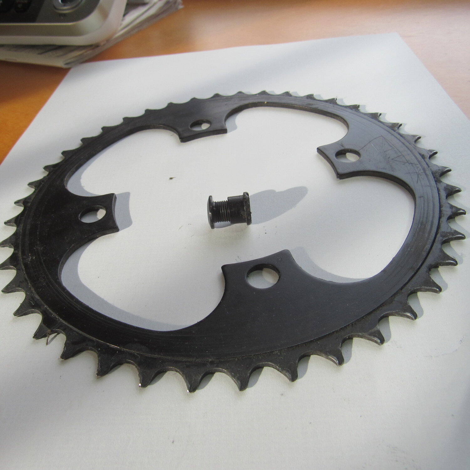

I think you can reverse that ring to use it awhile longer while you look for a replacement. I have done it with Bosch rings.
Thanks Steve, good idea for a spare backup ring. The steel ring is 2mm thick, so I'd better get longer bolts for the thicker "Chinesium" alloy one, probably add 2mm.
