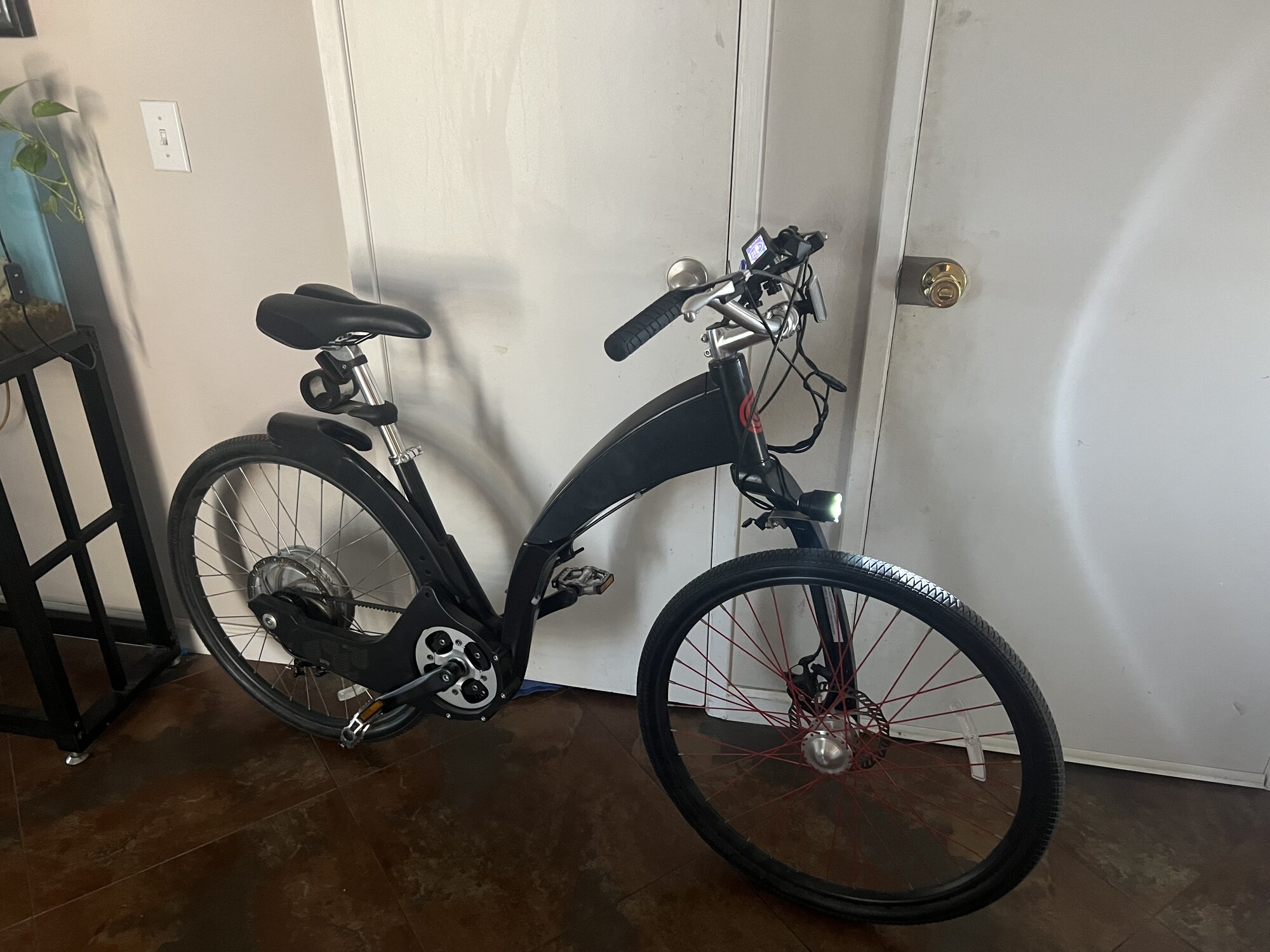

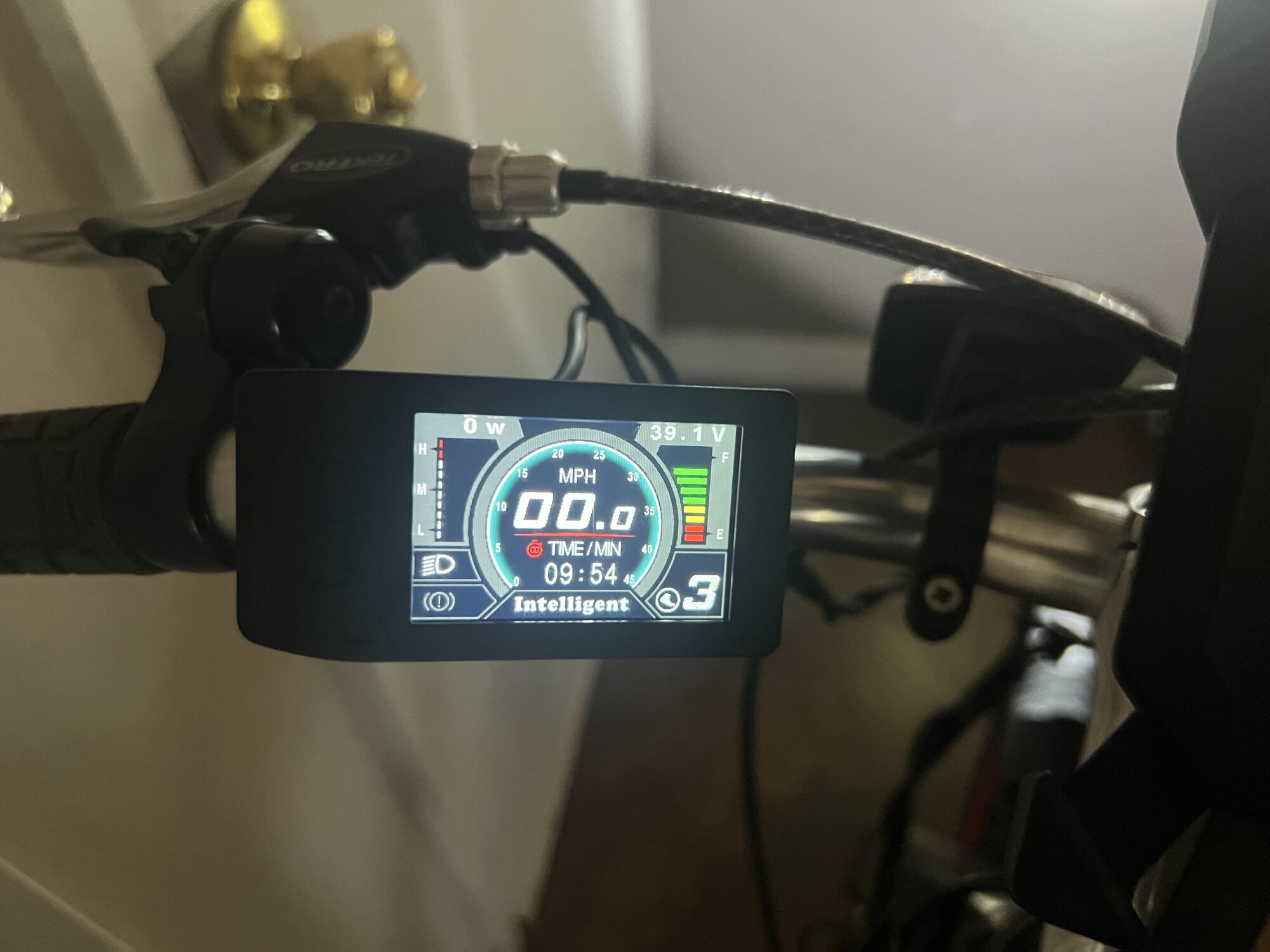

New member here and I just wanted to thank you for helping me revive a Gi flybike that needed repair. Issue was the usb key got really hot to the touch when plugged in and could not access the features/controls due to defunct app. I used your instructions with the 500c display and the 5 pin extension cable and it works great.
