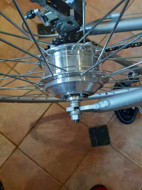

Is the fact that it's quite chubby an indication that it's got gears in.vThe reason I am not sure is because when I bought it I was just told that the motor was toothed
Yes, I would lay odds that it is a geared hub. They are usually smaller in circumference and fatter.

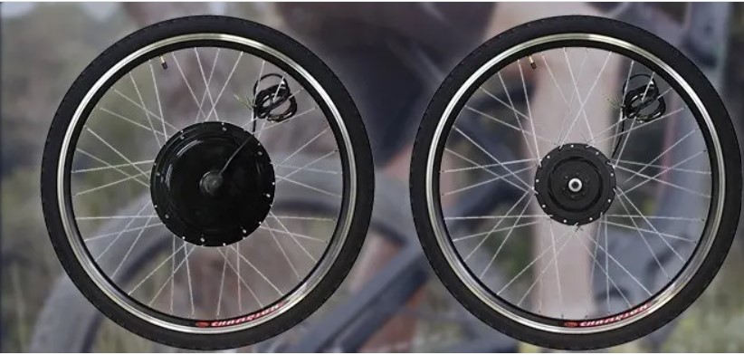

Direct drive on left, geared on right.

True, yes I should have asked about the gearing but the price was very good and he said it was toothed. Anyway, I think we all agree, it is almost definitely a small 36v 250w geared motor. I guess whe I finally power the motor up I should hear a whirring noise when I start peddling which will be coming from the gears turning.

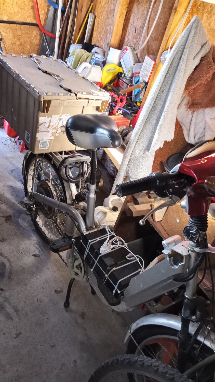

I've got an old 36 volt 250 Watt direct drive ebike. (note the big skinny motor.)
I really like how it regenerates.
If I'm going downhill or coming to a stop I'll pull a brake lever a little bit to activate the regeneration.
I like seeing the voltage shoot up to 42 volts.
I'm getting all that energy back instead of wasting it.
I didn't know about the drag when you are pedaling without assist?
I'll see if I can feel it next time I'm on it.

Actually it's a worn out piece of crap but it's a blast to ride.
It was $400 used about 8 years ago but came with new batteries. (lead acid)
It weighs almost 100 pounds with the batteries. The brakes and front suspension forks are completely shot. The forks move front and back, and side to side more than they move in and out. 😂
The thing is all over the road and has a huge speed wobble as soon as you let go of the handlebars. Then when I load 70 pounds of groceries in the box, it's almost uncontrollable.
That's when it's fun to ride. It really tests your abilities. 😂
It is a fricken tank though, and it just keeps going.
It's from Europe so it's got a 25 kph limiter on it. The power cuts out at 22 kph, then the regeneration kicks in at 25 kph. It doesn't matter how hard you pedal, it won't go any faster. It does charge up the battery though, and that's the part I like.
If I touch the brake just enough to activate the brake switch, then the regeneration kicks in and I see the voltmeter jump up.
I bought a new ebike that I will take much better care of, but it's still fun to hop on the old one and kick the snot out of it. 😂

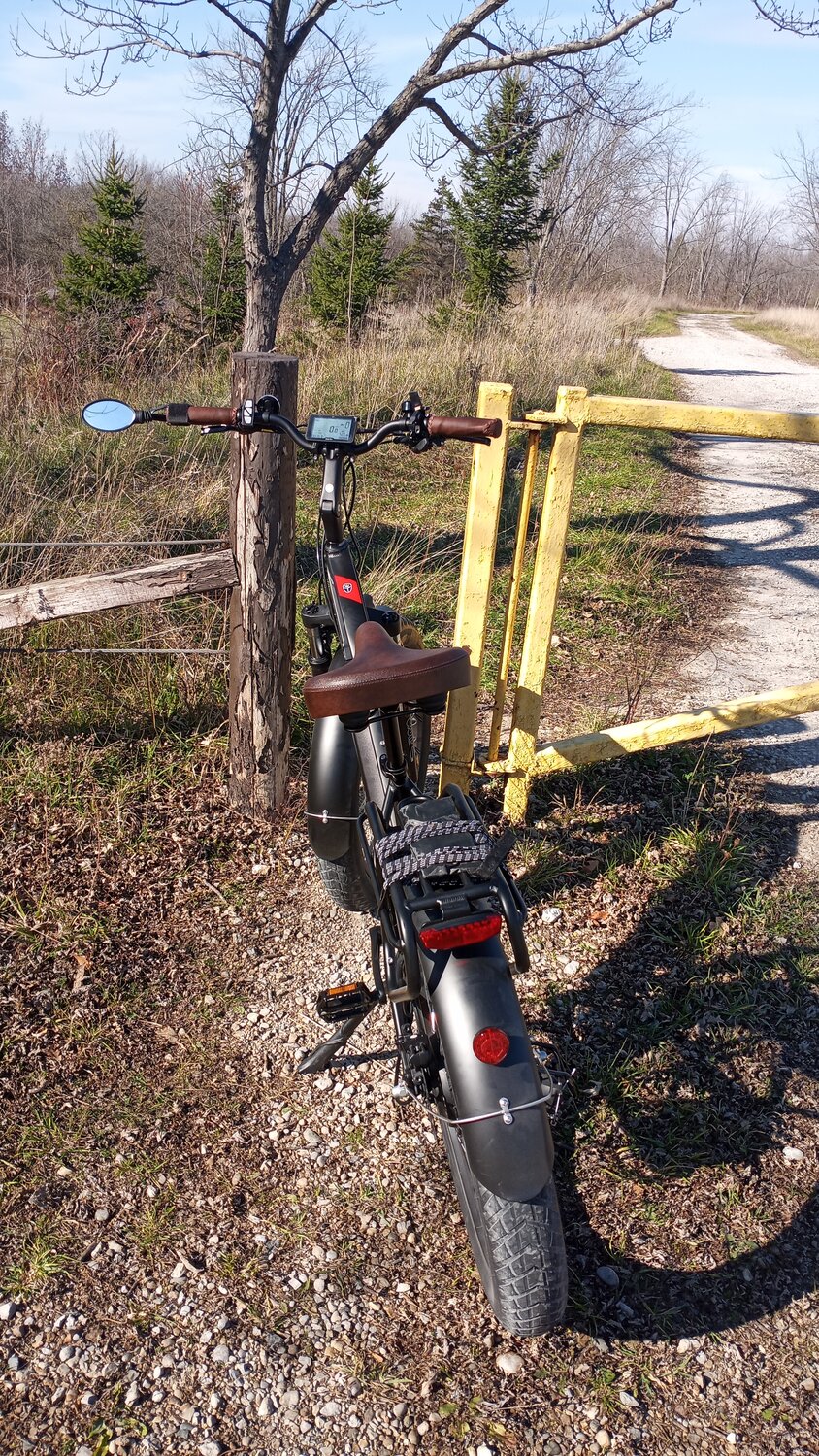

This is my new ebike.
48v 750w rear geared hub motor with a 21ah battery, and another 25ah battery on the way.
