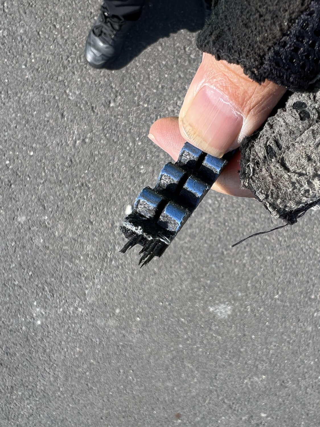

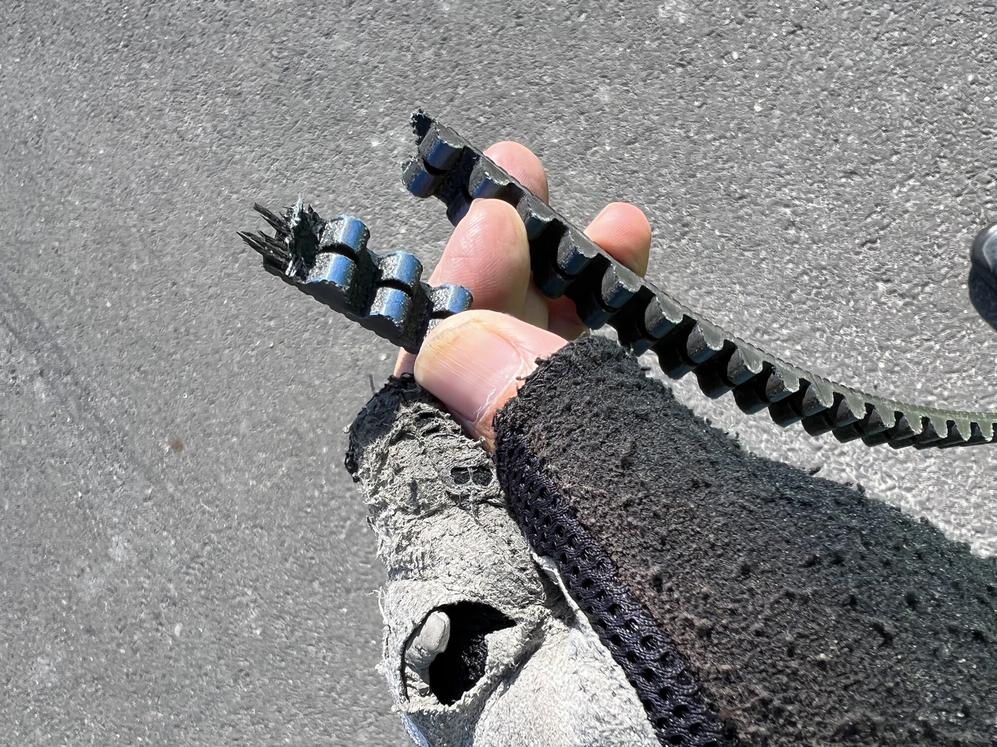

I was hoping it wouldn’t break before 20k miles but managed to snap it in half climbing a steep hill having only done 18k. When it snapped, I was very fortunate not to come off the bike. However, it's so, so much better than the chains that I used to have on my other e-bikes. They normally needed replacing after every couple of thousand miles. There's also a spray they recommend (I bought one from Germany) which is supposed to make the belt to function better and apparently, make it last longer. We'll see.

18,000mi is about twice what these usually last in my experience. While a failure while riding objectively sucks, I'd say you got your money's worth out of that one.
