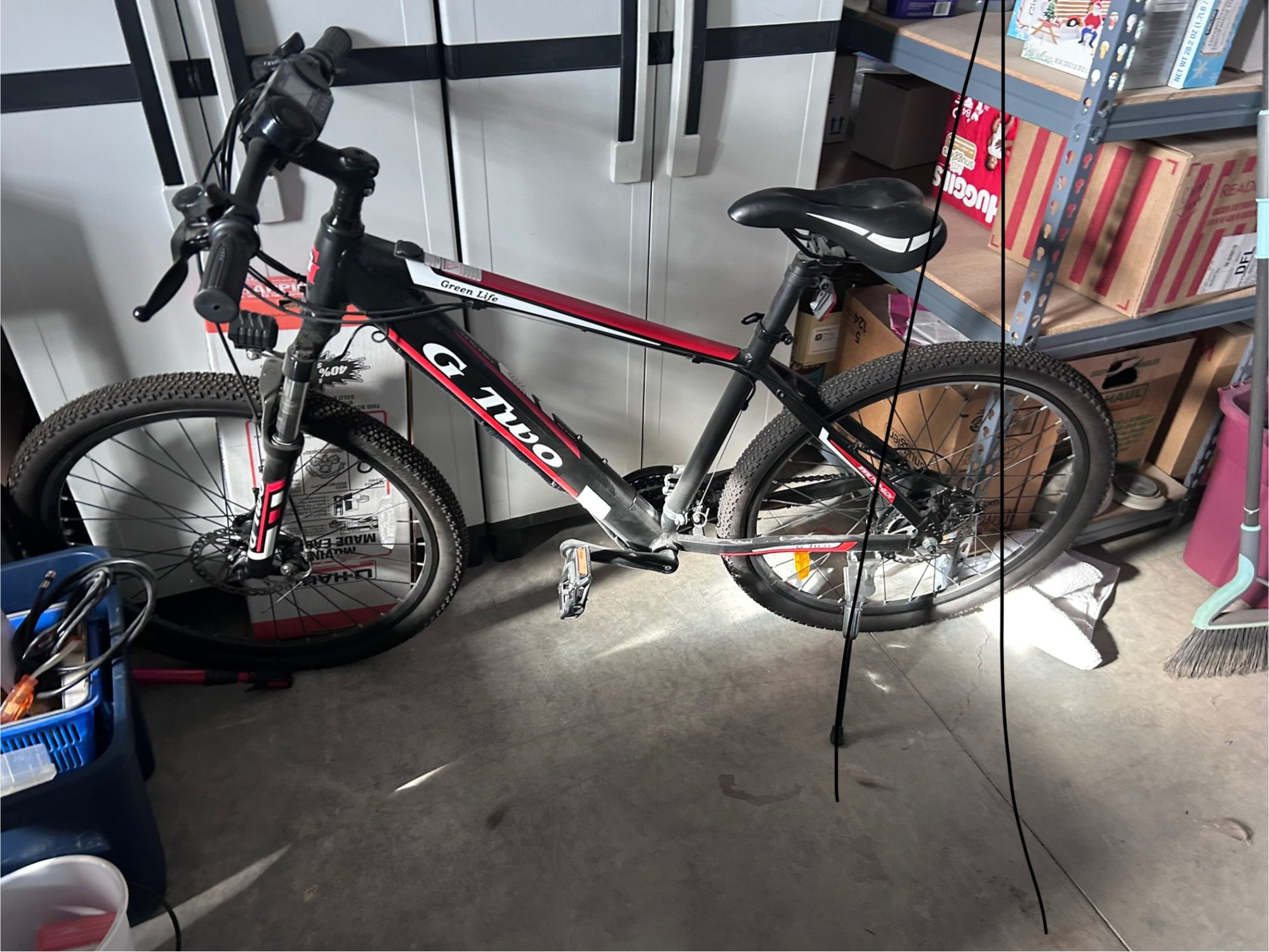

I purchased a G Two bike from a friend. I can not find a manual online. I can not find anything way to call for help. The local bike shop can not find parts. The assist is not working. Anyone know about this bike?
This is my bike. Can anyone help getting a manual and contact to a shop for parts. I live in Montana

No email or phone# found... You can try the webform but my guess is that you are on your own.
Did the bike work when you bought it? If there was a manual, your friend must have gotten one when he bought it?
Most of the inexpensive bikes, you are are your own and there's usually nothing in the documents that help, other than perhaps a manual for the LCD display settings,
The easy fixes are a dead battery, loose connection to display, and loose connection to motor.
I’d like to add a faulty brake sensor. Disconnect the brake sensors and maybe the motor will run?
OP mentioned “assist is not working” does this mean that throttle is working?
If a brake sensor is at fault, then it could be stuck as active and the motor won’t run either way.
Also, a good idea to see if walk mode is working.
Does the display come on at all?
I’m also having trouble with a similar G Two model and didn’t even think to check that. In my case, the display does turn on, but there’s no assist and the throttle doesn’t respond either. I’ll try disconnecting the brake sensors and test walk mode next. Appreciate the tips from everyone here.
If you are not getting power to the display, nothing else will work.
