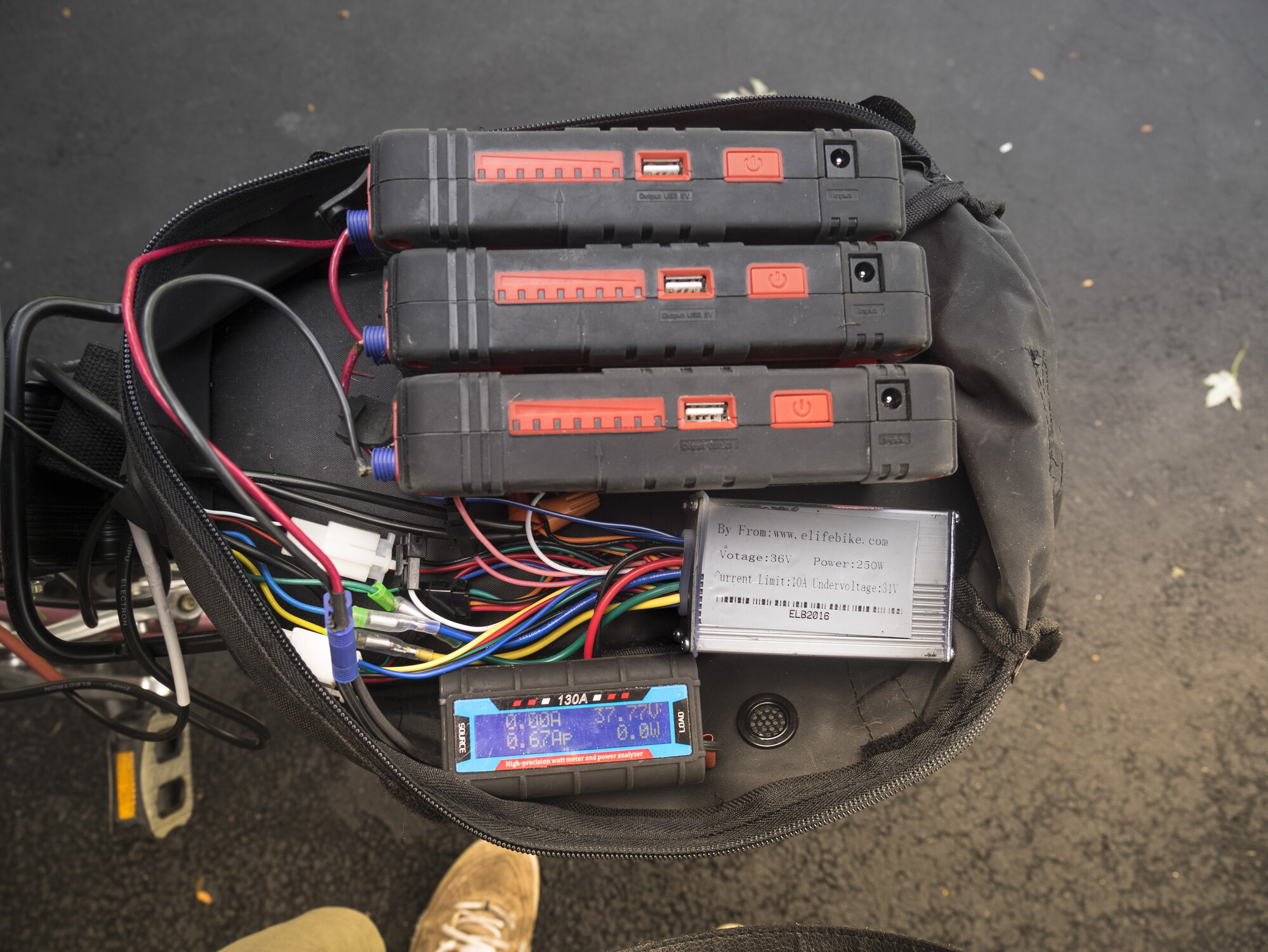

At the time of the review, I had done my third conversion. Batteries were harder to get in 2016. Walmart had these 12V car starter batteries on closeout for $29, They contained a 12V Lipo battery. I bought three, and for $100, I had a relatively safe battery that could run my bike for 15 miles. I think one or two of them could have run the above friction kit. The picture has the three batteies, and the controller in a rear rack bag.
I was so afraid of those Lipo batteries would blow up. I kept them outside. and left them out in the rain. Water killed the controllers, and now they would have blown up. I recycled them.
