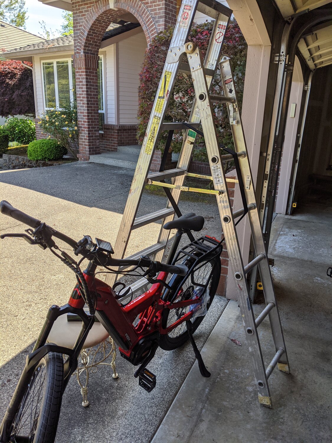

I don't have a bike repair stand and the ones I looked at online seemed like they were only recommended up to 60 lb or so. There are heavier duty stands but seem like you have to attach by the seat post and I'm not so sure how well that works. All I needed to do was lift my rear wheel to clean my chain and relube so I improvised with a ladder in the garage and some velcro strap that came with some exercise equipment for moving. Worked great to lift the rear wheel off the ground and the ladder steps actually provide a nice place to put tools.
Park Tool PCS-9.2 works really well and is rated for 80lbs.
I will mention that any stand if you don't balance the bike correctly, the stand can fall. Also, you should never have the battery in place when working on the bike so that's about 7-8lb you can subtract from the total weight.
I have the Park Tools stand that's the less expensive version of 9.2 and have used it to hold 40-50 lb bikes without issue. It's also rated for 80lbs. I imagine the CC will weigh around 65 lbs without the battery, which is still 15 lbs lighter than the max load.
Hey Tomdav. I just got a Park10.2 and have had my Luna X1 on and off it like 20 times. No problems. I bought 3 bikes felt it was worth the investment.
The thing I like about the pro elite is the quick mount. But for now ladder and velcro strap is working well for my skill set limited to derailer adjustment and chain lube and turning the bike upside down for brake alignment.
