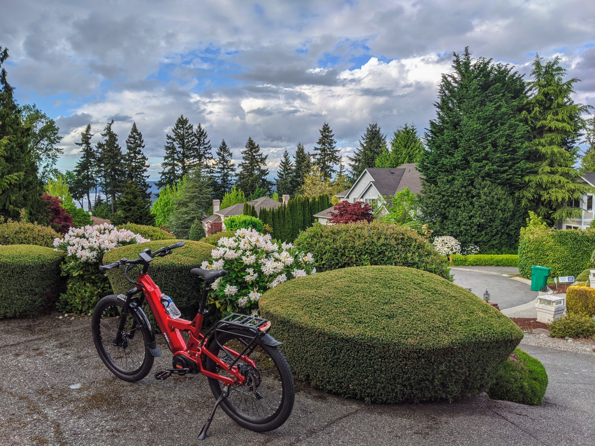

Another ride today. Didn't worry about trying to conserve battery today. Just rode and enjoyed. Fantastic weather and this bike just can't take a bad picture.
Thought I was doing great on battery and decided to put it in sport mode to get home before dark. I got home with only 8% remaining after a 25 mile ride. 20% of the battery was consumed on the killer hill back up to the house which gains 700' in less than a mile. It showed 30% battery before I started up the hill (yeah, I know it's less than 30% as it's not linear). I decided to use it, putting it in sport 5 PAS most of the way.
I think I'd enjoy this bike more if I had gotten a spare and didn't have so much range anxiety. I must express my disappointment with Frey in this regard. I asked about range and they indicated 35-45 miles pedaling in sport mode which I'm just not seeing. I wanted an honest number so I could make an educated decision on whether or not to order a spare. Either they were putting on rose colored glasses or they switched battery suppliers and the cells are not the same quality.

Maybe it was 35-45 miles in sport mode going downhill? :rolleyes:
Thanks, I've gotten a lot of complements. The one person that didn't seem to like it mumbled something about the red being too "bright", haha. I was worried the mid step might give it too much of a ladies bike look, but the beefy tube also gives it a muscle bike look, but not overdone.
For the most part I'd say this bike is a winner. While I've expressed some frustrations with the CC, no bike is perfect. There isn't really anything else out there like it that ticks so many boxes (mid step, full suspension with rack, powerful mid-drive, quality components, reasonably priced) and that's ultimately why I bought it.

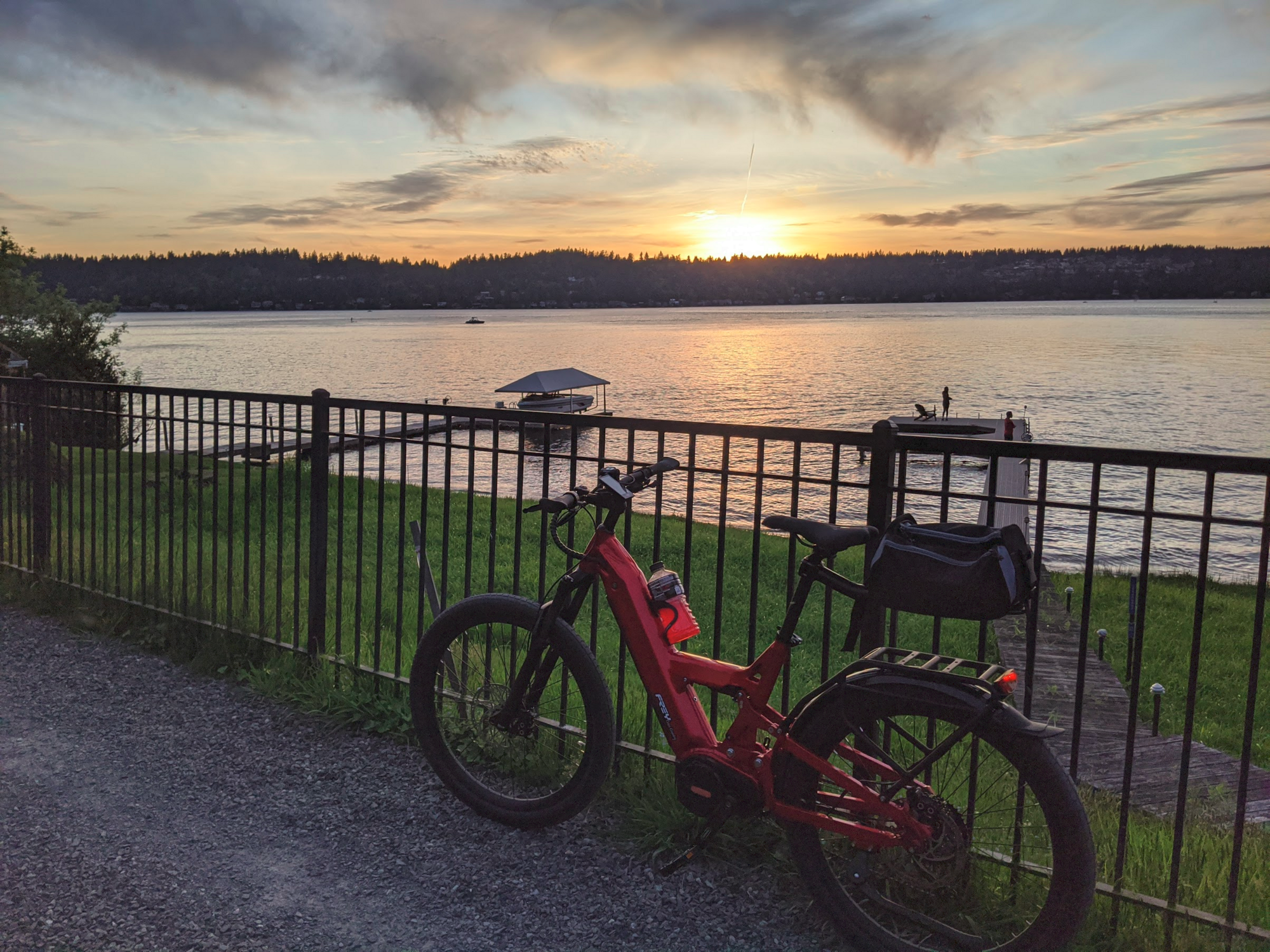

Another fun ride today. This bike just loves to go fast. I usually leave it in Eco mode, PAS 1 and before I know it I'm cruising at 20mph+ on flats. I think this bike would make for a great commuter. It just feels so stable at speed and gets you to places in a hurry if you want, with the suspension soaking up the bumps.
I've been using a seatpost rack/bag as I don't have a panniers (or a proper bag) for the rear rack yet. I actually like this combination so may keep it. The seatpost rack has enough clearance that it doesn't bottom out on bumps, and works great to carry fragile items. I think I just throw panniers on the rear rack to carry heavy items.
