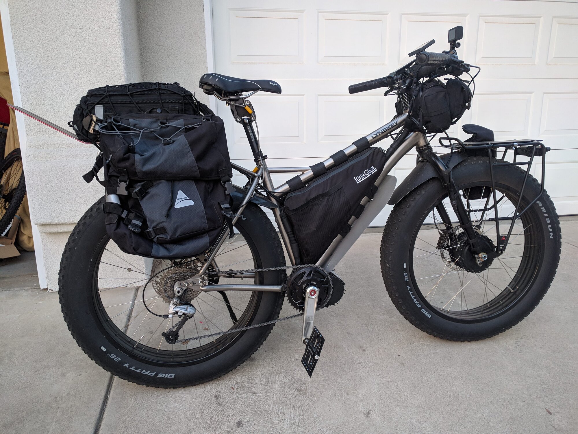

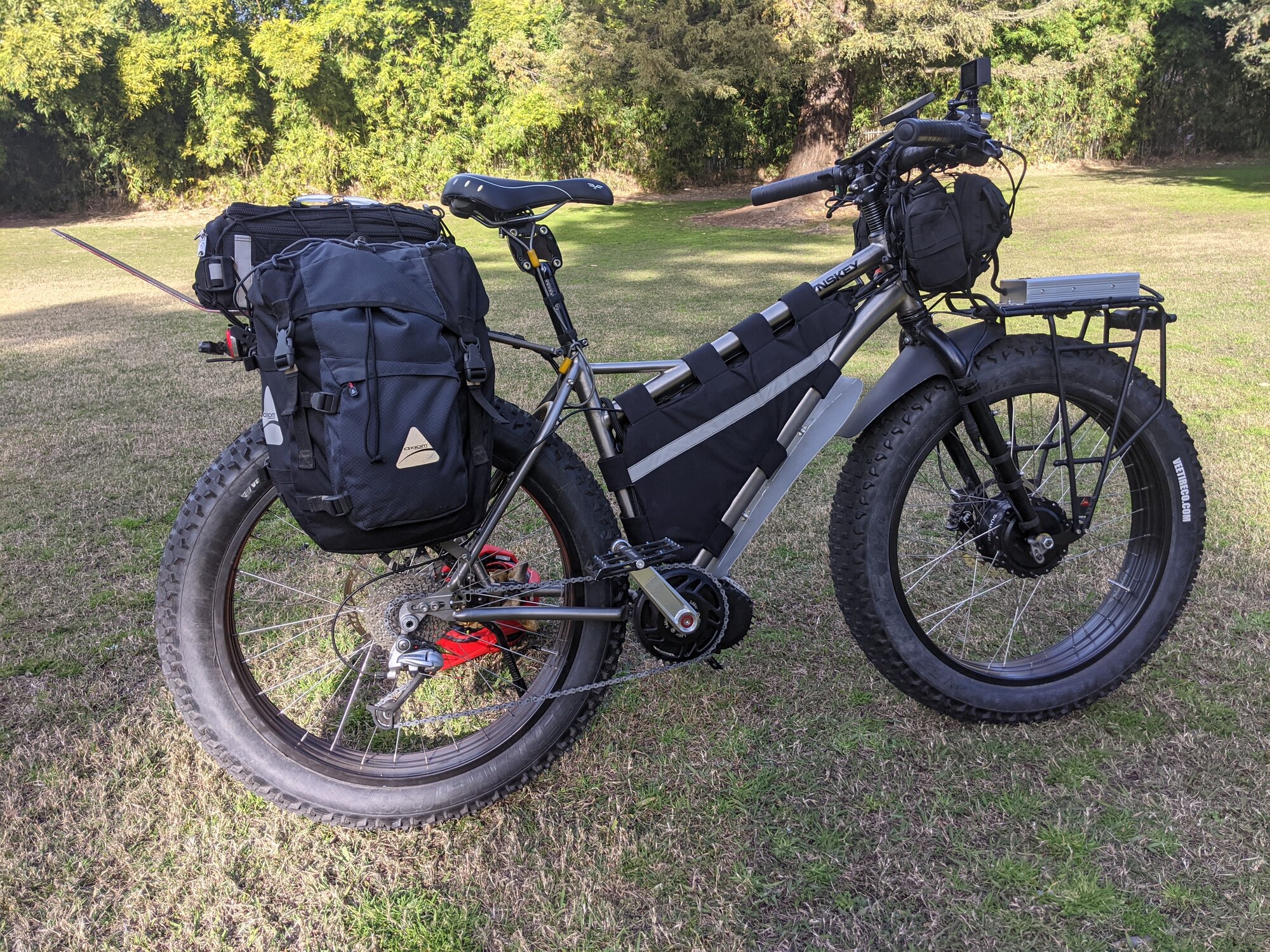

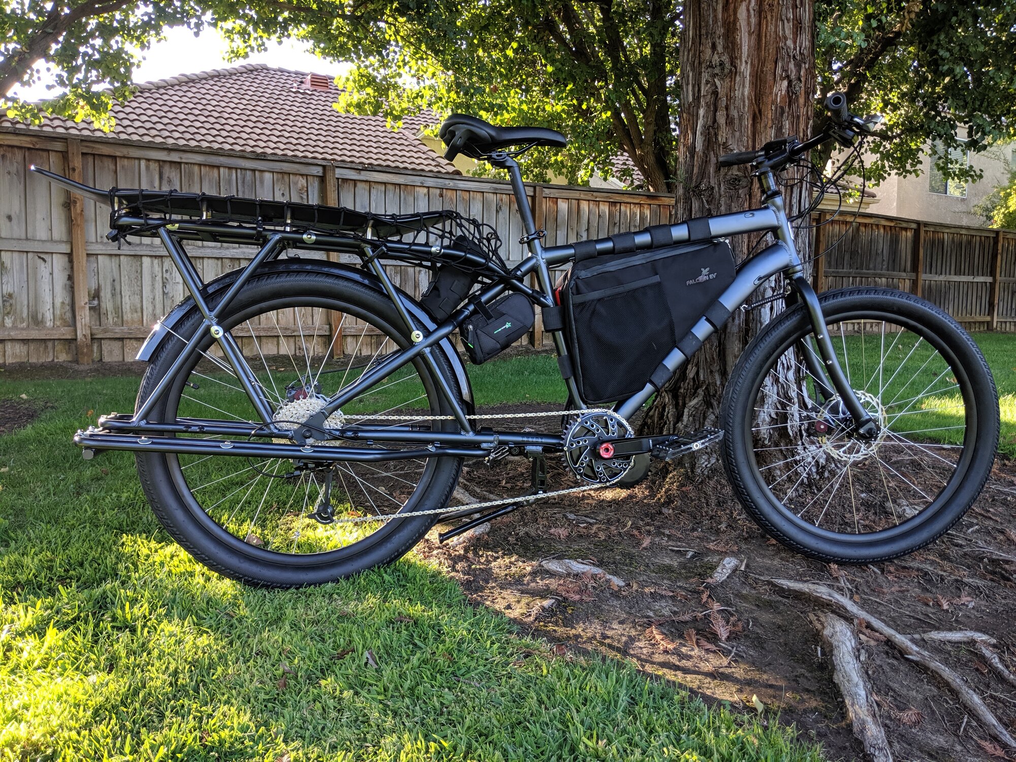

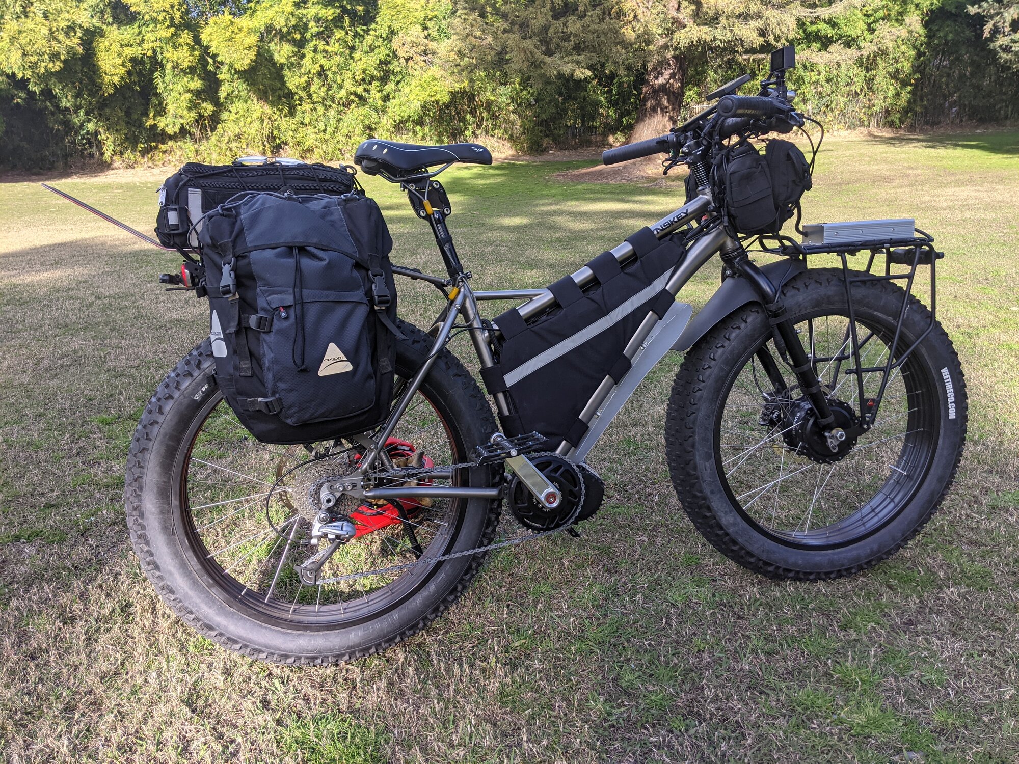

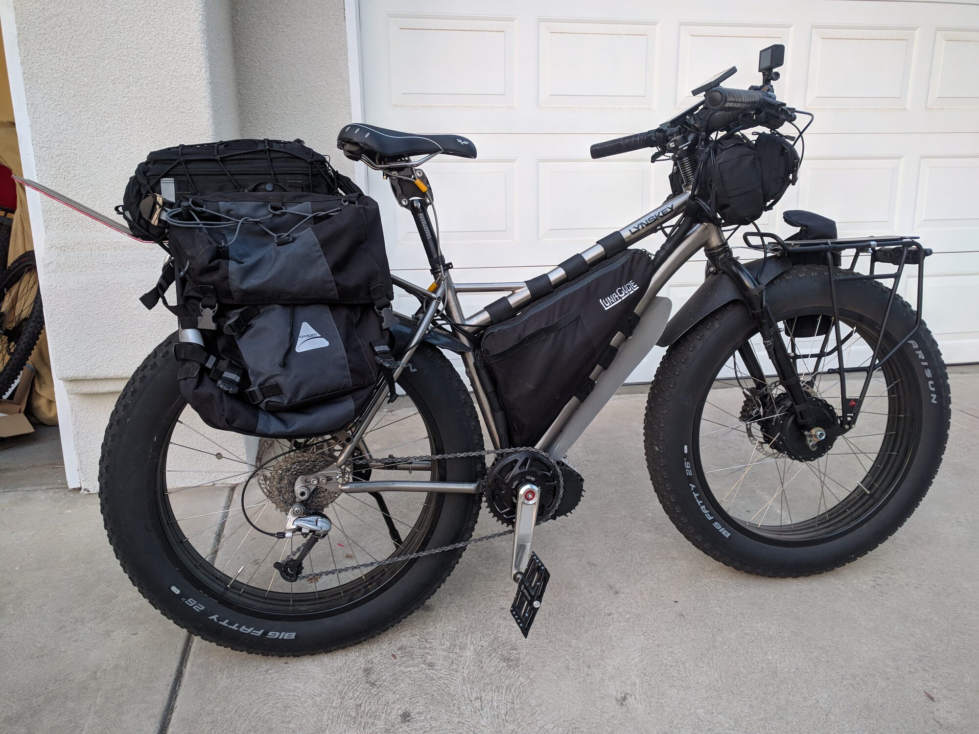

A few options I have used:
Luna Cycle sells a cheap cordura bag that is well-durable. In particular the zippers survive over the long term. I have only used the velcro version. there is a separate zip tie version with no straps. A black Sharpie over the embroidered logo will dial down the advertising volume. $35
Bigger than the Luna bag, the Falcon EV triangle bag is an old-school battery bag that has been around for many years. Its super durable and large. So large I have only been able to use it on my larger frames (my bike frame size tends to be L or XL). Quality is very high throughout. Once again a Sharpie will turn down the volume on the logo. $60
All of my triangle bags have gone over to this vendor: Uraltour. This is just a guy deep in the middle of Russia who will sew you a bag using thick cordura and tough zippers - precisely to your specifications, including spacing out the velcro straps so they miss your frame bosses and whatnot. For a whole $30 plus postal costs. I have four of them now with the first being over two years old. Being in Russia and shipping via the Russian postal service, its going to take 2-3 months to get to you. But if you can wait, the value for the dollar/ruble is absolutely unbeatable.

Not trying to take away from some very nice and neat builds... 👍
But as you say these have been around for years and are examples are of actual battery bags.. bags made for the purpose of carrying and concealment of batteries. I was trying to highlight the use of the standard frame storage bag for this purpose or other electrical management.
I believe I've had all available bags listed as triangle battery bags. My two Luna bags had failed zippers and I found the stiffeners sewn in were cardboard. Once wet they warped and shrunk and the seams were poorly constructed and failed. I sold the two EM3ev bags to Luna and they essentially replicated the EM3ev bags but were more cheaply made. In 2016 there were lots of failed zippers and actually instructions on how not to stress the zipper to prevent failures. LOTS of complaints and returns. The Falcon EV has been very durable but one of the velcro straps did separate but can be easily repaired. The EM3ev bag is nice and supplied with nylon-wrapped padding. The material is not rolled at the sewn seams so the edges can fray and separate. The ElectricRider bags were by far the most durable and had nicely designed wire ports in several locations for convenience. Sadly they are no longer in business.
I found that crank forward, flat foot bikes have a longer wheelbase, and mounting a battery on the rear rack doesn't seem to make the bikes feel "tippy" as on my "normal" frames. I found Crystalyte rack bags to be incredibly well designed. Finding them for sale can be elusive.
