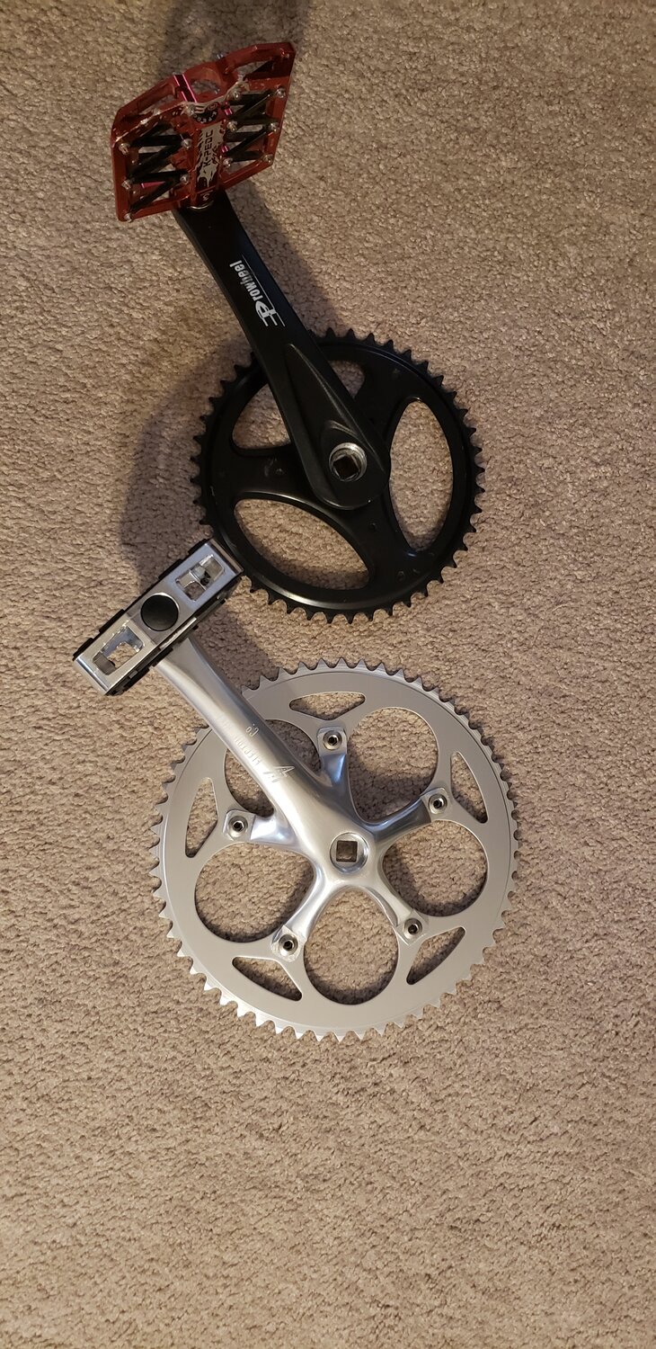

Cheers to my fellow Cheetah owners. My latest project revolves around swapping out the standard 44-tooth x 3/32" chain ring for a larger 54-tooth ring. After some research, I have discovered the vast array of chain sizes and crank configurations. Have any of you found a quick remove and replace solution to this swap?

With both crank sets laying on a flat surface (new & original) check the spacing of the crank arm to chainring. I found a big difference here. There may not be enough space for the chain guard if you use it and the alignment of the chain to the center cog may be off.
You may be able to move the chainring to the opposite side of the crank arm mount.

I've finally mounted my 56T Alloy Chainring on the Cheetah and the first test ride was simply amazing! I can crank it up to 32mph in 7th with the throttle pinned out of the seat cranking on flat ground and
still have the bottom end to climb some fairly good inclines with my moto-head mountain bike buddies!! I have not added any additional chain yet so there is much less chain flop
when traversing bumpy terrain. I'm much too old to moto with these younger guys with this 75lbs cruiser bike but they were all blown away that I could hang with them for as long as I did.
I think it looks bitchen. The object of this mod is not to achieve Bonneville top speeds but to slow the spin in top gear as I really just enjoy an easy relaxing time cruising the coast with this very heavy e-bike.

Great information! Thanks for the specs and ordering information. Does it take any special tools to install? Did you have to move the chainring to the other side of the crank as previously suggested?
Is modifying the chain guard to fit a possibility or chainring simply too large?

Hey there fellow cruiser, It takes a crank puller that threads into the crank assembly and then you turn the blue handle to push the crank arms off the bottom bracket very cool tool!

The chainring comes mounted on the correct side. I may fab a chain guide but for now it looks so “bobber bitchen” without one.

After the installation of the suspension fork and reassembly, I took her for a quick test ride in the middle school parking lot and was not able to wind her back up to the previous 32mph. Very disappointed, I returned to the garage, completely tore down the bike, repacked bearings, reinstalled the old rigid fork tubes, aired up the tires to a very hard 35psi., rode back to the parking lot and again could only muster a 26.5mph run. Bummed out!! My daughter suggested I reinstall my forks, load the bikes into the truck and return to the exact spot where we attained the top speed run. Looking back, I hadn’t realized this huge parking lot is at a slight downward slant allowing the bike to again hit the 31.5mph top end. So in conclusion, the larger front crank set will not increase the top end speed on flat ground but will allow a slower crank speed in 7th. gear cruising on the flats. May be looking forward to a 1500watt rear hub drive conversion...!
