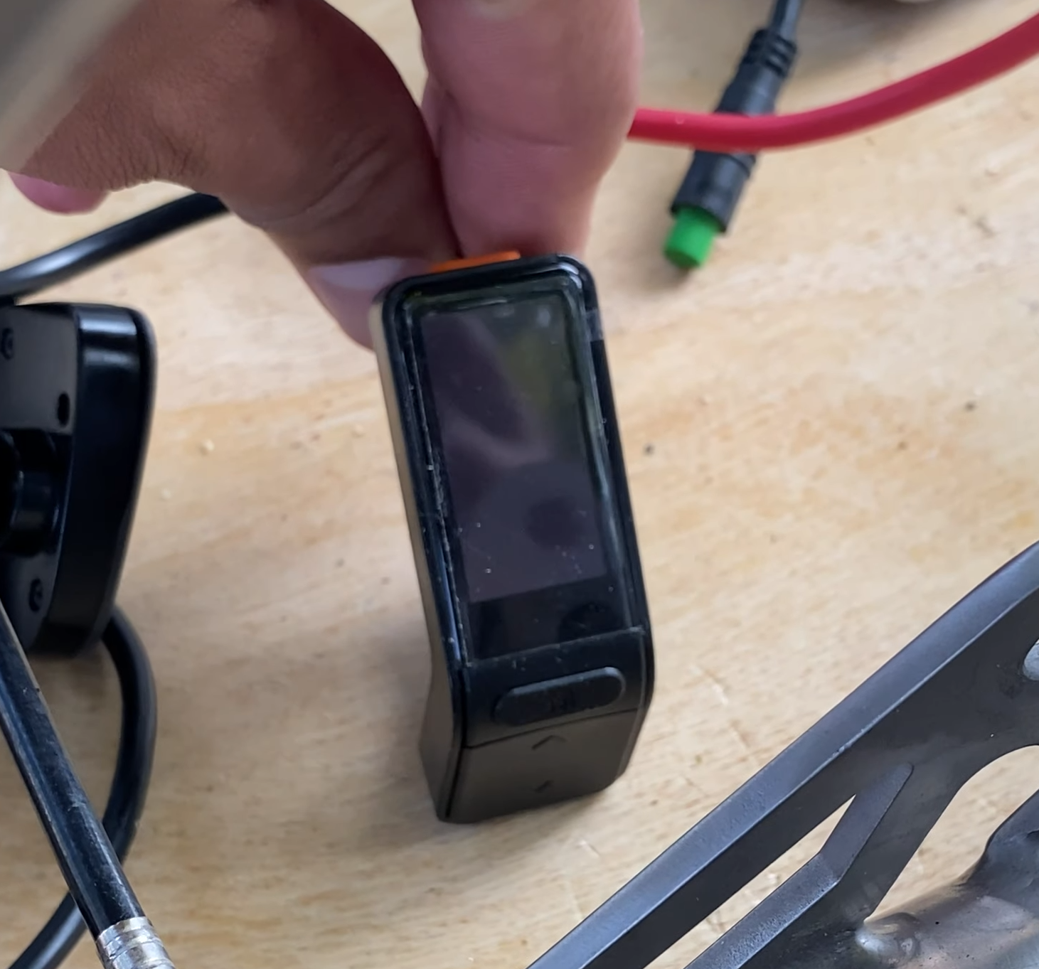

Do you have picture of the new display coming with it, your website says next month ?
I think it was the Eggrider he put next to the Bafang display. But the Eggrider will come with custom firmware.
The small display has BLE. We will just have an app as display to go with it. App is in development. Hoping for q1 2021 for that.
