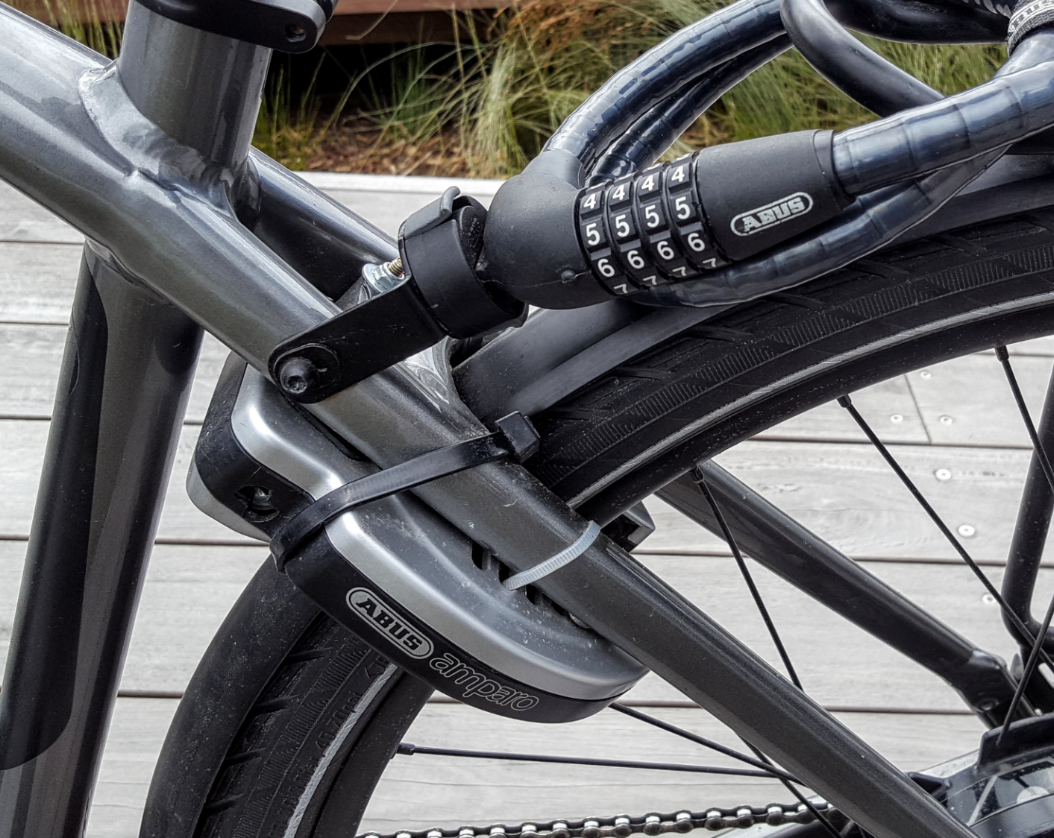

Hi @Jan Hermanson nice to hear your story. I am interested in how you installed you Abus lock. I have the same model. The LBS and I struggled for some while to get it mounted and in the end had to strap it on with cable ties which looks a bit messy. Any tips or was yours easy to mount?

Hi @Jan Hermanson nice to hear your story. I am interested in how you installed you Abus lock. I have the same model. The LBS and I struggled for some while to get it mounted and in the end had to strap it on with cable ties which looks a bit messy. Any tips or was yours easy to mount?View attachment 10475
bazzapage, I noticed that the frame distance on the Turbo was wider than on my old Scott bike where I previously had the lock mounted. (I think the end part of the frame is similar on both X ans S). So what I had to do was to first remove the plastic covering on the lock and measure how much I had to widen the attachement holes on the lock. After some drilling and grinding I was able to extend these holes such that it was possible to get the screws in place. It took a while as the metal was hard (its supposed to be!) and it was awkward to reach with the drill. But it is possible.
