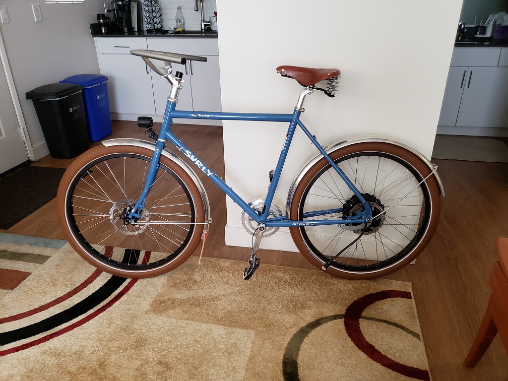

Got the bike delivered last Tuesday and took my time assembling and checking and double checking whilst studying and researching how components work - still much to learn plus safety first . I am still yet to ride my bike though LOL. All I need now is a swept back handlebar.

It looks great. You definitely need to take it for a spin. Everyone has different tastes on handlebars. I have the Jones Loop bar that has a slight rise to it (SG 2.5) on one of my bikes that I like a lot.
is that a GMAC? 😲
It is. I didn't want a clutchless motor, but I liked the idea of the integrated torque arm and 10mm axle (so I wouldn't have to file the dropouts). I asked Grin about adding a clutch when they first came out and Justin offered me one of the prototypes that had a clutch.
oh nice.
What battery and controller will you be using?
Phaserunner with a CA3. The battery is a Jumbo Shark 14s5p from EM3EV. I bought these a couple of years ago. I think they are offering the Baserunner with the kit now.
ah okay I see, cool.
yeah I was wondering if you're going with Grin 72V (which probably is a bit overkill) and whether you went with the baserunner of phaserunner.
The Baserunner will give you cleaner look but it's not as good as Phaserunner performance wise so I was just wondering.
72V would be overkill for sure. I don't ride fast at all and the bike has no suspension.
Quick question if I may, when in gears 1 or 2 and maybe 3 a little, the bike being upside down and me spinning the crank by hand while indexing and checking limits and such. I noticed in the above gears ( 2-3 largest cogs ) the main chainring gets noisy. Initially I thought it was the crank case area, but spinning the crank with no chain is almost silent.
What would cause the chain ring to be noisy when in the largest cogs?
It is hard to tell without looking at it, but I would guess that it is the chainline. The chainring will line up closest with one of the cogs in the back and when in that gear the chain will be in the same plane as the chainring and the rear cog. When in other gears the chain will be at an angle and there will be some rubbing/noise. Since on an electric bike you more likely to use the higher gears, the manufacturer may have optimized the chainline for those gears and the chain is at an angle for the lower gears. It is probably nothing to be concerned about. However, the chainline can be adjusted by changing the bottom bracket to a narrower one to bring the chainring closer to the lower gears (assuming that you don't have a mid-drive motor and that it doesn't cause the chainring to rub on the chainstay).
