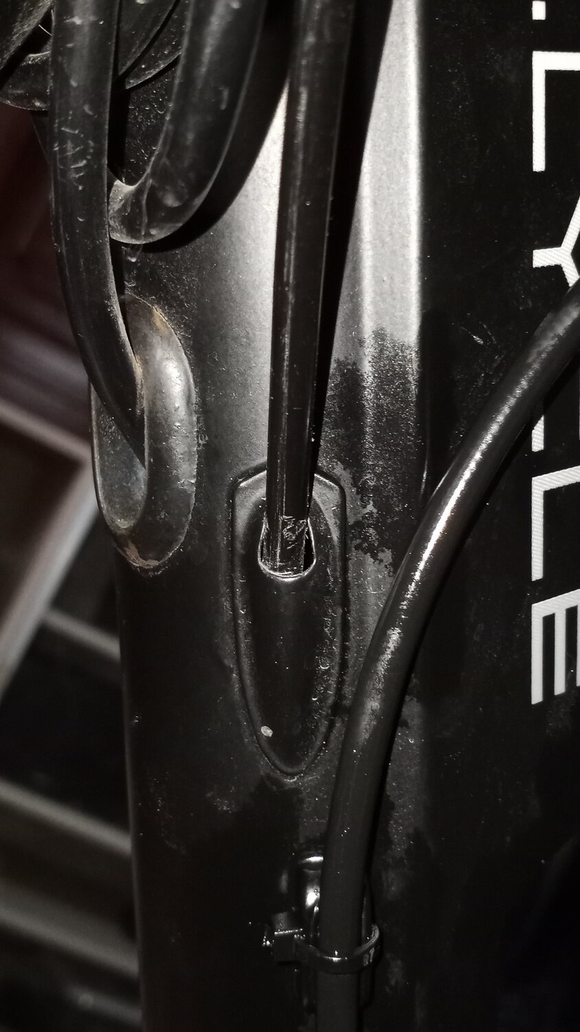

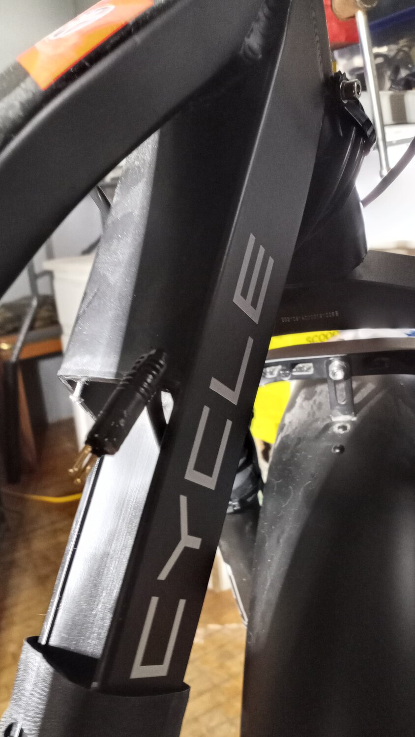

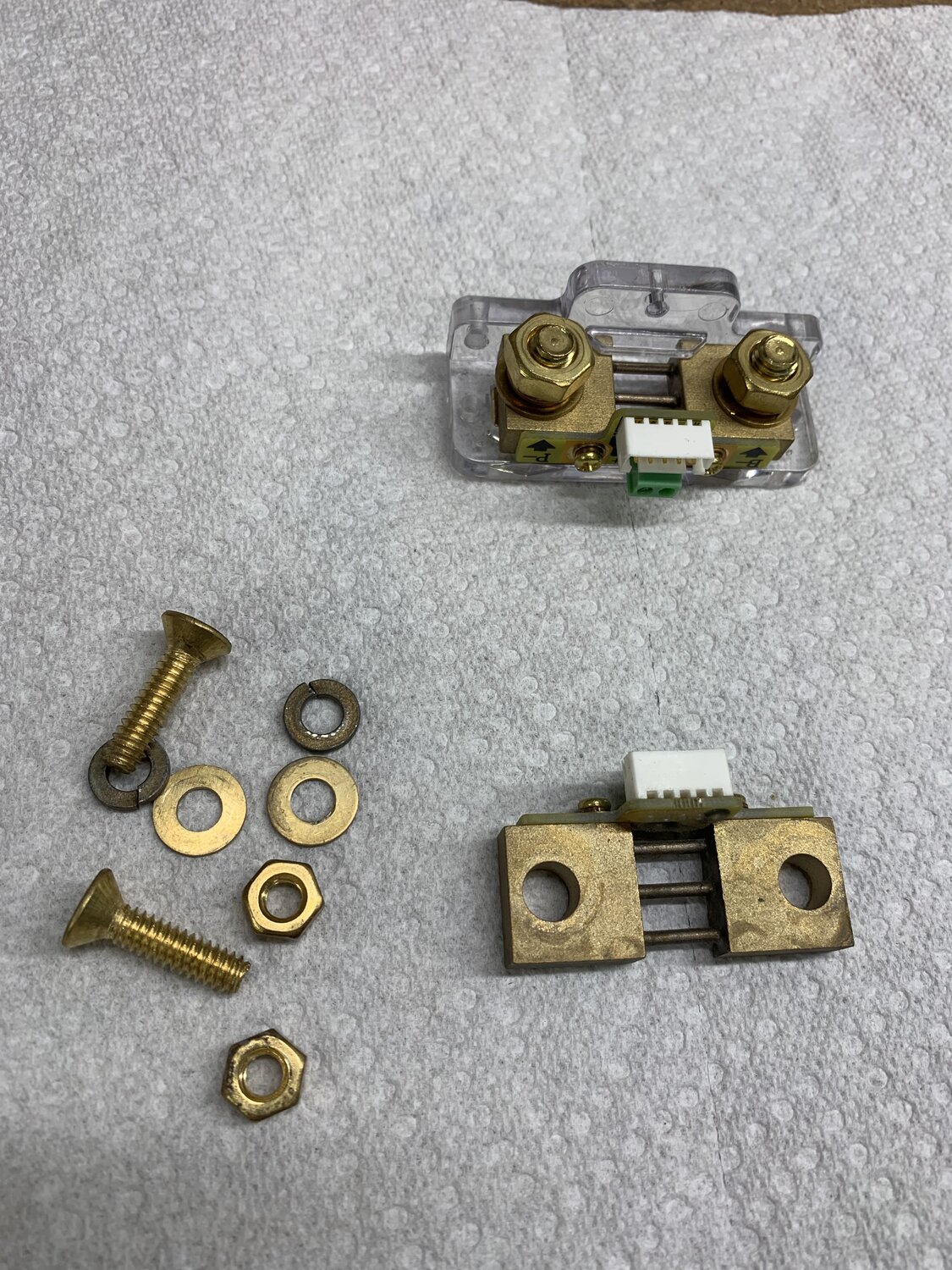

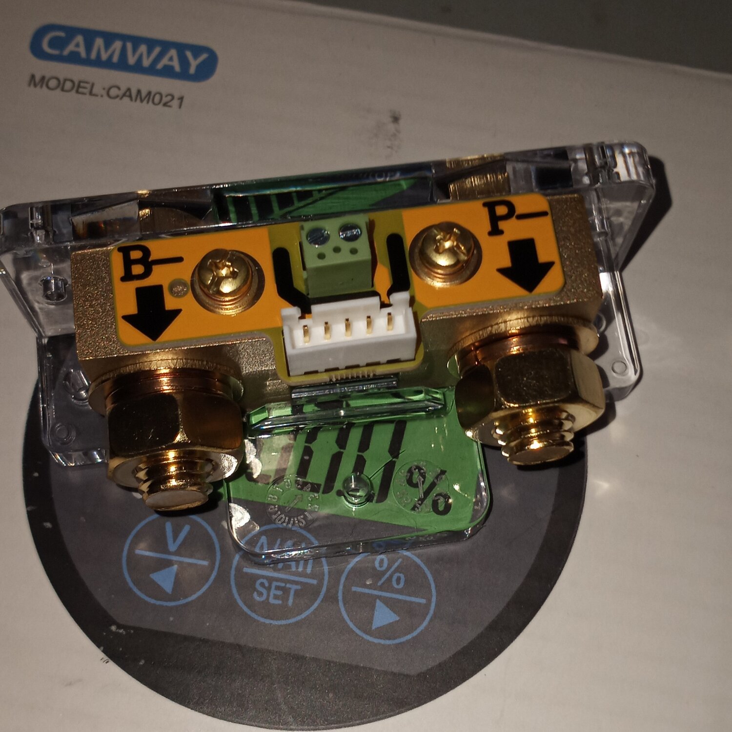

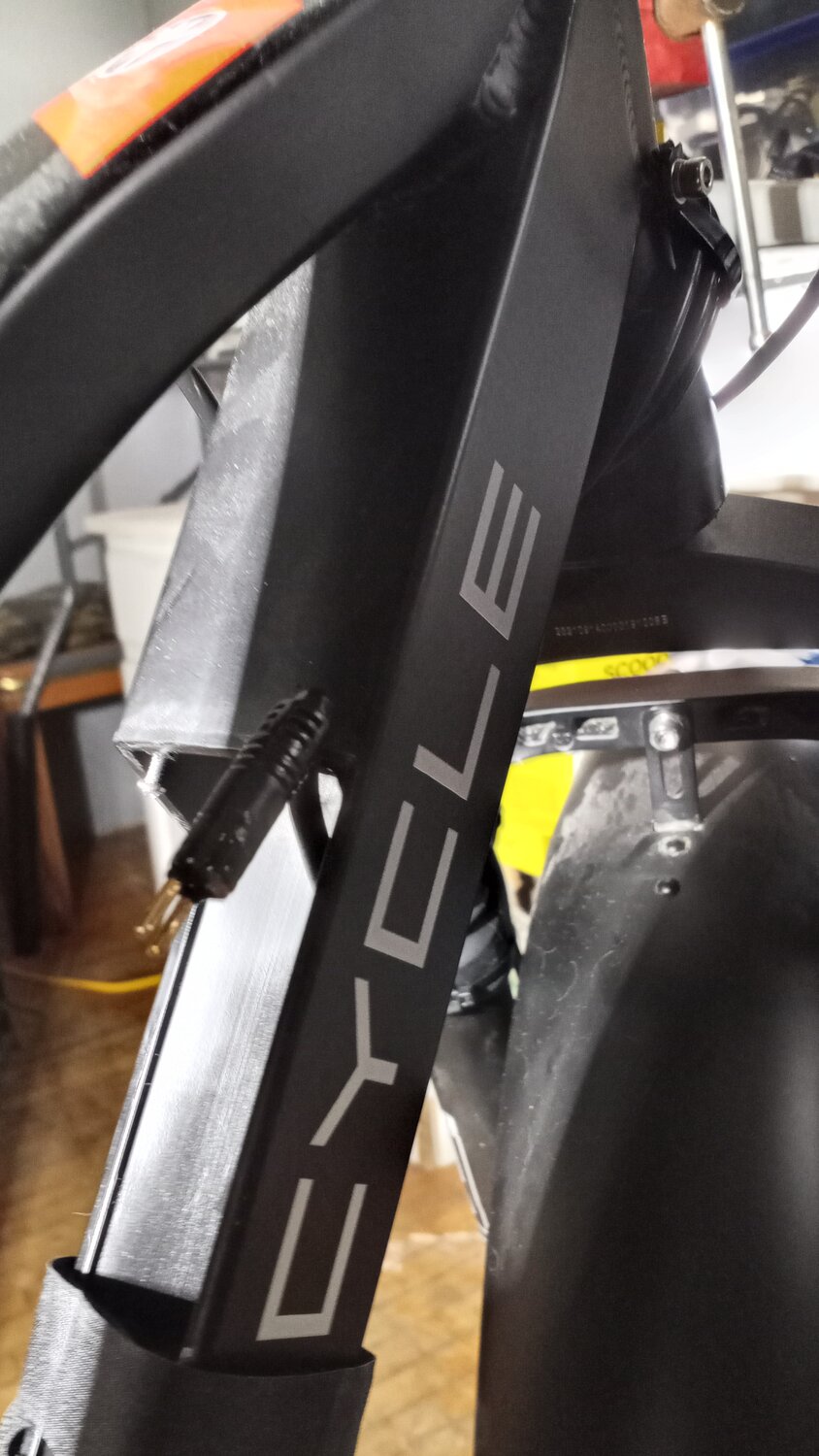

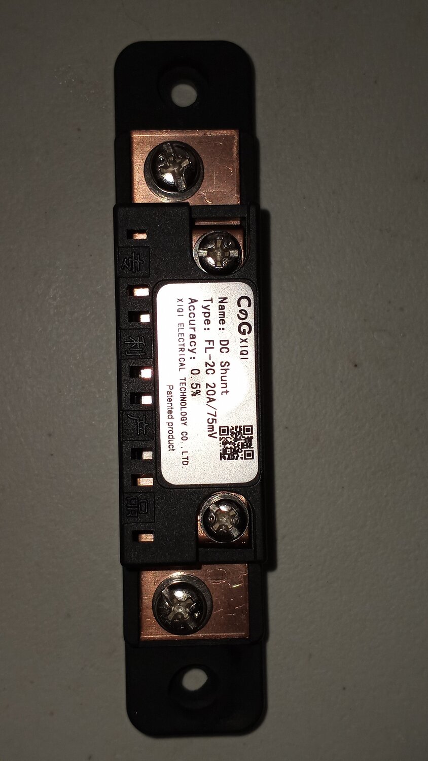

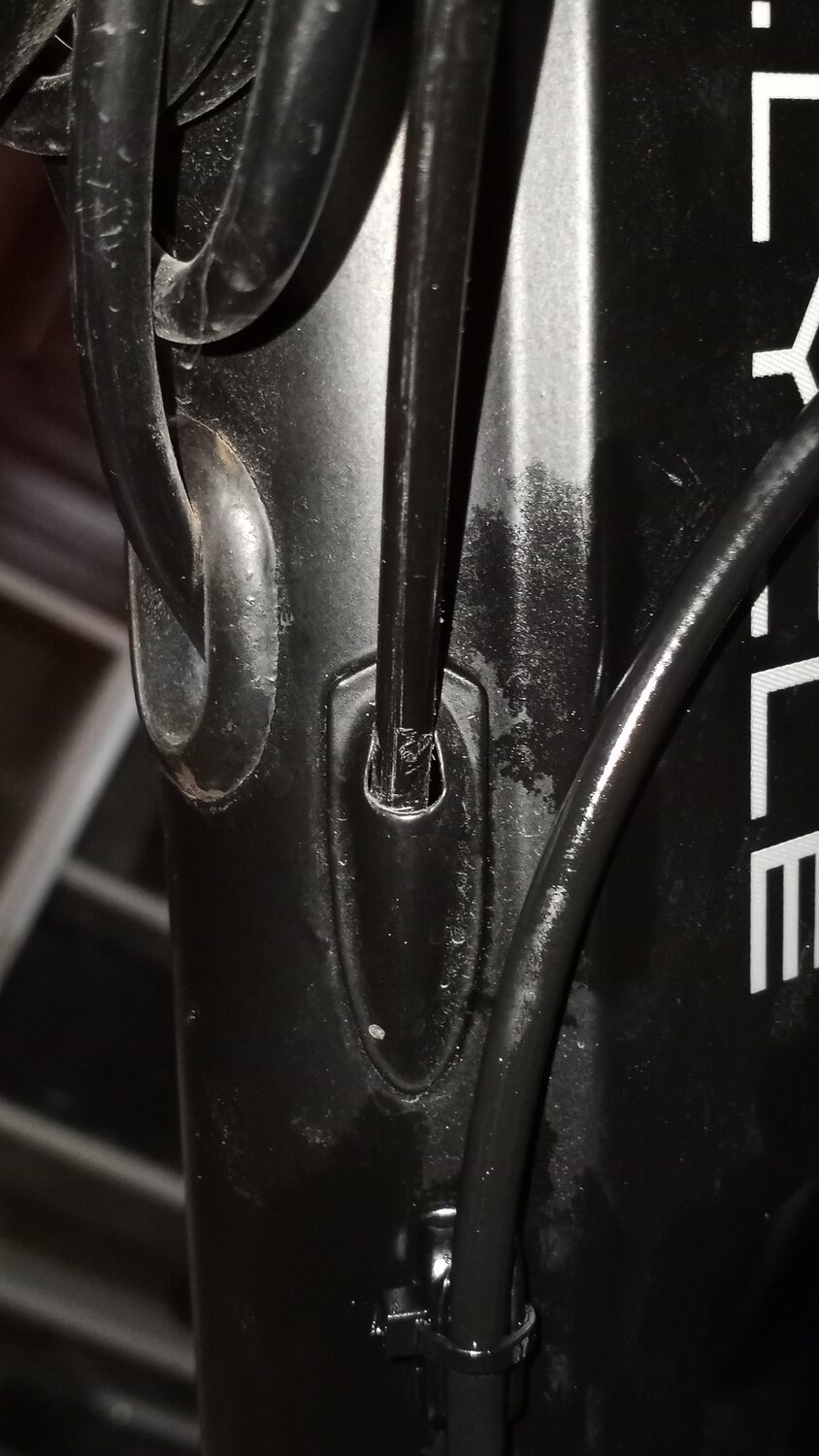

I've been thinking about how and where to install the shunt.
I was thinking inside the frame in the hollow space above the upper battery bracket where the power cable connects to the battery bracket.
I've already got two holes with grommets coming out of the hollow space. I should be able to fish the cable through the grommet?
I was wondering if I could wrap the shunt with foam rubber to protect and isolate it?
It would be difficult to screw it down or glue it to the inside of the hollow space.
I could then remove the heavy acrylic bracket from the shunt as well.
I figure that the shunt would generate very little heat because it's only seeing 20 amps and it has a resistance of almost 0 ohms.
Do have any advice on that?

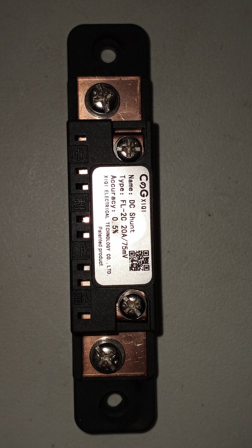

I did buy a cheap 20A shunt for $4 but it might not be accurate, and it's kinda big itself at 4½" long.

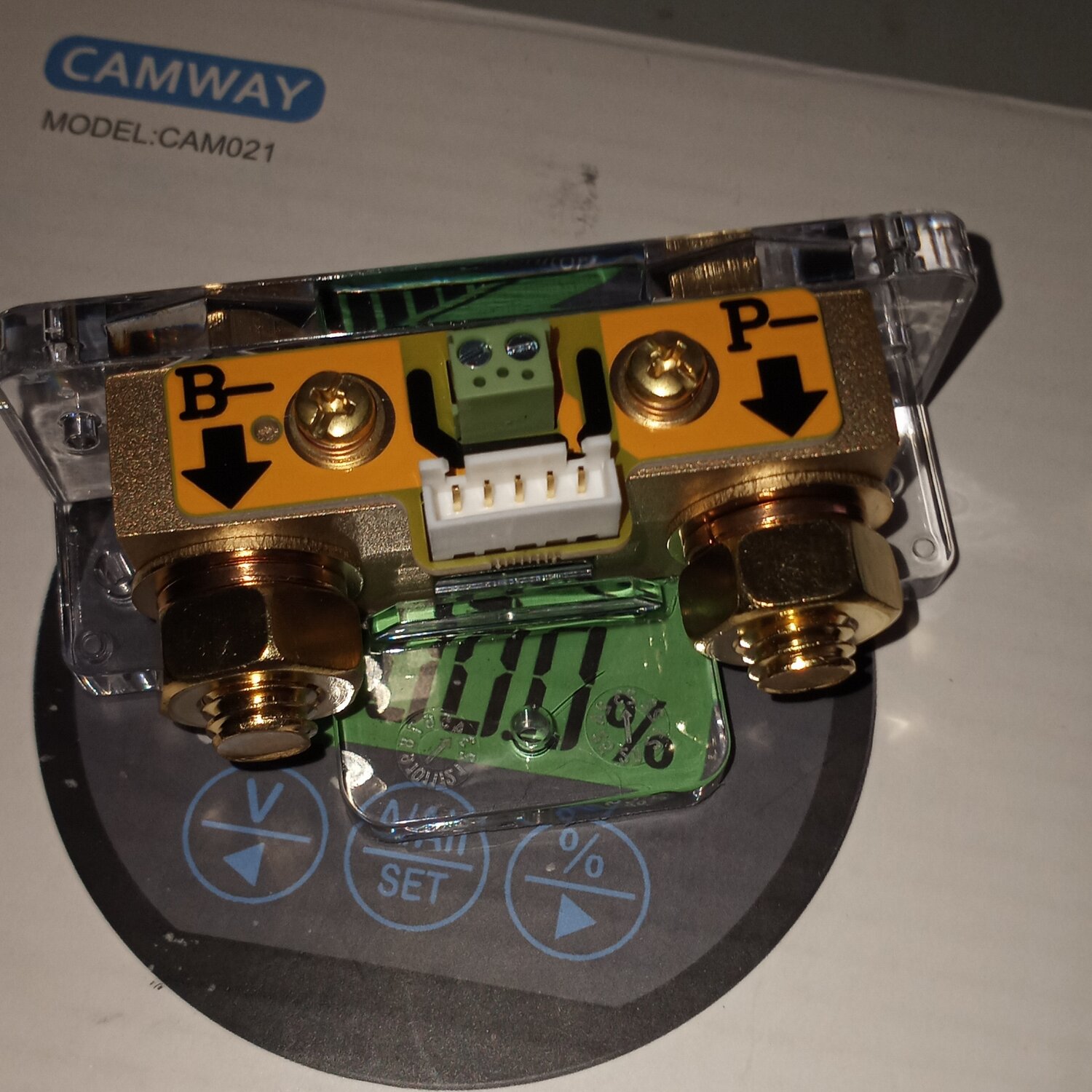

I want to use the shunt that came with the digital meter because I'm pretty sure that I can plug both the digital meter and my analog ammeter into it at the same time.
I'm pretty sure that I would just connect the ammeter to the B- and P- terminals, and the digital meter would plug into the connector?
That way I can tuck the digital meter away somewhere and have it set to monitor my battery's total capacity while I have the ammeter on the handlebars for quick reference.
I use that 500A model on one of my bikes and yes, it generates very little heat. Since it barely gets warm, I removed the shunt from it's thermoplastic housing to save space:
I bolted it directly to the plastic controller housing using stainless steel washer underneath.
I don't recommend encapsulating, or mounting it in a tight space with little air flow though. Heat could build up over time.
You can try connecting your ammeter across the B- and P- terminals but without knowing the circuitry, I can't be sure if the internal resistance of the ammeter will affect the digital readout.
FWIW, by comparison, the 500A gauge seems to be just as accurate as the 50A model, even at low current levels.
Thanks for the reply @6zfshdb
I don't have any room for the shunt inside my controller, and it looks like the cable isn't quite long enough to reach my handlebars from the controller.
I'd still like to put the shunt in the hollow space above my upper battery bracket. The power cable is right there with easy access.
Perhaps I could put the shunt in some kind of small box with a few breather holes and wrap it with some foam cushioning to stop vibrations?
That space is well protected from any rain.
I just hooked up the ammeter to my bench power supply and it read full scale at 0.08V while the amps were reading 0.000 so it wasn't even drawing a full milliamp.
I figure that it should have no impact on the Watt meter unless there is some weird inductance or something going on that feeds back into the shunt and Watt meter?
That's good to know, but even the smaller shunt would be kinda difficult to install.
I'm going to think on it for a while and see what I come up with.
I don't really need the ammeter or the Watt meter and cutting into the main power wire makes me a bit apprehensive. All the power that runs the ebike goes through the shunt so any sort of failure will shut down my ebike.
I do have the digital Watt meter built in to my display, which is useful but it has some kind of "digital damping" or something going on and I can't see the power spikes.
