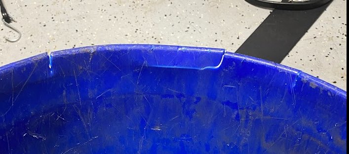

Tonight I was reseating a fat tire on a tubeless rim and the bead failed. It exploded at about 35-40 psi. The Vee Tire Mission Command 26x4 was the tire. I may have had too much soapy water and combine with the dried Orange sealant proved to be a bad combination. Tire must have slipped the bead and me and the wife are a little tone def tonight. The force did crack a 5 gallon bucket it was laying on so we were very lucky. The tire is damaged with a broken bead. I watched it on our security camera and I could see the water and sound pressure distort the surrounding area. I was about 2 feet away when it blew. It sounded like an explosion which prompted my neighbor to come outside and ask what just happened.
Here is a picture of the 5 gallon bucket. Don't know if the explosion broke the bucket or the explosion knocked the bucket against something and caused the cracks. Either way thank God I was not holding the tire. Lesson learned for sure.

Please, don't inflate fat tires to 40 psi. Expect them all to explode if you do that.

Yeah, if they're these: https://veetireco.com/product/fat-bike-mission-command/ it looks like 20 psi is max recommended which is pretty normal.
When setting up tubeless, you only need the initial blast of high pressure air until the tire starts to "sort of" hold air. You can then bring the pressure up slowly until the beads pop into place. Once they do that, adding more air doesn't do any good.

Just visited VEE Tire Co's webpage for this tire. ALL of their Fat Bike tires are rated @ 8-20 PSI which is typical as you'd already mentioned. https://veetireco.com/product/fat-bike-mission-command/
