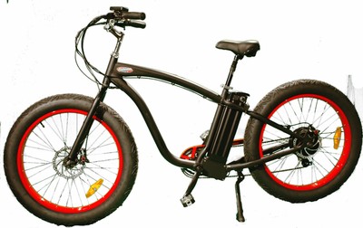

I'm considering a Fat Tire Beach Cruiser because I like the upright riding position and the fat tires can help offer a smooth ride. I've found quite a few online that all seem to be the exact same bike from China, they just have different names. Here are the one's I've found so far.
E-Lux Tahoe
Electric Wave - by American Cycle Company
SchryerPower
Motiv Stout
Beachnik
Equalizer
Electric Hummer Fat Tire
They all seem like the exact same bike and all have the same components. I'm 6'4" and it's hard to find a bike that fits me. I rode the E-Lux Tahoe and I think I prefer the battery behind low and behind me like each of these bikes. I'm hoping to go 25-30 miles throttle only. Does anyone have any experience with any of these? Should I just order one from Alibaba and skip the middle man?
Of all those bikes, the motiv is probably the only one with any sort of a brand backing it up, they make and sell a few different bikes. The rest are most likely a clone of their bike.
That said, none of those bikes will likely take you that distance on throttle only, fat tires just have too much resistance.
I ride my DIY cruiser more and more because it is much easier on my hands, no direct connection to the fork and all the road stresses. But they are very inefficient because you sit completely upright, like a giant sail. Add to that big tires and you make things worse. You need a 48v 20 AH battery. That's where you need to start. Then you need to decide if you are going on sand or snow because that means more motor power. The battery will go in a bag, in the frame, so find a frame that can hold a battery. Simple.
You can easily build the bike you want. Buying from China means an illegal battery shipment. If they find it, they keep it, Customs that is. The people making batteries with range are Eric at Luna Cycle and Paul at EM3ev. My advice is to find a battery, find a frame, and find a motor. Maybe find someone to do assembly.
