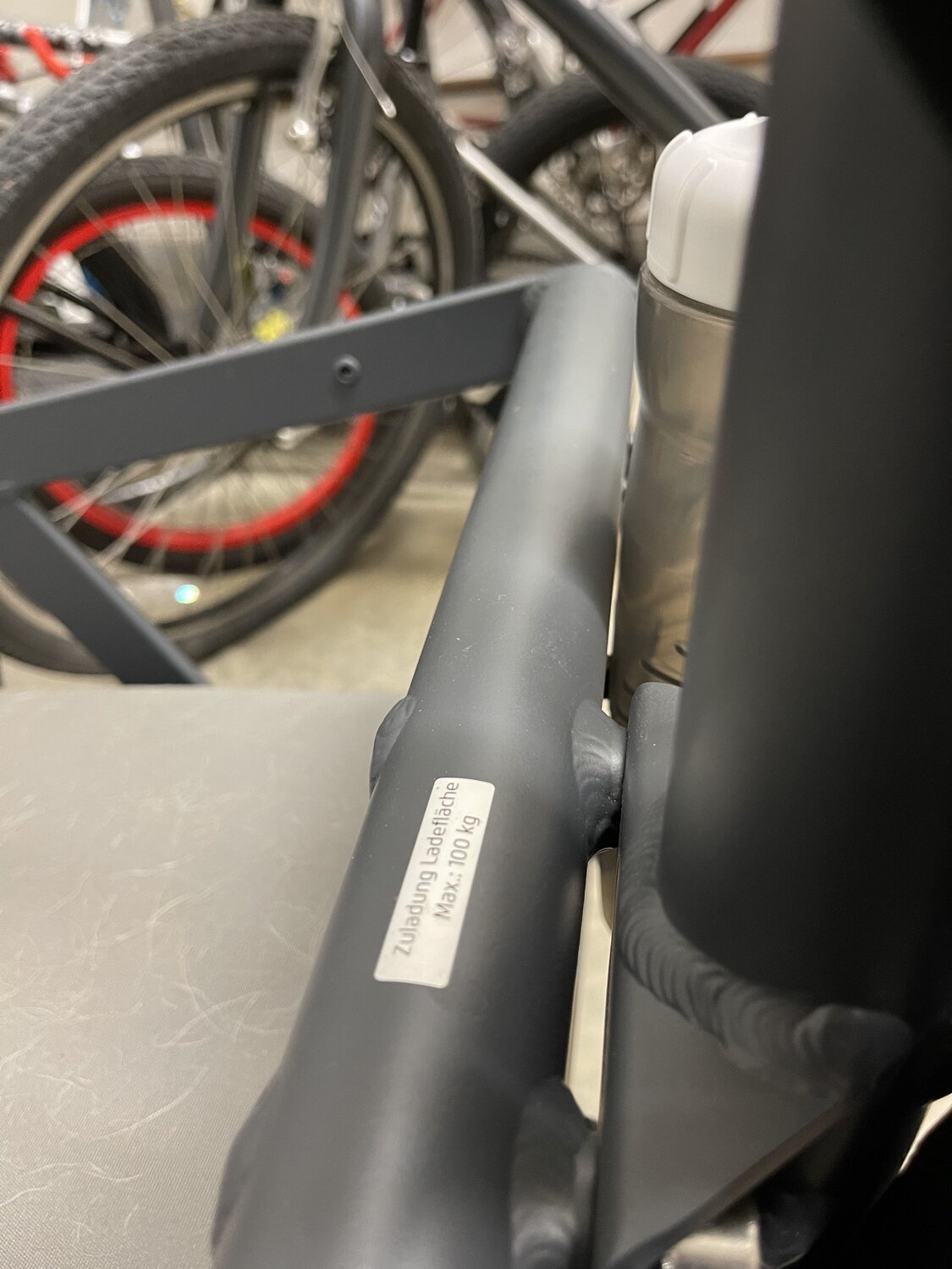

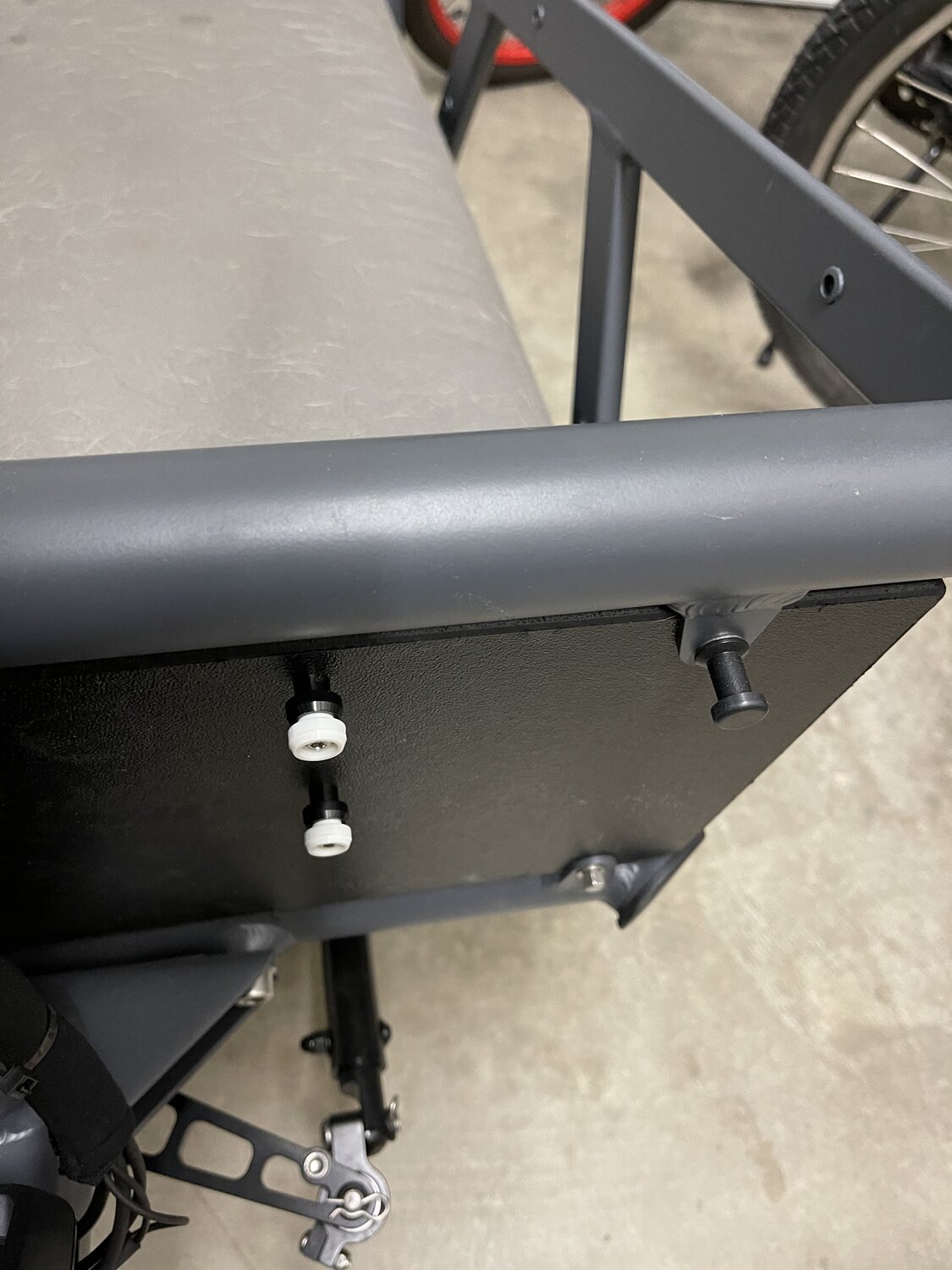

In case anyone is wondering, I picked up a Fabric 750ml bottle to mount on my Load 75 and initially found it wouldn’t go on because the bolts were too short to go through the cargo box. So I ordered some bolts, nuts & washers and started playing, then had to order a second round and finally got it on there.
The cargo frame top bar actually interferes with placement of the bottle if you use a 25mm bolt and a single bottle mount, but if you buy a 30mm bolt (5mm shaft thickness) and use with a locking nut and one washer, and use both the white and black bottle hooks that come with the bottles stacked on top of each other, you can get it on there and clear the frame, I’m attaching some photos.
