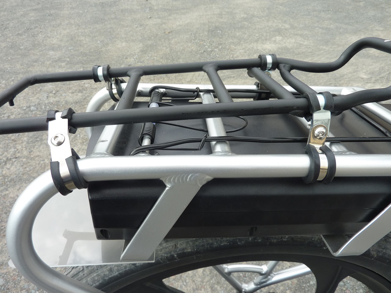

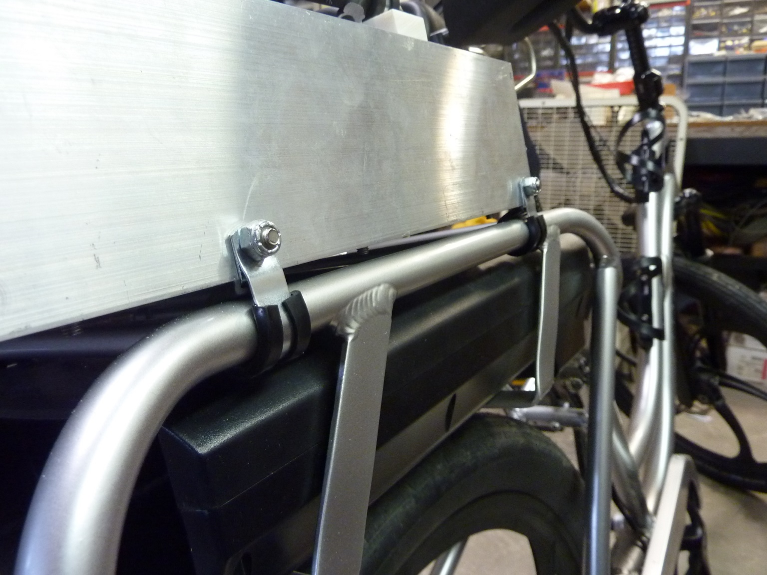

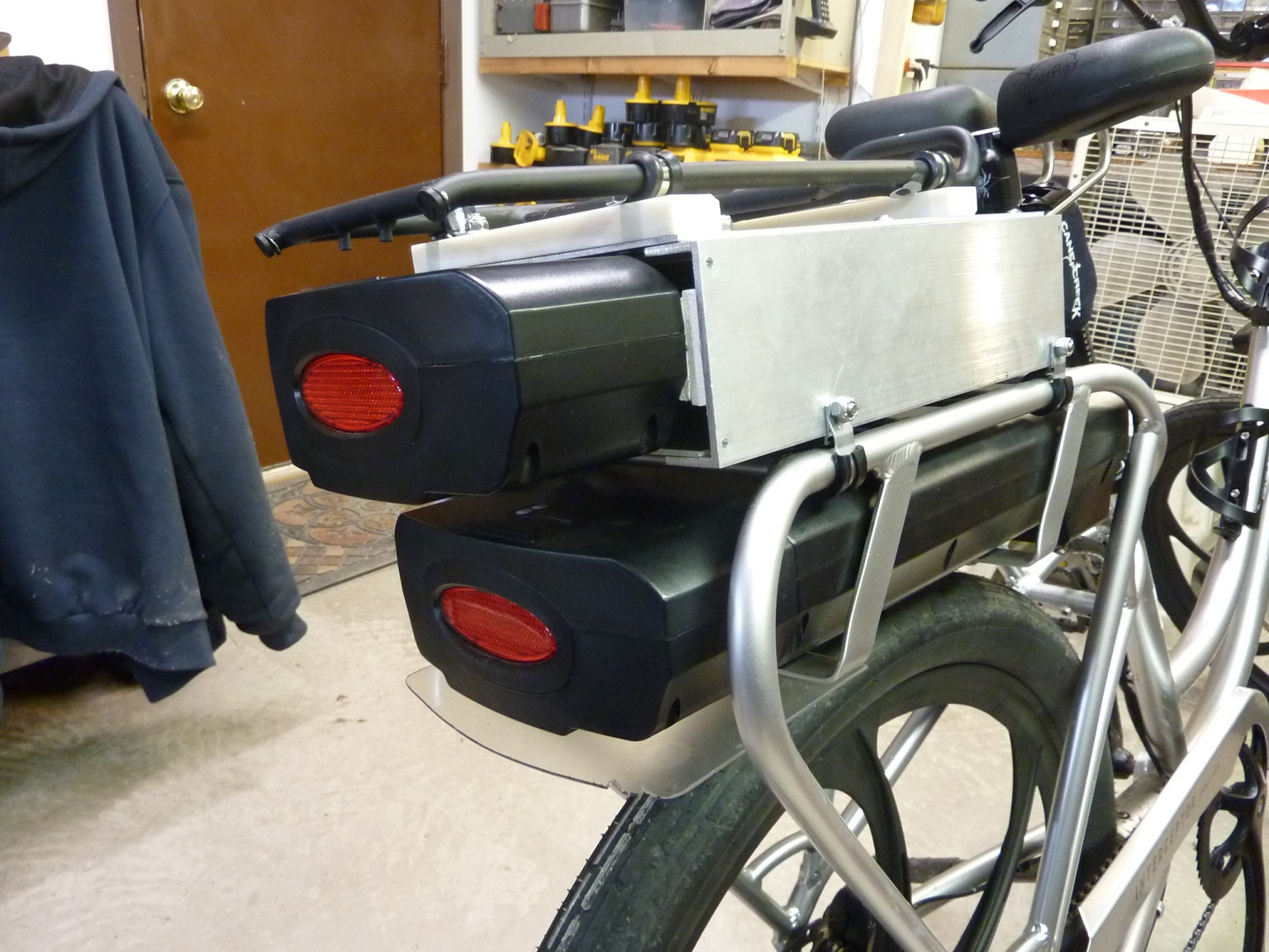

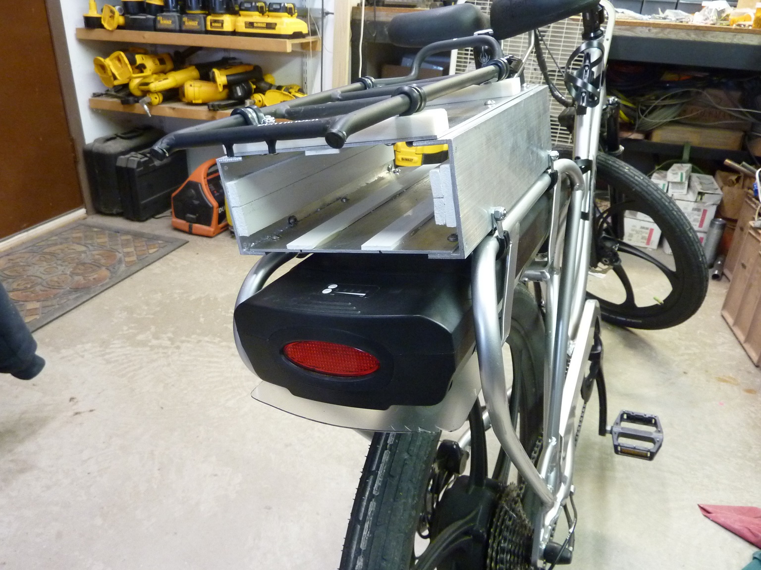

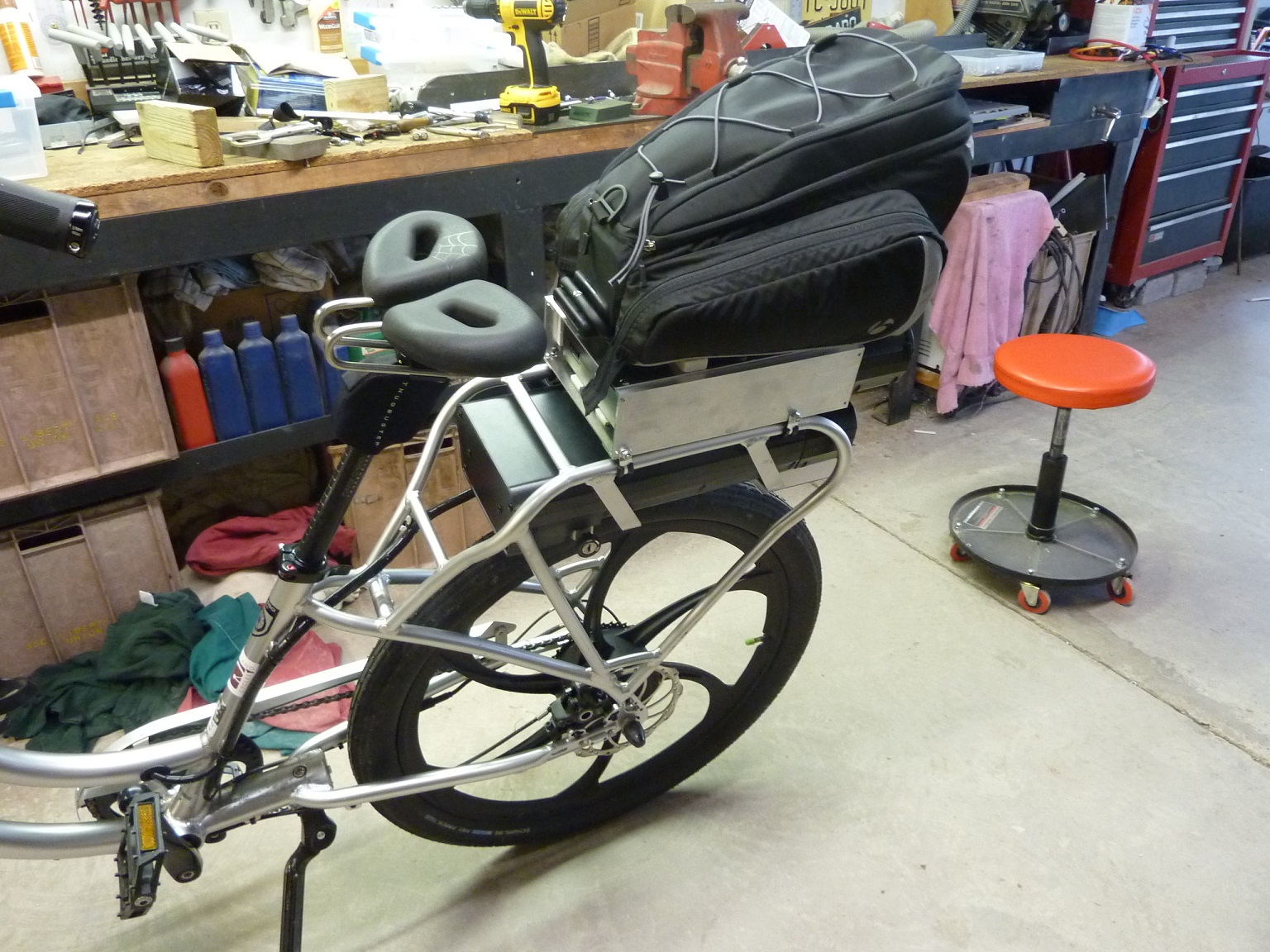

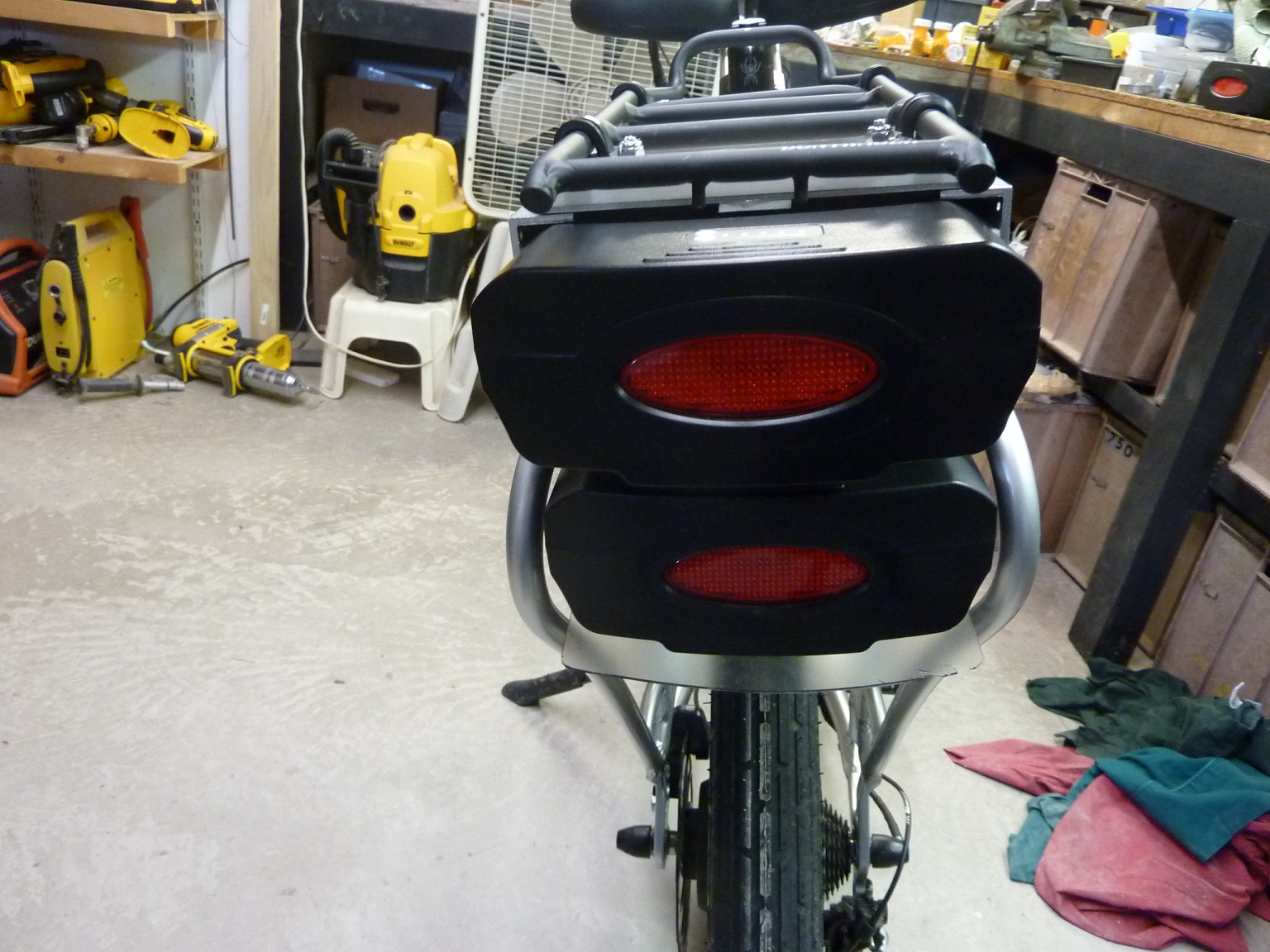

I did something similar with my Pedego Interceptor where the battery is mounted under the rear rack. The double layer rack idea won't work since the Pedego rack is not removable. I had to make my own. In my case, I have a collection of Bontrager / Electra quick attach bags which I use on my Trek MTB's. I made an "adapter" to hold a second battery and allow me to use my Bontrager accessories.

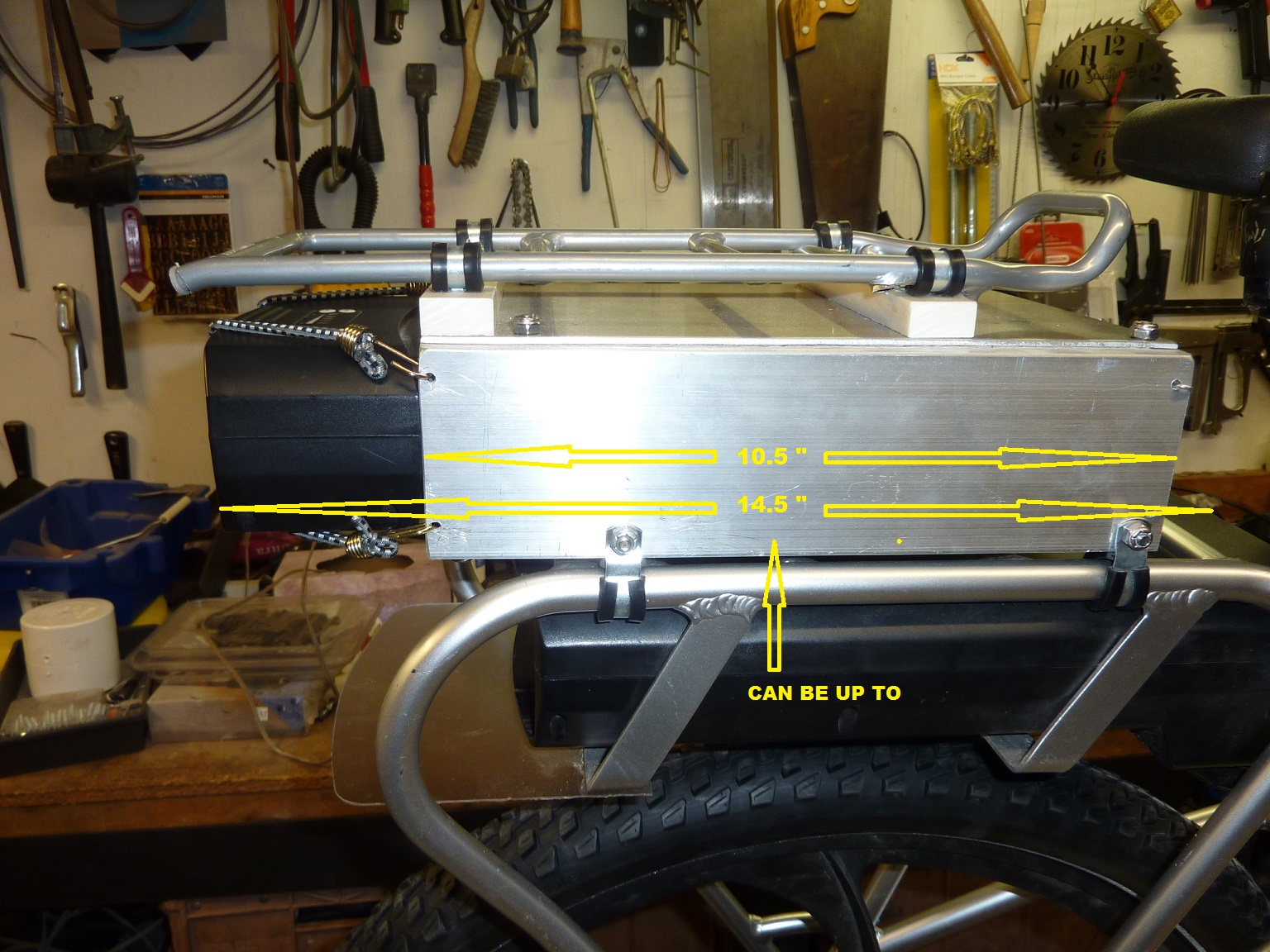

I made an aluminum battery box and mounted it to the top of the Pedego rack using insulated cable clamps. No modification to the bike was necessary. I chose to use a second OEM battery and just swap them instead of using a switch.

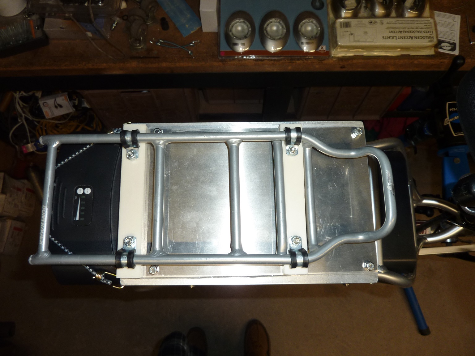

Next, I cut the top off an old Bontrager rack and mounted it to the top of the aluminum box using the same clamps.
I can now carry a second battery and use my Bontrager quick attach bags.
When not carrying a second battery, the box can be used for other gear.
The same design can be used with Topeak or almost any other brand rear rack system.

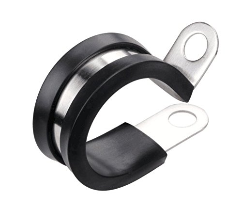

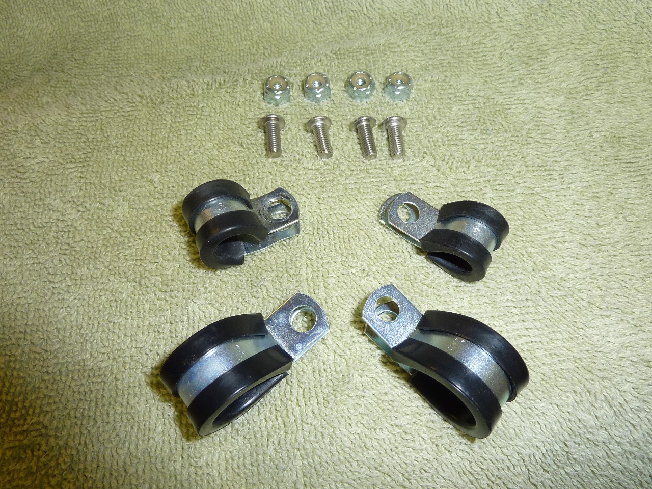

If you haven't already purchased a second battery, you could save some $$ by using J.R. 's suggestion. Buy a double layer rack / battery combination, then cut the top off your existing Topeka rack like this:

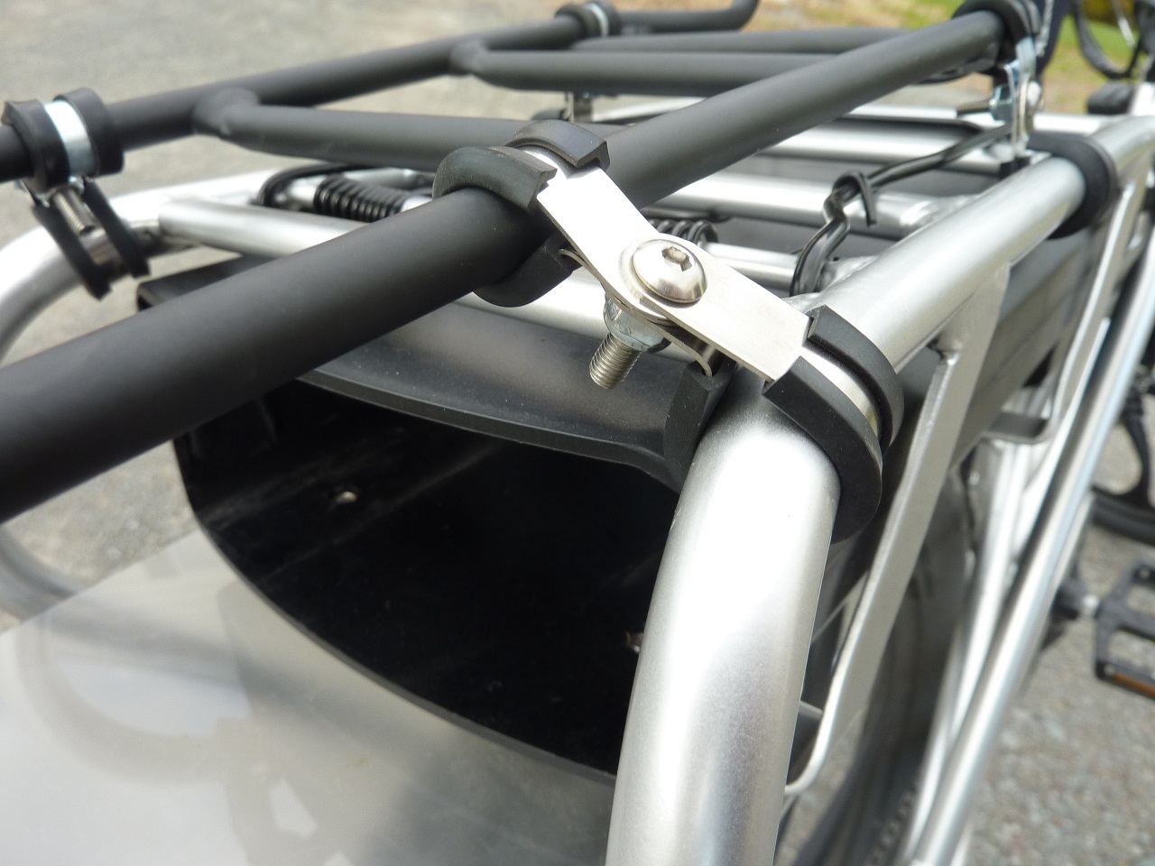

Then mount the top of the Topeka rack to the top of the double layer rack using insulated clamps:
I've used this idea on several bikes to adapt rear racks for use with other rack / bag mounting systems. The trick is making the adapter sturdy by using the correct size clamps for the different tube sizes.

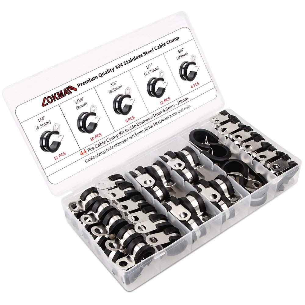

Although the clamps can be purchased separately in hardware stores or home depot, I found it easier to use this assortment pack:
https://www.amazon.com/gp/product/B075WQV32Q/ref=oh_aui_search_asin_title?ie=UTF8&psc=1
Your idea of using leg extensions to raise your existing rack would work but you would still have to fabricate a battery mount underneath.
View attachment 30540 View attachment 30541 View attachment 30539
