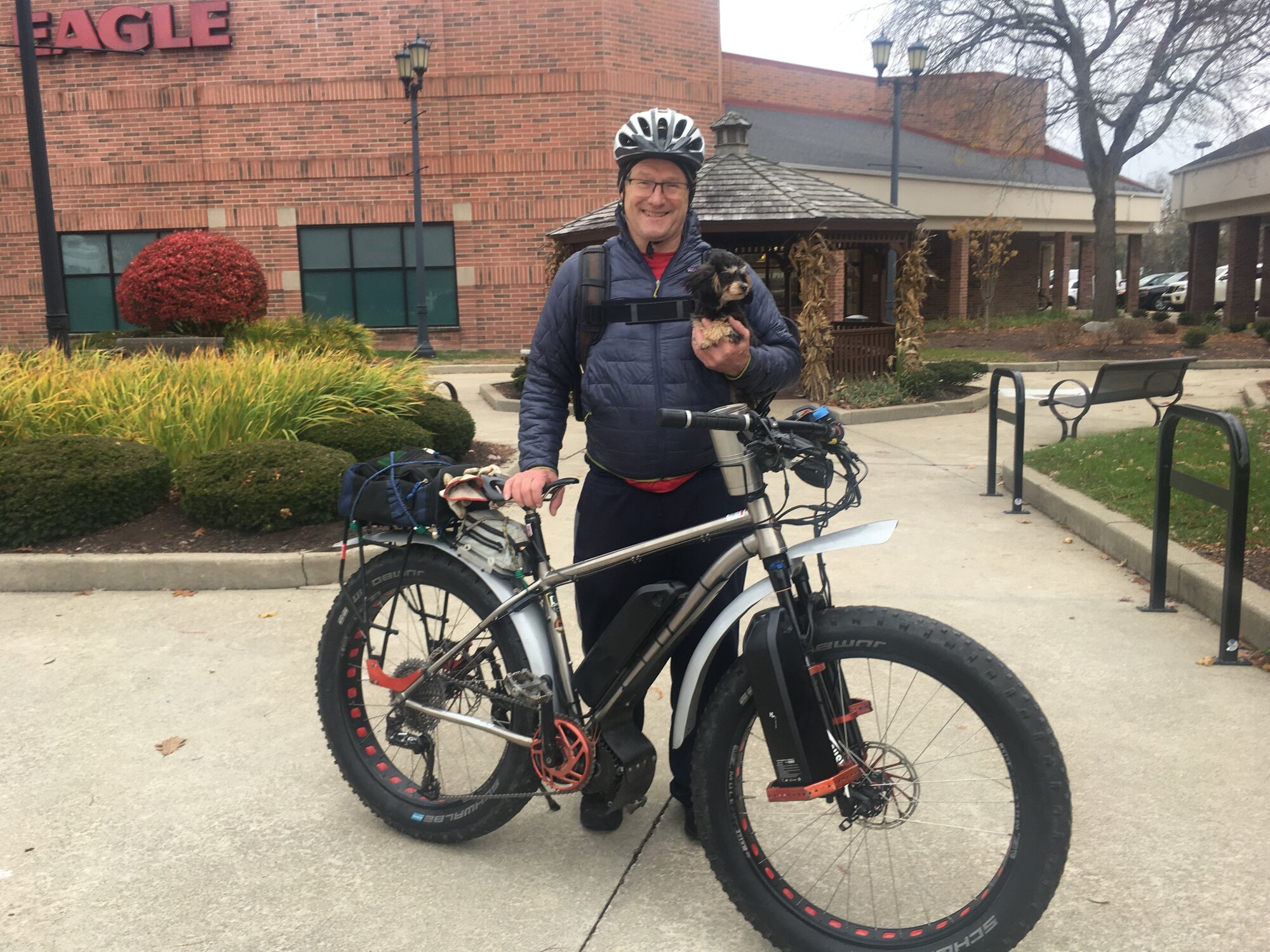

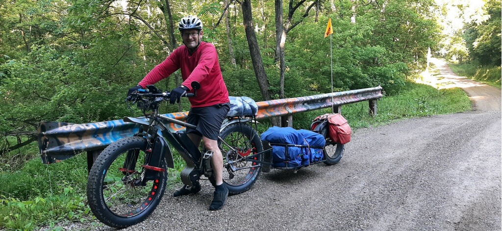

I don't actually carry what would be termed as a spare. I have four batteries in parallel for a total of 52 volts @ 49 ah. (2,540 watt hr)
I built this bike for the Great Divide Mountain Bike Route.
Furthest one day ride was around 172 miles. I charge with a 15 amp charger for a charge rate of around one mile per minute. I have about 20 k miles on the bike now.

Pierre have you got a pic for us?

That Fat bike is just lovely!
20k miles! Why surely this must be a Bafang made motor, just wondering what model it is,BBS02?
