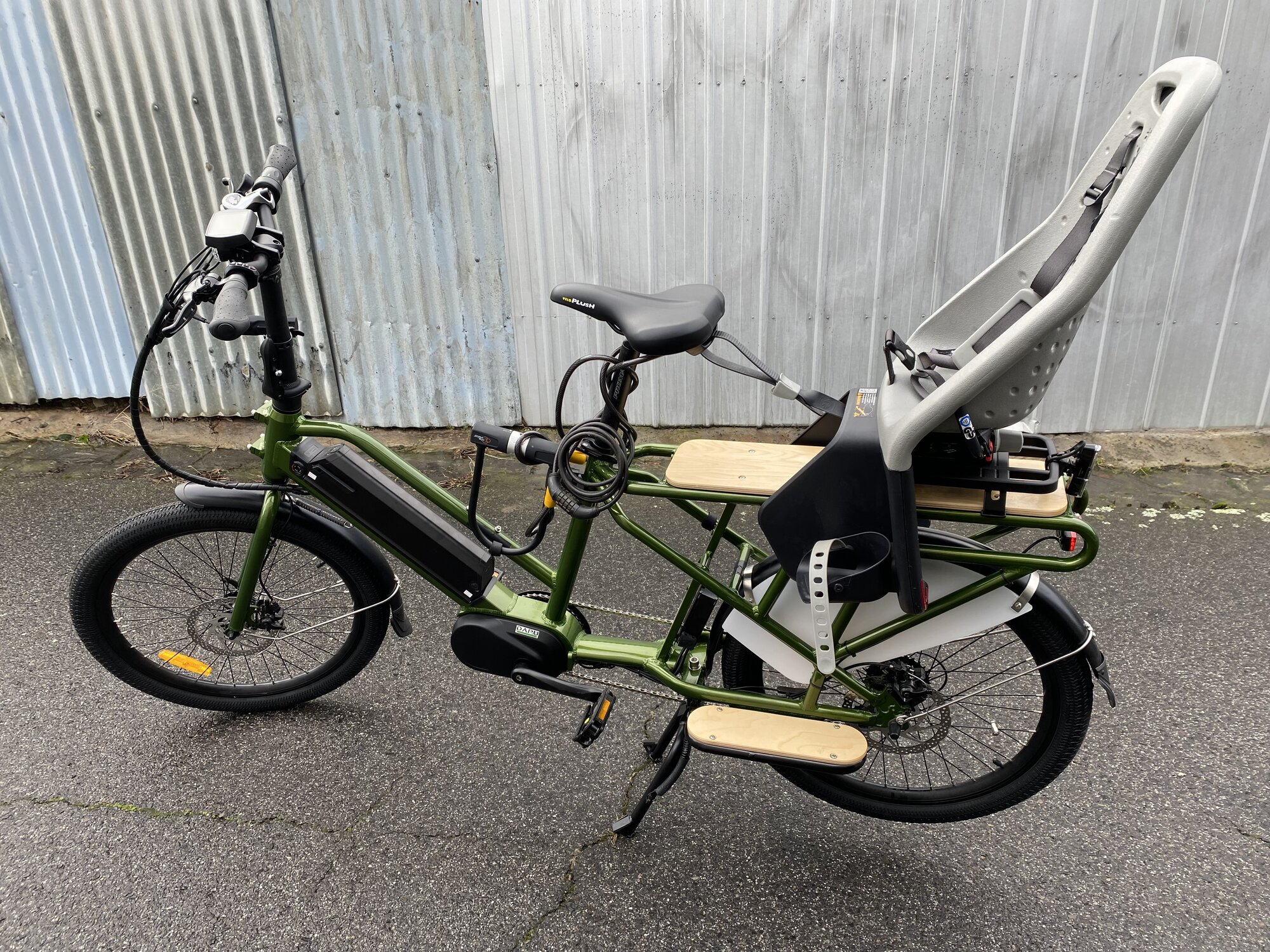

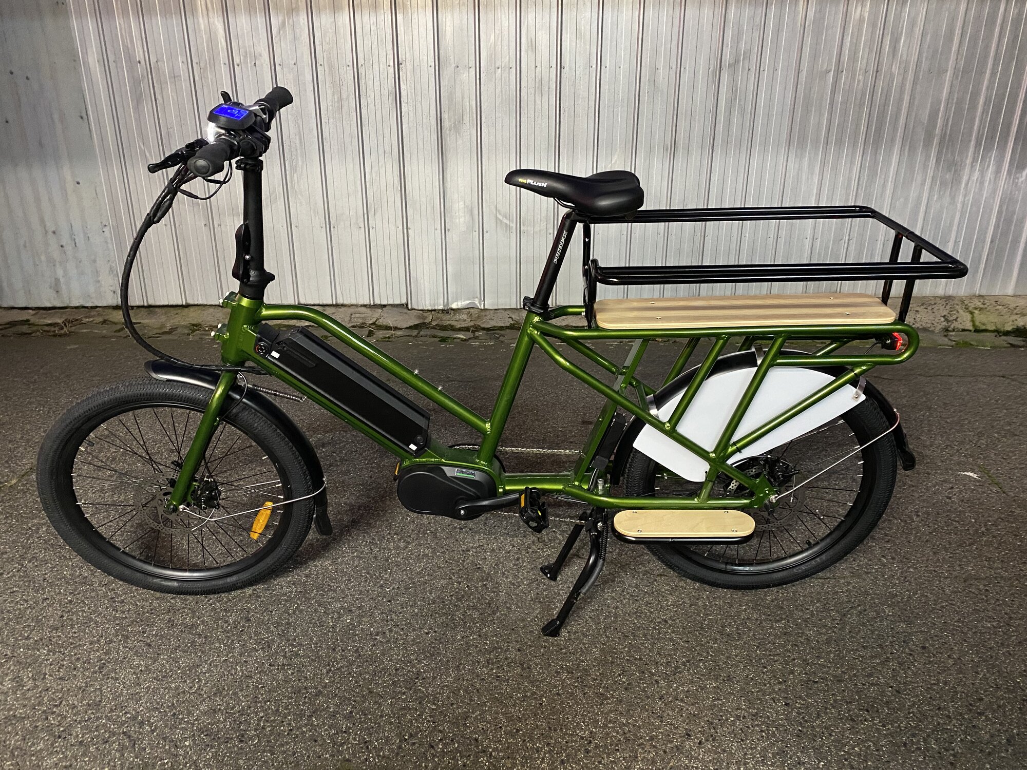

The result (sans front basket):

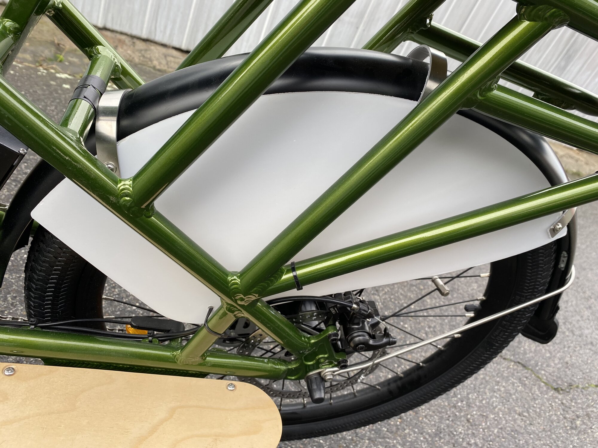

Overall first impressions of the quality are quite good. The paint and welding and wooden seat/footboards are all pretty nice. The mudguards are basic plastic ones and seem fine. The guard around the rear wheel is a cheap Perspex guard (still with protective plastic cling wrap on in my photos) that is held onto the other side by some bend aluminium strips and cable/zip ties to the frame. Where one of the lower cable/zip ties attaches to the frame, the Perspex is cracked/broken, although this still holds it fine. The front aluminium strip strikes the frame and given that it's the cable/zip tied on there it rocks back and forth a bit, so in the meantime I just put some electrical tape on the frame so it doesn't rub through the paint. I should probably wrap the strip too.

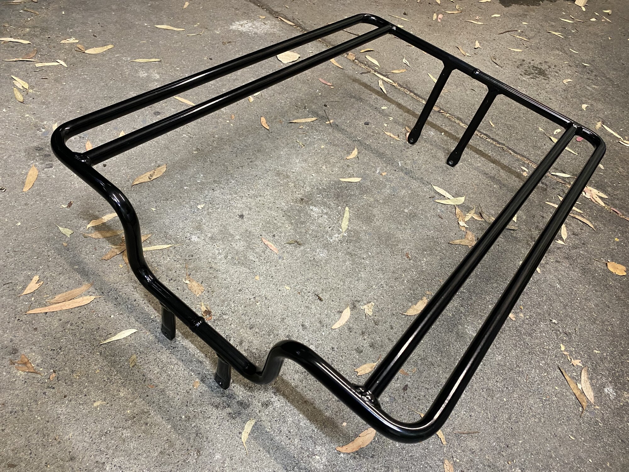

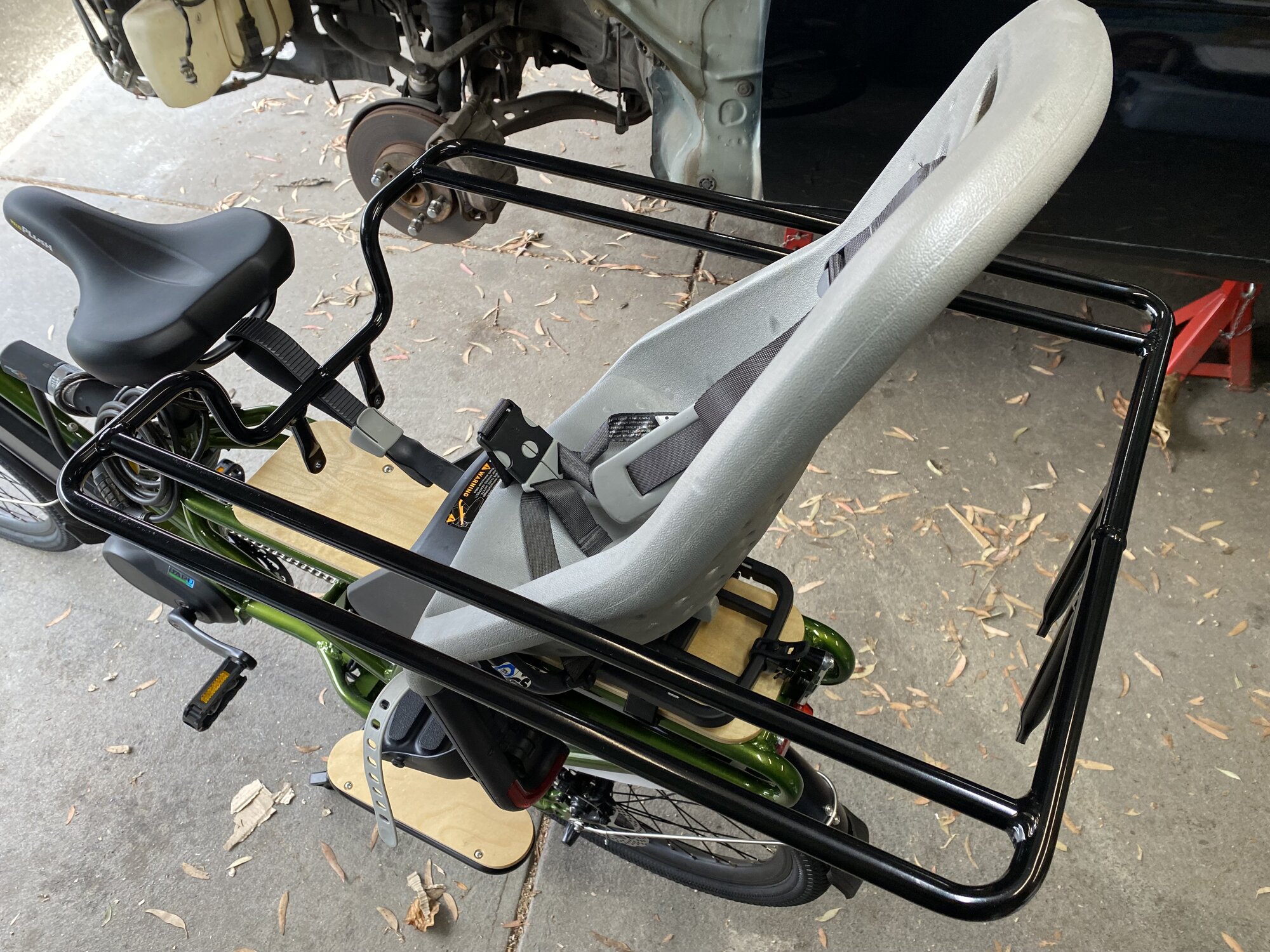

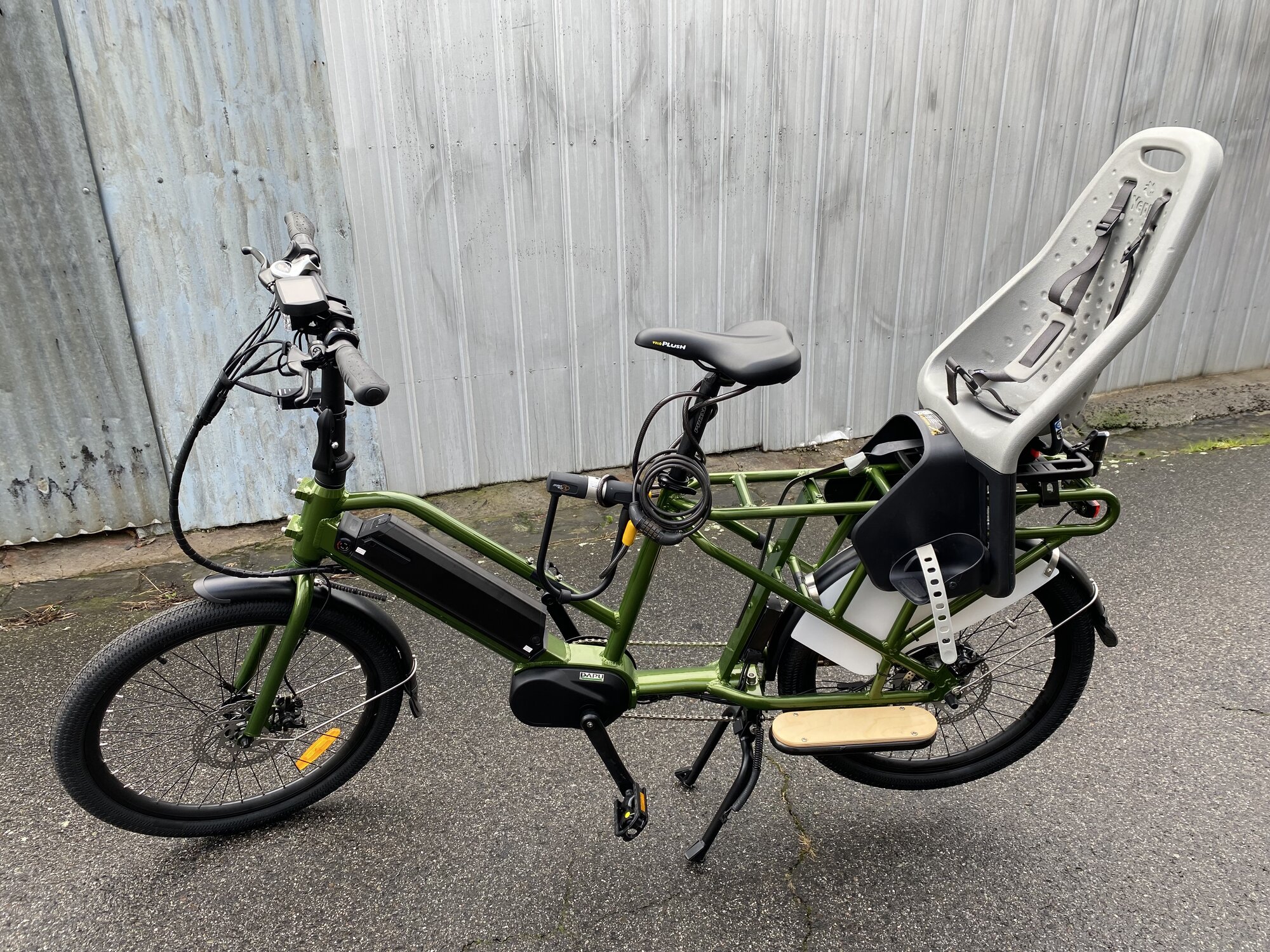

Now: The rear bars. Unlike the ones shown on the Eunoru website (here) and some reviews/photos - these have two outside bars. I thought this was initially a plus - then I tried to fit a child seat back there. With the bars installed, I cannot fit a Yepp Maxi child seat on there as the seat is too wide, despite being one of the two seats listed/recommended on the Eunorau website. So that's pretty disappointing. I'm tempted to order a second set of the bars and cut off the inside bars myself, but will just ride without them for a while and that'll probably be fine.

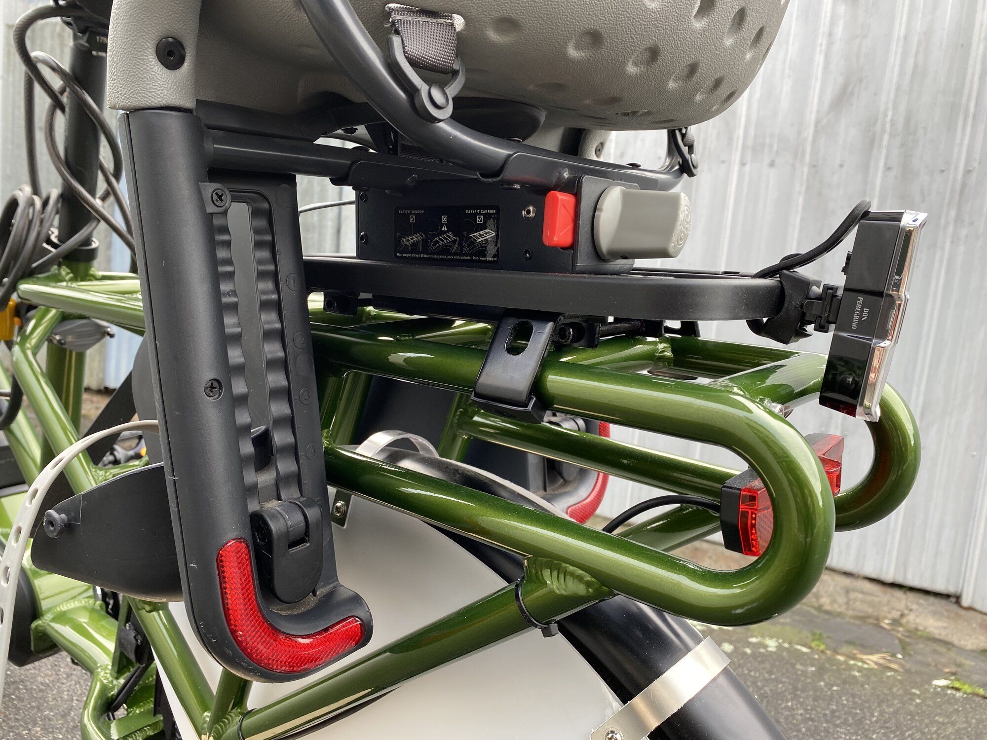

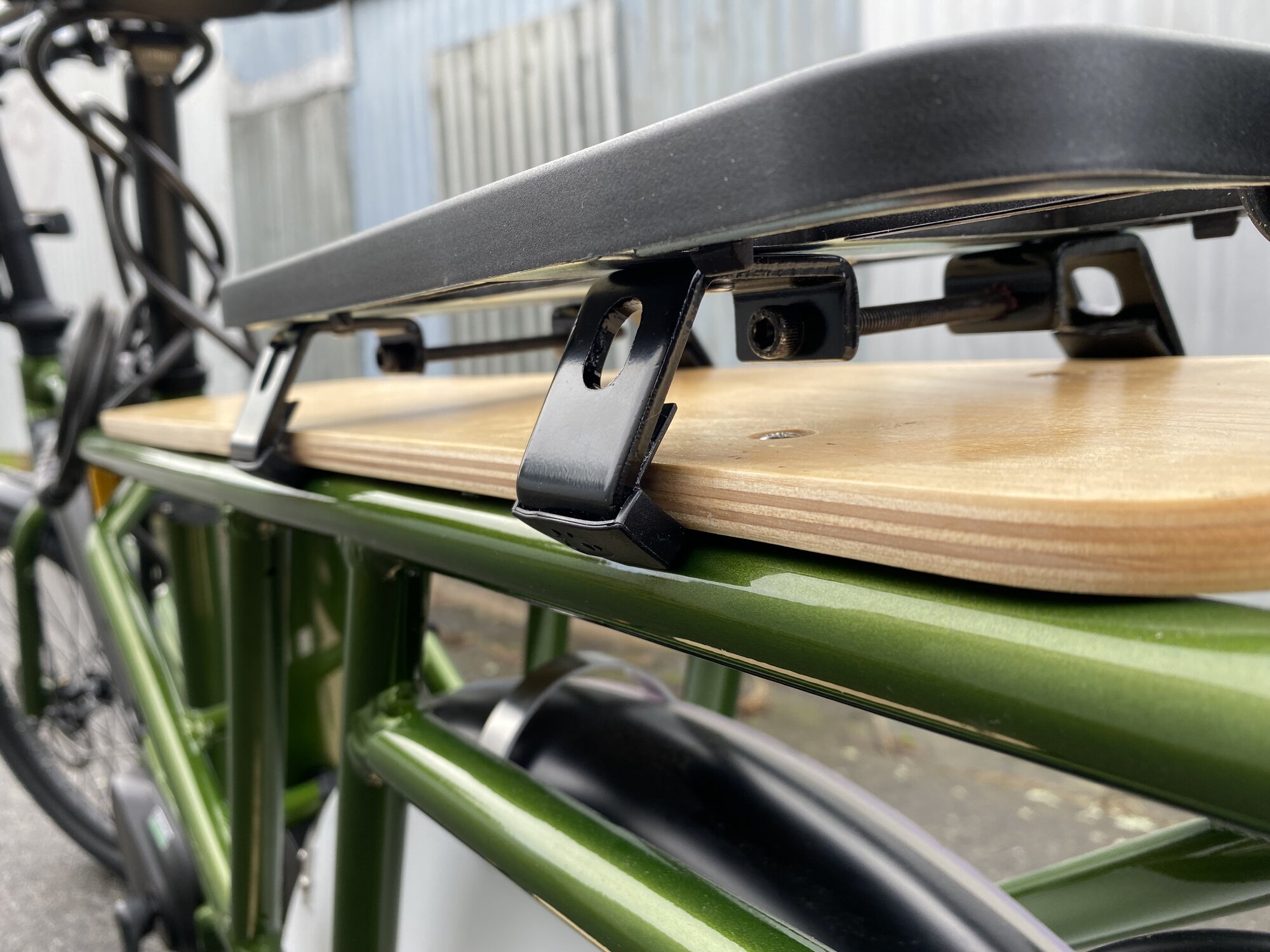

With the rear wooden seat removed, the frame isn't the correct size for the Yepp Maxi to attach to (as can be done with the Tern GSD) so you'll need the adapter plate, which can either clamp on the frame with the rear wood seat removed, or clamp on to the wooden seat itself. Clamping on the wooden seat, I can lift and shake the bike and it remains attached.
I might re-make a wooden seat to so it just covers the front half and then the kid seat can clamp on the frame. Due to the Thule Yepp adapter block thing it can't clamp down on the frame with the wood seat in place as the tightening screws/frame hit the wood seat.

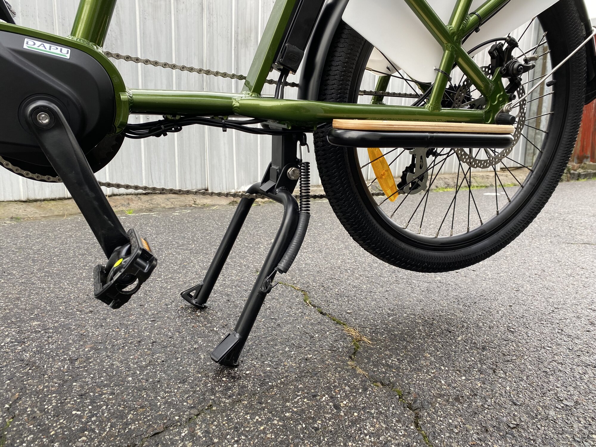

The kickstand is strong and holds the bike well. This appears to be a slightly different version of the stand than some photos and reviews, including one I read that said that with the stand up in riding position, it was quite low and a danger for hitting footpath/kerb edges. Anyway my one seems to be fairly high up once in riding position so that doesn't seem to be a worry. One thing with the stand is that it raises the rear wheel off the ground a fair bit. When I sat my toddler on the back for the first time it caused the bike to rock back on to the rear wheel, which upset said toddler. In future I'll either get a separate floor stand of chuck a piece of timber under there so it doesn't rock back when putting her on.
