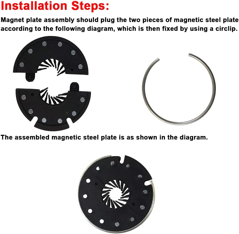

I know how unlikely this sounds, but I had a new bike doing the same thing. As I do all of my own service work, and not having much patience with some of the stock/OEM controllers being supplied, I installed an aftermarket KT controller figuring there was little doubt that would fix the issue. It didn't! It turned out the PAS sensor was the issue as once that was replaced the issue never returned....
Not saying this is the issue here. Only that it is a possibility.....

Ahicks version means pulling the crank arm. This but if you currently have that typed you'll need to get a crankarm tool anyway. with luck, you'll have a split ring that is easy to change.
The lag is on purpose and I do not like it. It is supposed to, 'Smooth out the ride,' so it is not lurchy and twitchy. This is very common. Also when you begin pedaling again after coasting there is lag. Three cadence magnets need to pass the pickup before it kicks in.

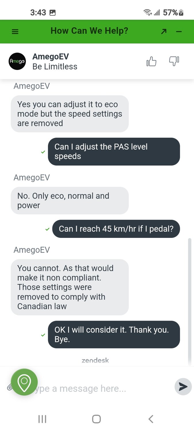

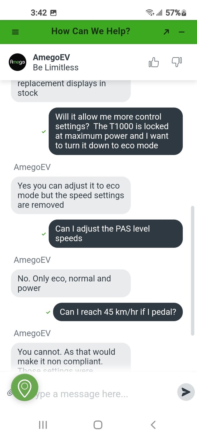

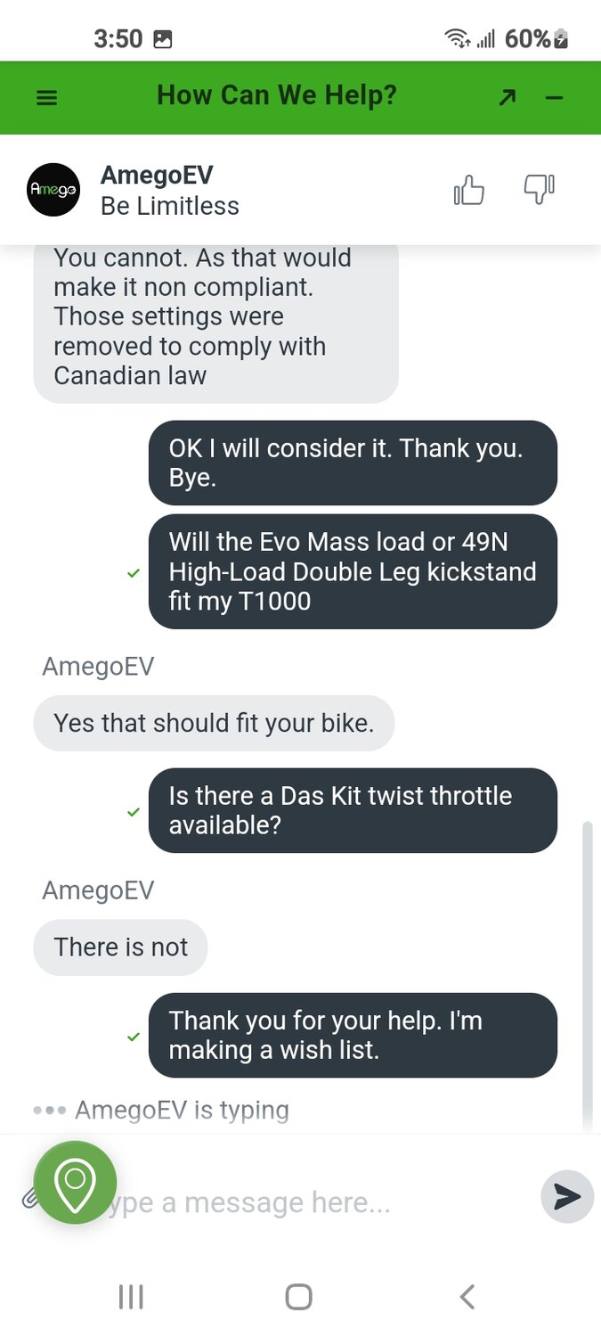

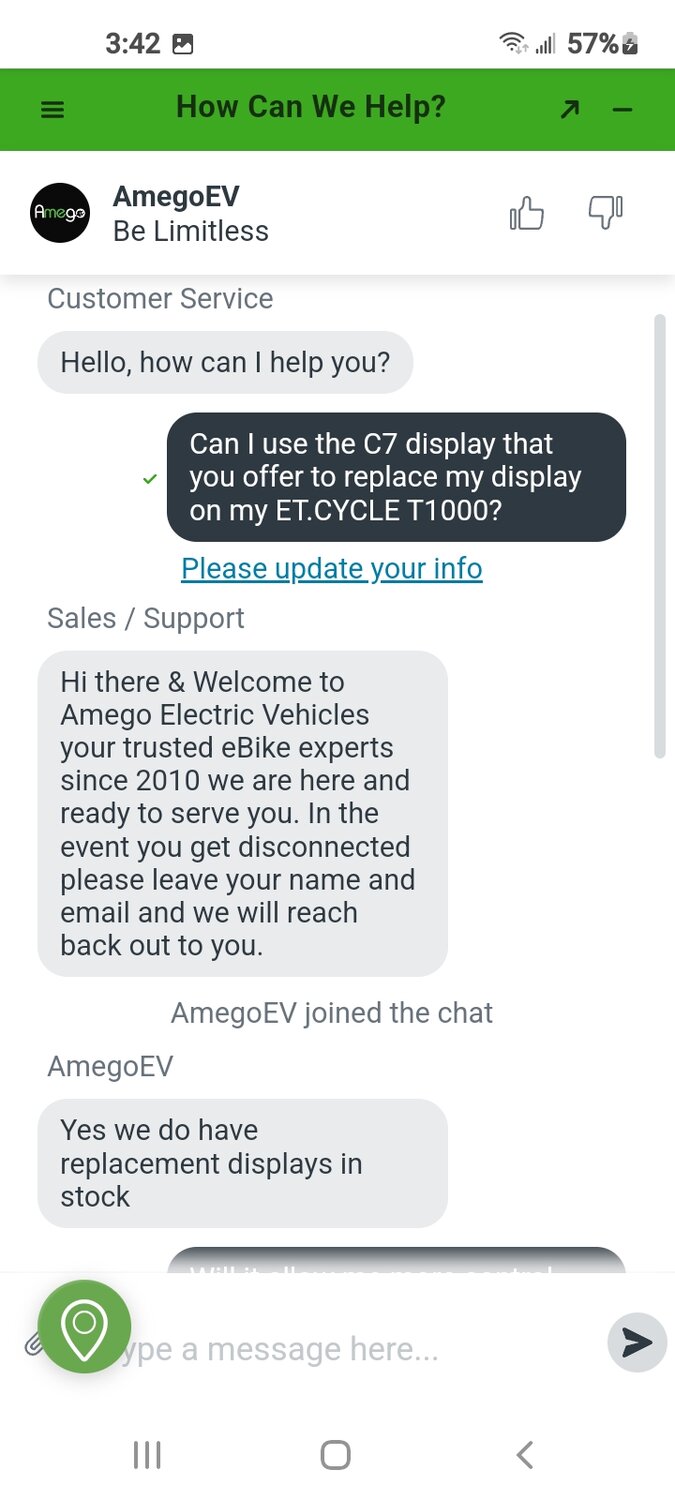

Another option is to buy a new C7 display from Amego.
It allows you to turn down your power from Turbo, to Normal, to Eco...
This is my conversation with Amego.
(Sorry if this isn't allowed on the forum. Please delete if necessary.)

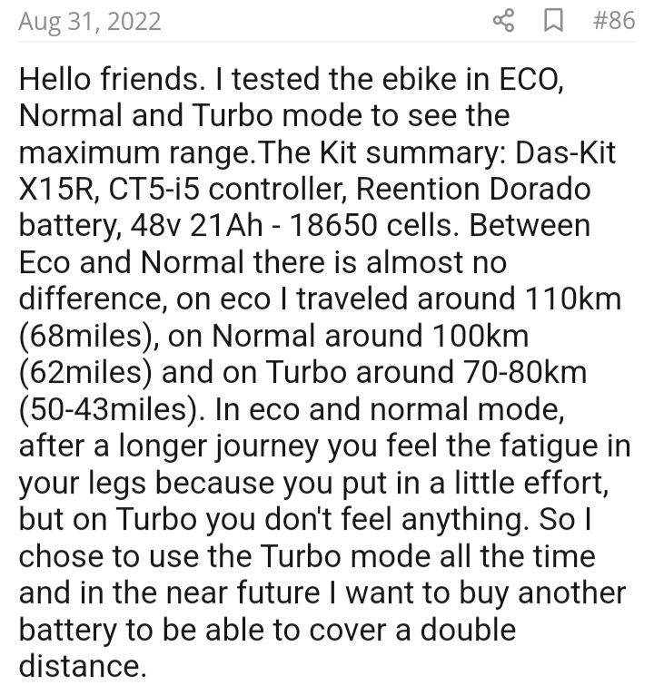

One guy wrote this about the H7 display and how it affected his performance, but he was talking about range and not the KICK the bike gives you when the PAS kicks in or the throttle is applied,..
Apparently, the T1000 motor is geared for torque and REALLY packs a punch when it kicks in.
I just want to turn that down so that my almost bald fat street tires don't skid out from under me and leave me sliding down the road on my side.
I don't want to go 48 km/hr.
I just want to go 32 km/hr, preferably not on my ass on a gravel road or in a ditch. Lol

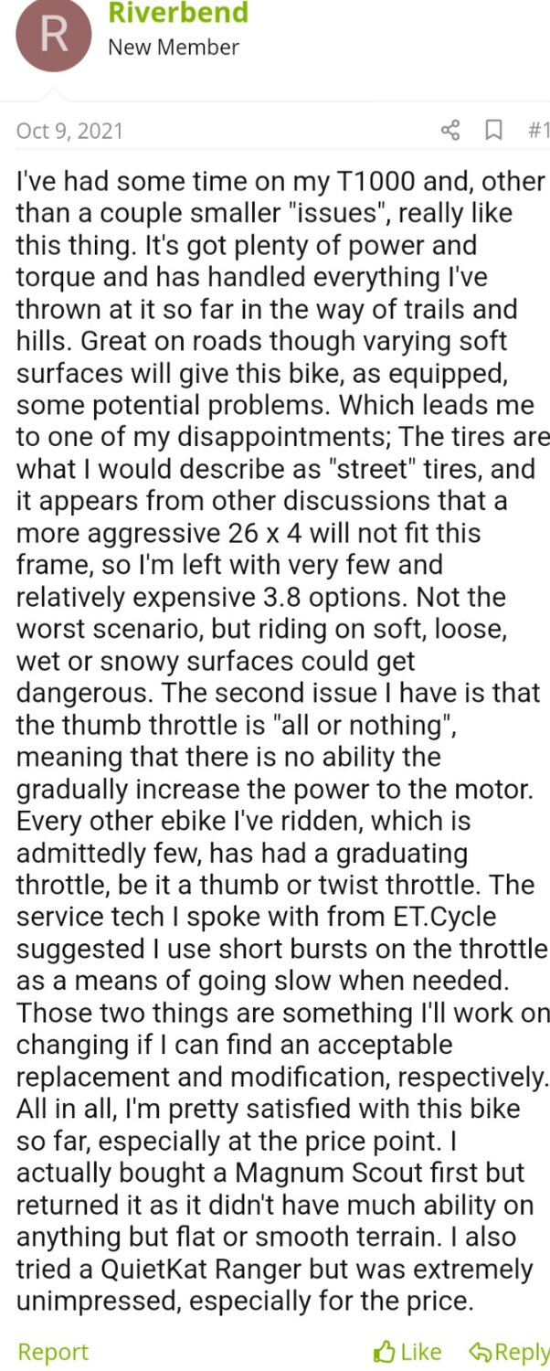

Regular 26x4.00 nobby tires won't clear my bikes rear frame.
I like these, I think ?
That is a huge safety issue.
Twist throttles are better in theory than in practice.

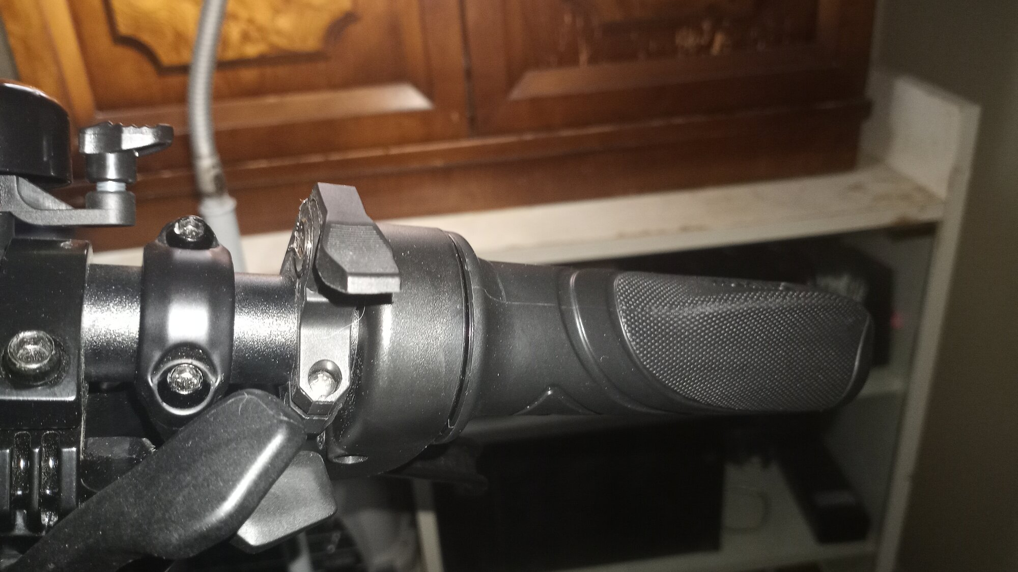

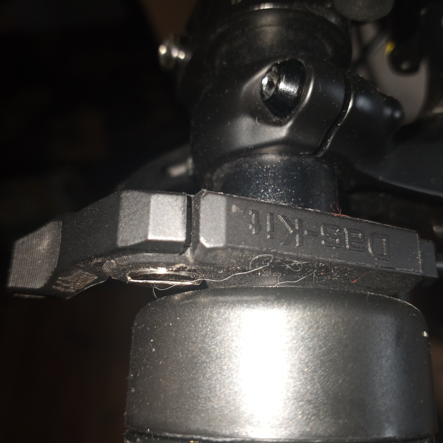

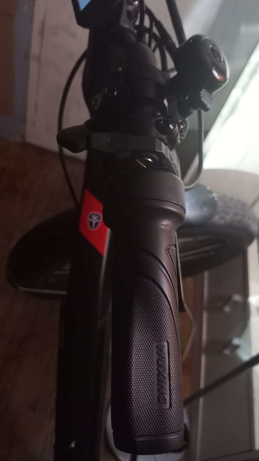

I've got two throttles now.
A twist and a switch.

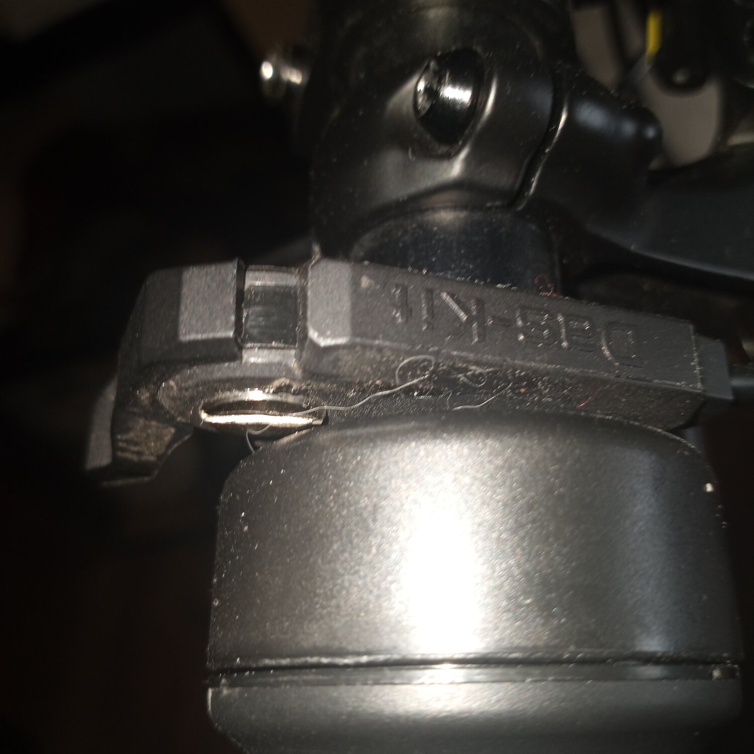

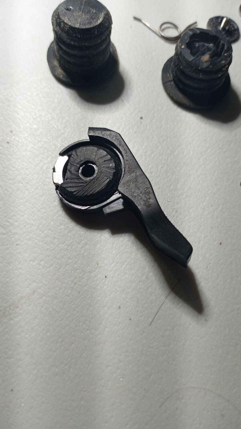

I removed the spring from my thumb throttle and replaced it with a rubber washer.
My thumb throttle now stays where I set it.
It is sticky.
A thumb throttle should be progressive. A twist can fly away from you while walking the bike though a narrow area such as a door. Even with the rubber washer. My bikes measure pedal pressure and amplify that to the extent requested. The accelerator is all in the foot, like a car. Push, Go, regardless of pedaling speed. Try looking at some Schwalbe 26" tires. Quality.

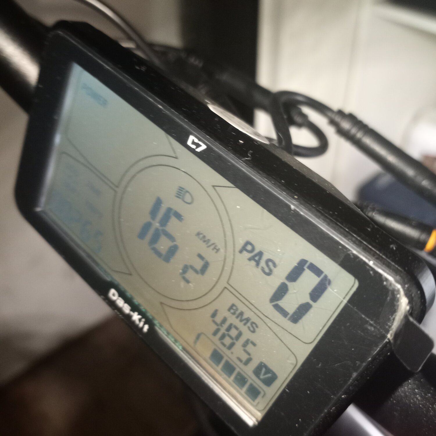

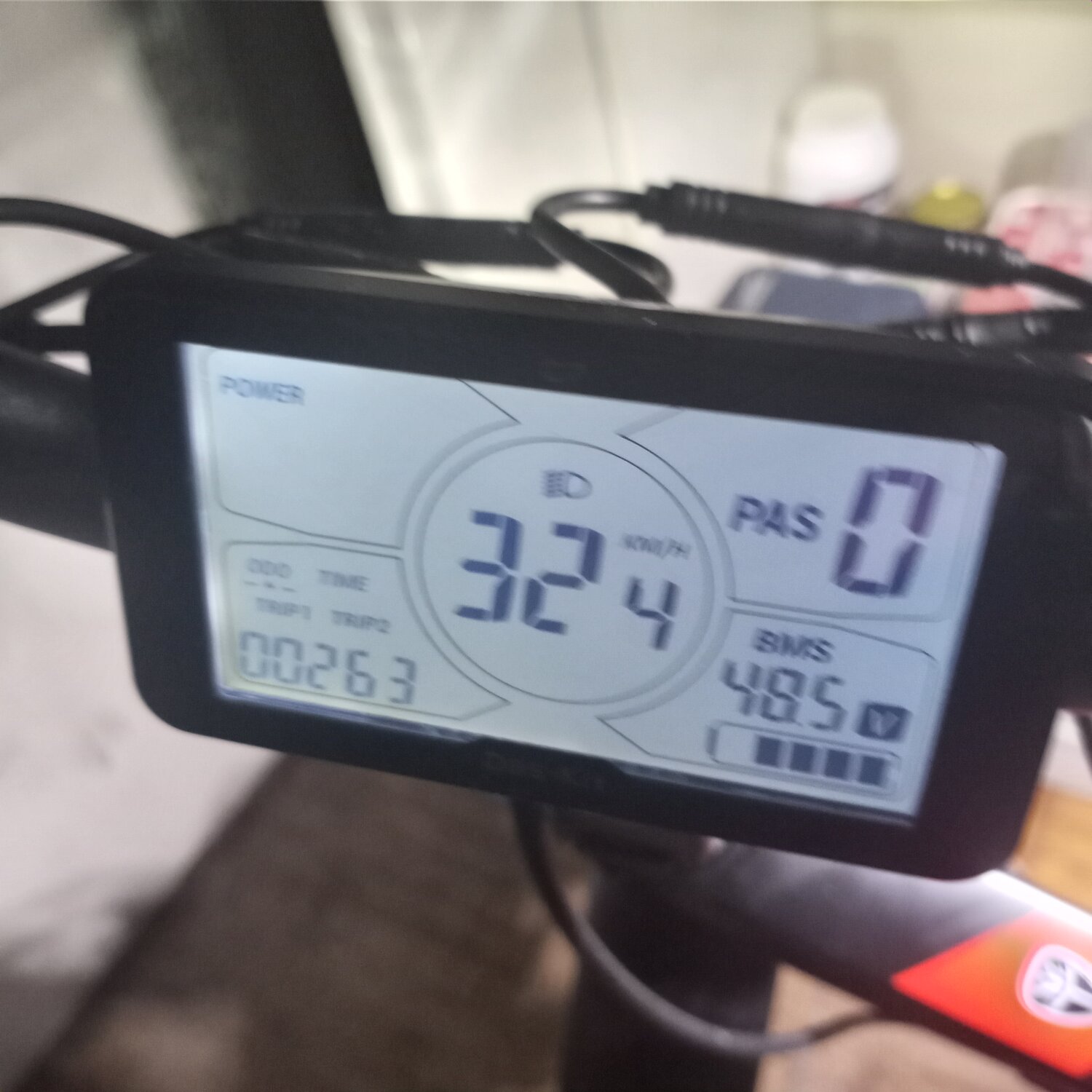

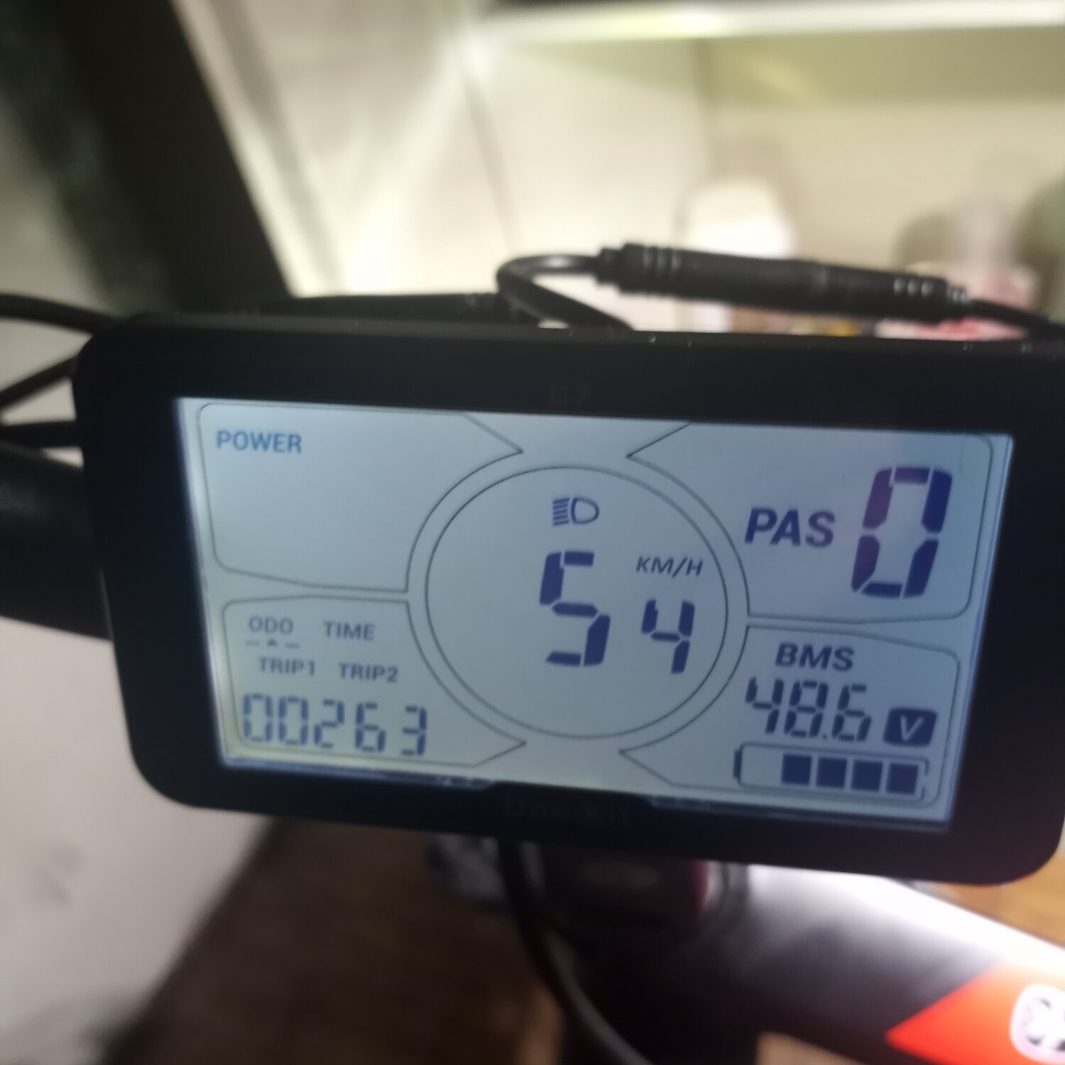

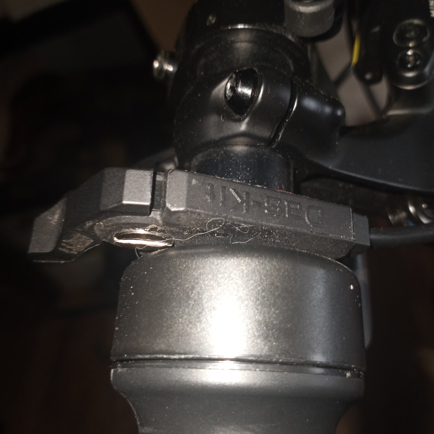

This is the variable thumb throttle just after it activates.
It is set at 5.4 km/hr.
Das-Kit sets speed not power, so the speed is locked in no matter how much you pedal or don't.
This is my sticky throttle at maximum.
32km/hr
This is my throttle at half max.

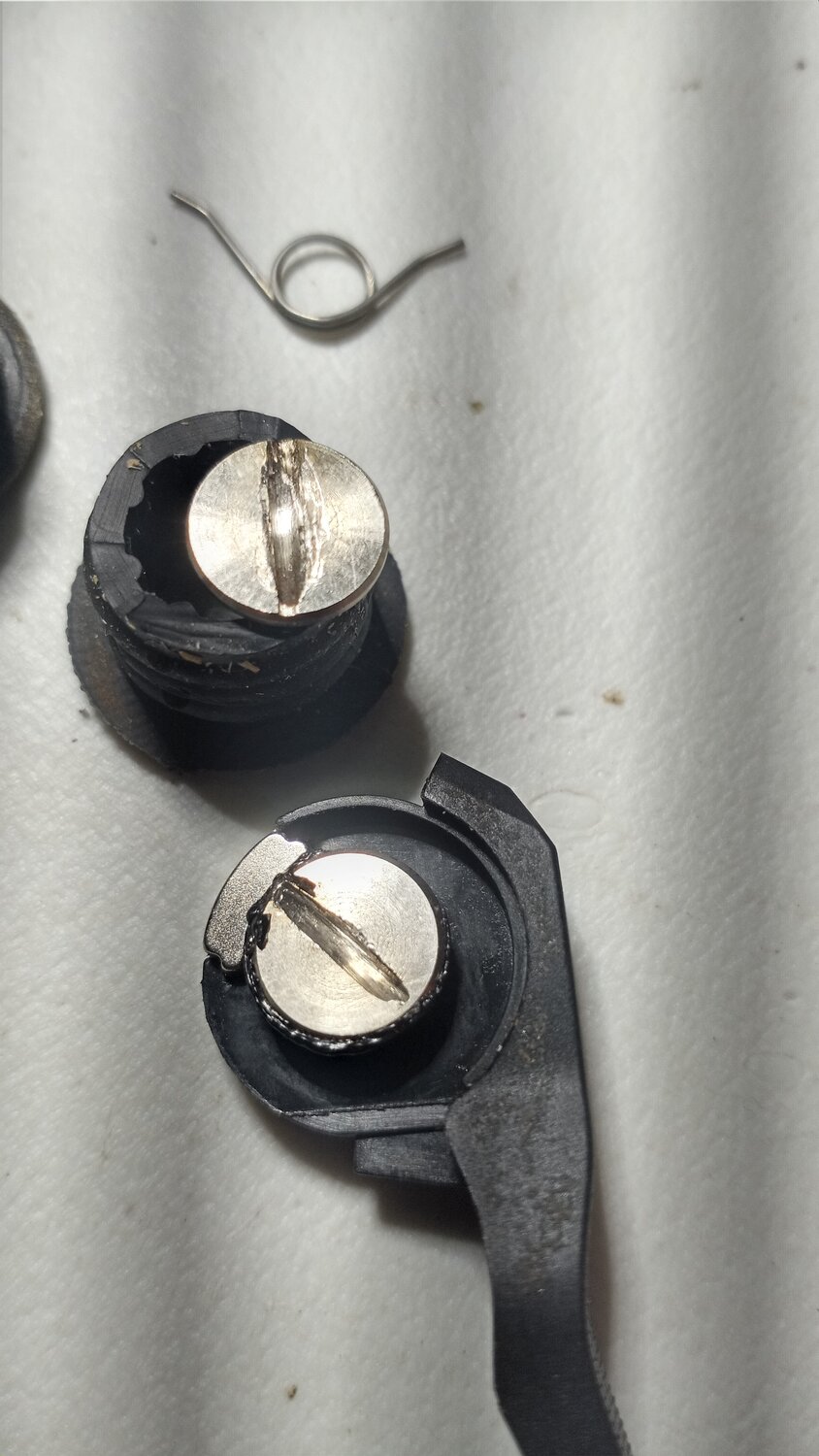

Just delete the throttle.
I delete mine because it's all or none.
I hear that, but what I did was add a secondary throttle.
The sticky throttle sets the speed of my "PAS" to whatever I want.
I only pedal if my current/amp meter is maxed out when I'm going uphill or into the wind.
I can reach over with my thumb and hit the thumb throttle to max, or reach over with my thumb and turn it to zero.
Easy Peasy.
