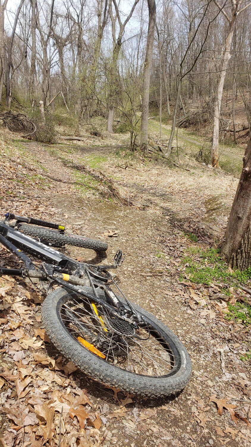

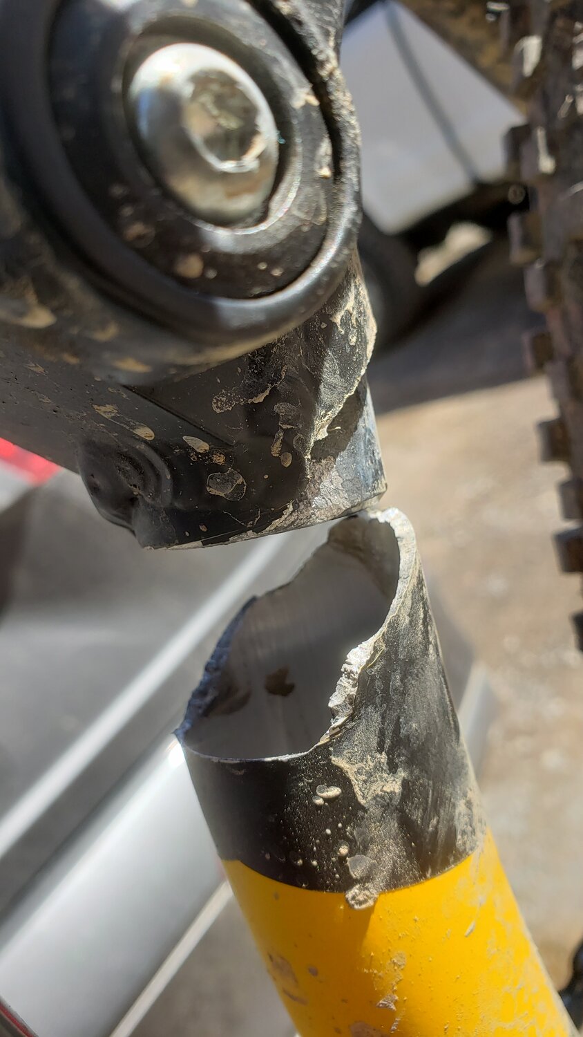

I had my 2018 Enduro frame just break in the same place as others this past week. Seat post was inserted correctly (I am 5'9").
I rode mine on a lot of gnarly, technical single track for 4 years. Not that many miles but probably far beyond what the Chinese made bike was intended for. The bike is just not up to the riding me and my buddies do. Not over the long haul.
Voltbike responded by giving me a very big discount on a new bike. Said they had a new manufacturer. But I ride places that I just can't trust a mediocre bike.
I have 2 Cannondales, both over 20 years old with tons of miles. No frame problems and if a frame broke, they are guaranteed for life. Just a different level of manufacturing and engineering with Cannondale. Our riding group has broken frames - a Schwinn the one time - decades old - and Schwinn replaced it no questions asked.

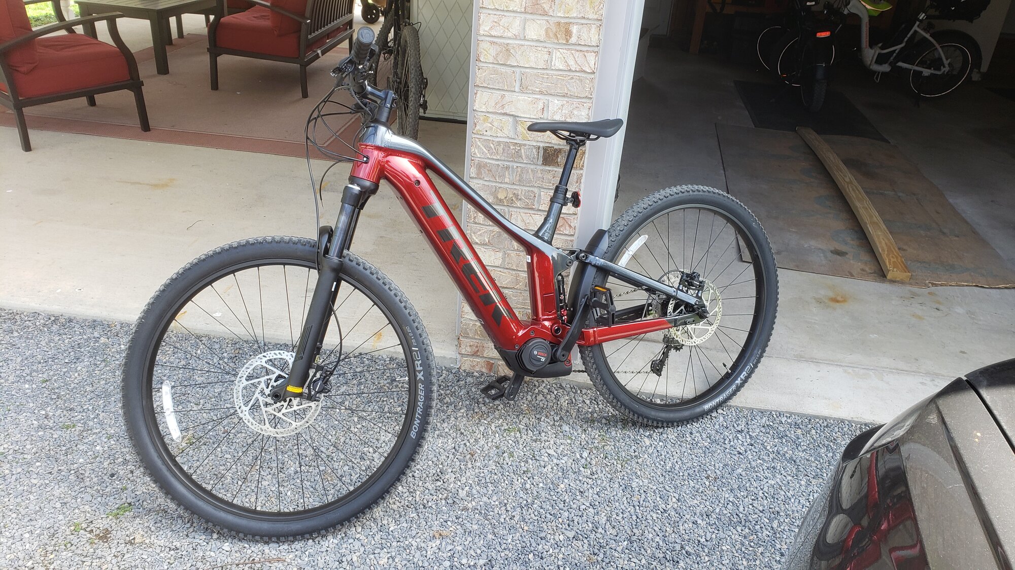

I replaced the Voltbike Enduro with a new Trek Powerfly full suspension emtb bike. Cost literally twice as much as the Voltbike, but you get what you pay for. Every component, every square inch of the Trek is just head and shoulders above the Voltbike. The bike is a dream. Instead of power numbers, it has eco, touring, emtb and turbo. Who doesn't want turbo?
For the money, the Voltbike held it's own and I loved it for 4 years. But there is no substitute for quality on technical singletrack rock trails. And it can't break on a downhill - bad things happen. It is just not made for that. I guess I should have known better.
Attached == happier days during a tea party with the Voltbike, my snapped frame, and my new happy.
