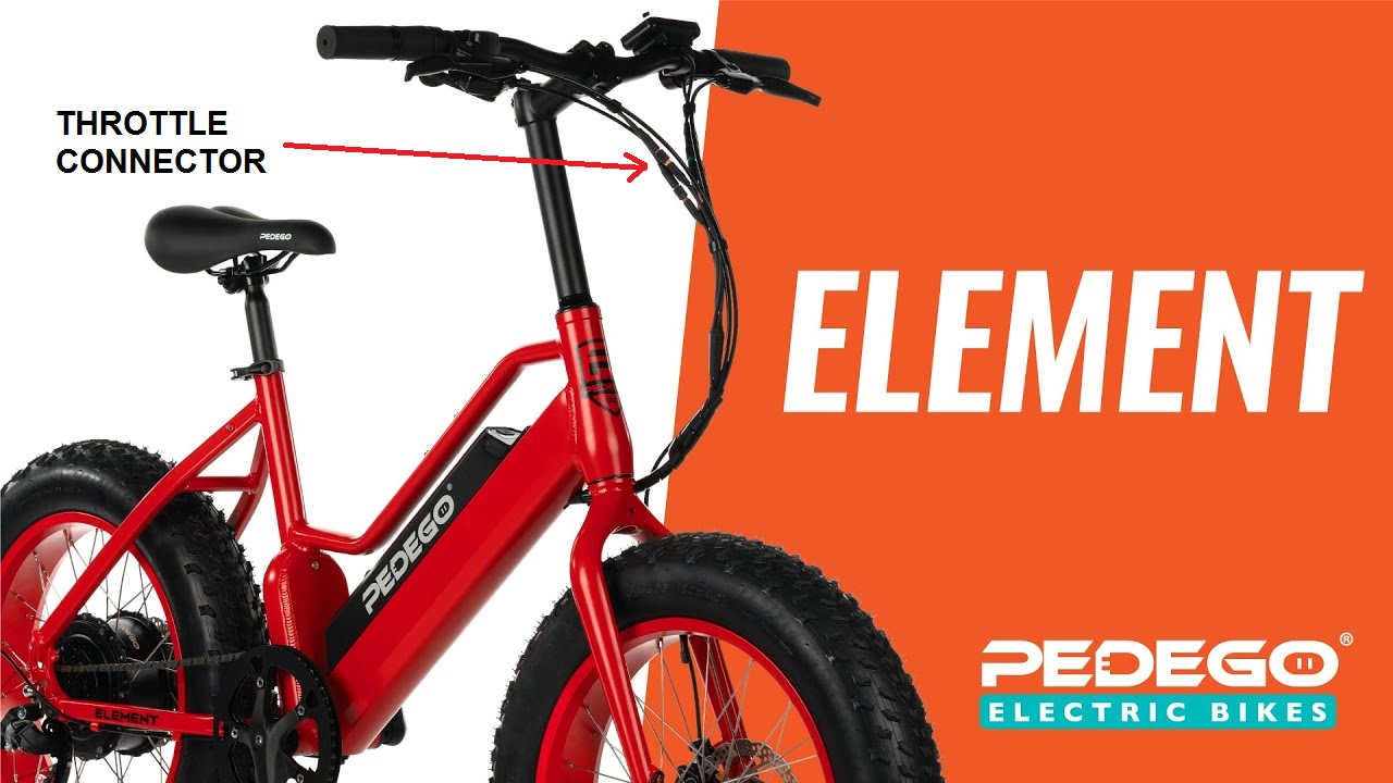

Trace the wire leading from the throttle to the connector in the wiring harness. It should be located approximately here:

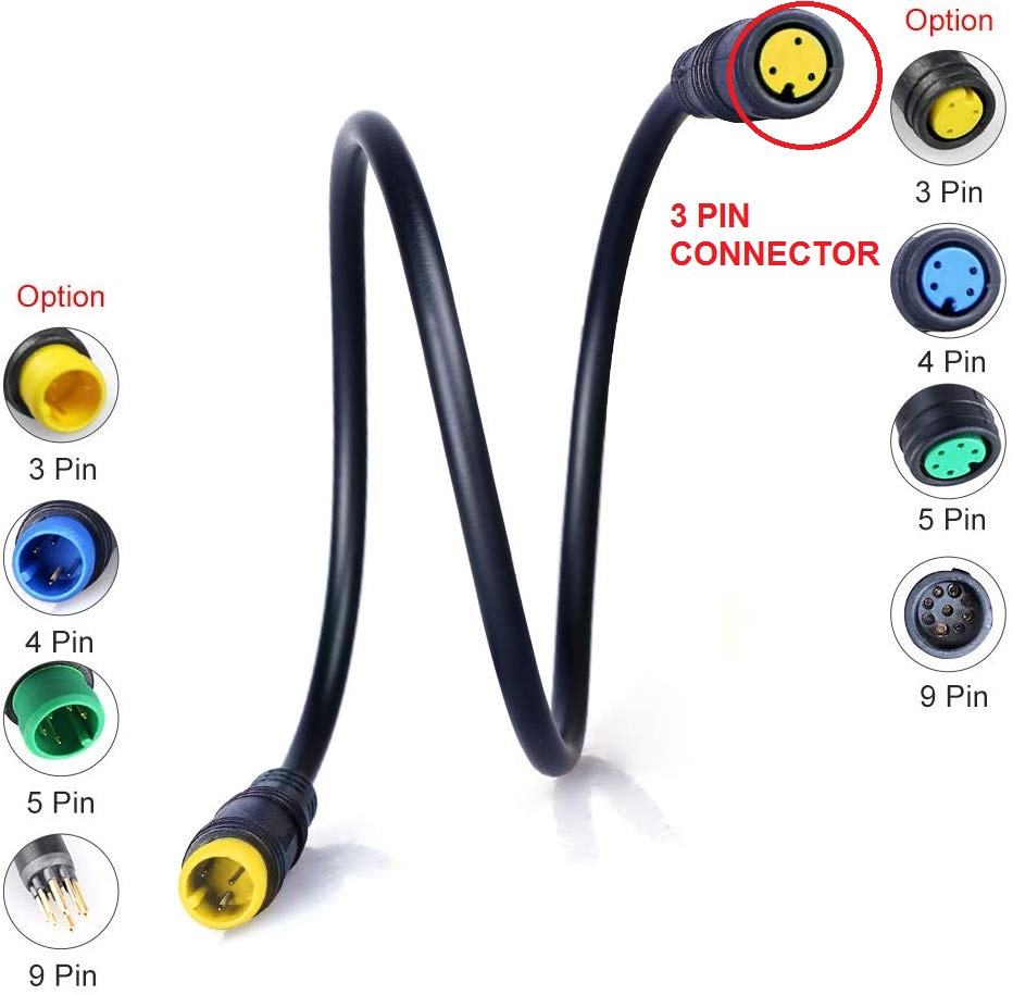

Unscrew it and look at the pin configuration. If it has 3 pins and looks like this:
There is a good chance the half twist throttle from a Pedego Platinum Interceptor will work. The half twist will allow you to use the ergo grips mentioned by @J.R. above in post #2. If the grips you have aren't for a half twists throttle, they won't fit however.
Contact Pedego at 800-646-8604 and press 2 for tech support. They are excellent at helping customers. Ask if the above half twist throttle (or any other unit for that matter) will work on the Element. If so, it's an easy swap. Pedego will deal with you directly so you don't have to go through your dealer. I replaced my Platinum Interceptor throttle last year, it took about 5 minutes and it cost $15.

Ok called Pedego support & they gave me the part number then called to get it shipped from Pedego Canada because the US couldn't ship to me. Canada never answers the phone when I call for support or sales so I called a store that I know is open and hour away from me. They have them in stock so I'll go up & get one later! Let's hope it's nothing weird where somehow the tech guy told me the wrong thing but he knew exactly what I was talking about as soon as I said "I want to replace the grips on my Pedego Element but the right grip...." so let's hope I get up to the shop & look at the throttle connector & it's yellow with the three pins (I've confirmed my current throttle looks like that). Fingers crossed it's correct AND I can get the current grips (the right is easy the left looks harder) off the bike.
Update for anyone that finds this thread in the future trying to solve the same problem....the part number is 52022 for the half twist throttle and it has the same connector just like 6zfshdb mentions in the thread above. If you're American I think it's a $20 part. If you're Canadian, it's a $50 part because that's how it goes in the Great White North. Still worth it to get my Ergon grips on. I have it all set up how I like it now (and blowing compressed air in the end of the grip the left side right off). Attached is a photo (forgive the messy garage in the background). Thanks for all the help especially from 6zfshdb who filled in the details....I was able to get help from this forum so fast that in 24 hours I had implemented the solution (even if I had to drive an hour each way to get the part).
